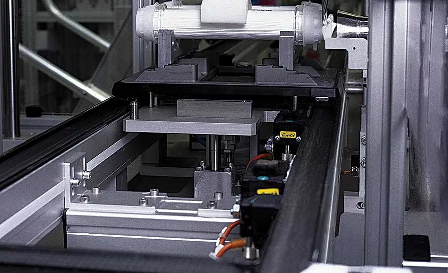

Belt media are ideal for lighter payloads and can transfer materials over long distances at high speeds. Photo courtesy Bosch Rexroth Corp.

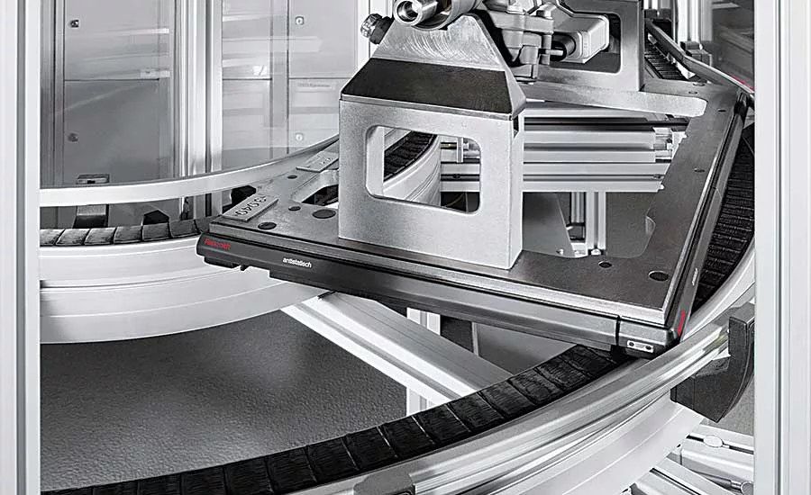

Flat-top chains can support heavy payloads, and their side-flexing design makes them ideal for use with curves and for maintaining leading-edge pallet orientation. Photo courtesy Bosch Rexroth Corp.

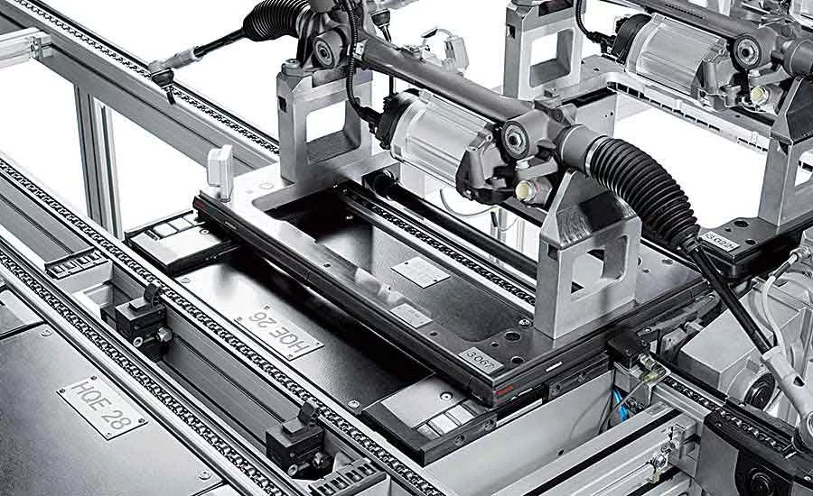

Roller chains can be used in the most challenging environments. The power-and-free design creates a low-friction surface, allowing roller chains to convey heavy payloads. Photo courtesy Bosch Rexroth Corp.

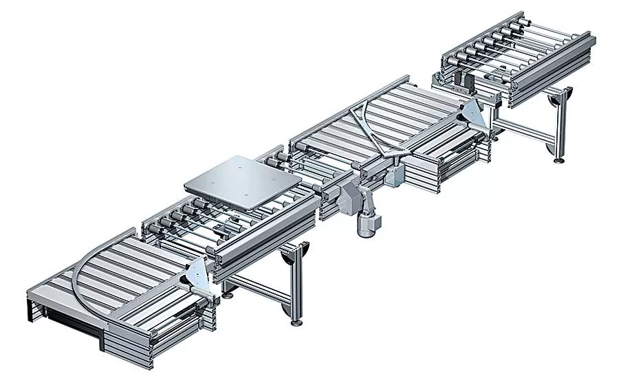

Powered roller conveyors have the highest payload capacities. They’re also very quiet and require little maintenance. Photo courtesy Bosch Rexroth Corp.

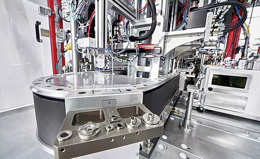

When the conveying requirements include high speed and high positioning accuracy, a relatively new type of conveyor system, based on linear motor technology, can fit the bill. Photo courtesy Bosch Rexroth Corp.

When the conveying requirements include high speed and high positioning accuracy, a relatively new type of conveyor system, based on linear motor technology, can fit the bill. Linear motor-driven pallet conveyors provide extremely fast transport with very good positioning accuracy. They can also be configured to meet stringent clean room or vacuum requirements and can operate with multiple, independently controlled pallets.
While linear motors are often regarded as specialized technology for applications, such as semiconductor and electronics manufacturing, they can also be the perfect fit for more common assembly operations.
In one case, a manufacturer of safety components for vehicles uses Bosch Rexroth’s ActiveMover linear motor-driven conveyor system to move workpiece pallets independently of each other to precisely defined positions. The conveyor is made up of straight sections and 180-degree curve modules, making a closed oval that totals 22 meters. Pallets can travel to each station independently, and sometimes travel to multiple positions within one station. The system can work autonomously for 45 minutes before manual intervention is needed. With the capability to move pallets independently, speeds of up to 150 meters per minute, and accelerations of up to 40 meters per second squared, the ActiveMover pallet conveyor system helped the customer significantly reduce cycle times.

Belt media (flat or toothed) are ideal for lighter payloads and can transfer materials over long distances at high speeds.
Flat-top chains can support heavier payloads, and their side-flexing design makes them ideal for use with curves and for maintaining leading-edge pallet orientation. Flat-top chain caps commonly overlap each other, which makes this media very “fastener-friendly.”
Roller chains are available in many designs (steel, plastic and accelerating) and can be used in the most challenging environments. The power-and-free design creates a low-friction surface, allowing roller chains to convey heavy payloads. Most roller chains are also bidirectional, making them suitable for reversing applications.
Powered roller conveyors generally have the highest payload capacities and offer the most robust conveyance. They’re also very quiet in operation and have low maintenance requirements.
