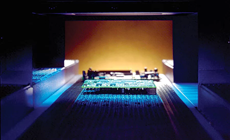

Many options are available for curing conformal coatings. A conveyorized system is ideal for high-throughput operations. Photo courtesy Dymax Corp.

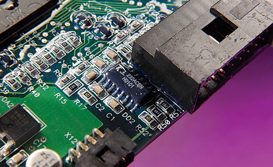

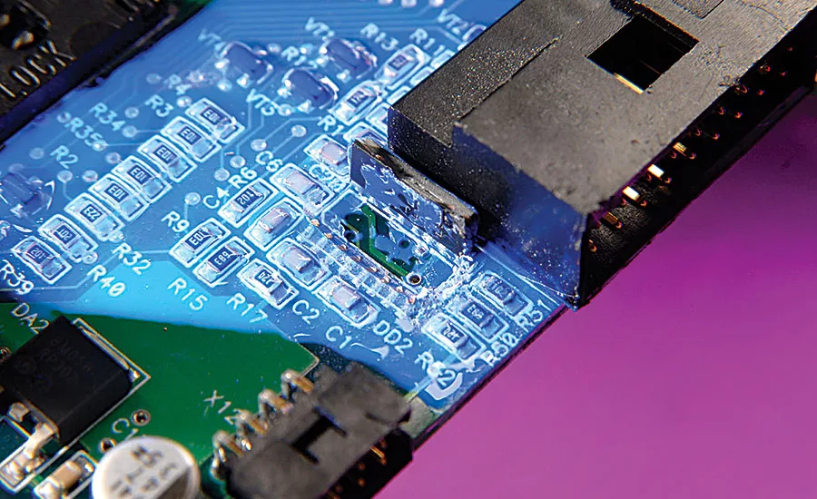

Industry-approved conformal coatings fluoresce when exposed to black light (next). This helps operators see whether the coating has been applied completely and correctly. Photo courtesy Dymax Corp.

Industry-approved conformal coatings fluoresce when exposed to black light. This helps operators see whether the coating has been applied completely and correctly. Photo courtesy Dymax Corp.

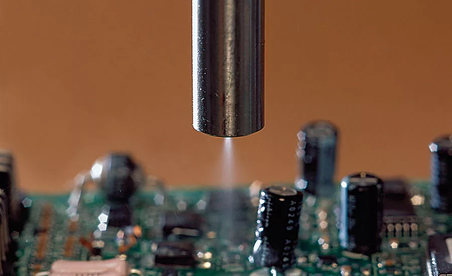

A Cartesian robot equipped with a spray valve can reliably and repeatably apply conformal coatings to PCBs. Photo courtesy Dymax Corp.

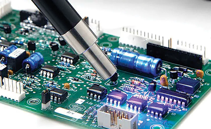

Conformal coatings eliminate the need to create an enclosure to protect sensitive electronics. That saves space and reduces weight. Photo courtesy Dymax Corp.

Automated selective application uses robotics to apply coatings repeatably and reliably to minimize time, material waste and labor costs. The robot can be equipped with either atomizing (spray) or non-atomizing (brushing or jetting) valves. Non-atomized and atomized dispensing processes can also be used in tandem.
Successful automated selective application does depend on the capability of the robot and on the board layout.

Brushing can also be done manually, but it is used more for touch-up work or small areas. Reliability and repeatability depend highly on the operator’s skill.

Inspection is another issue to think about. All industry-approved conformal coatings fluoresce when exposed to black light. This helps operators see whether the coating has been applied completely and correctly. Laser measurement systems are also available to inspect boards for high-reliability applications.

For complete and reliable curing of light-cure materials, it’s important to select a light source with the optimal intensity and spectral output for the photoinitiators in the LCM.
Typically, light-cure conformal coatings absorb light in the UV-A and blue visible-light range. Many light sources are available for curing conformal coatings. The most common curing setups are automated conveyors and benchtop flood systems. Spot systems are available, but are recommended only for rework and for small curing areas. Again, it is important to ensure all parts of the system are compatible with one another.
Light intensity—measured in milliwatts per square centimeter—is the amount of energy at a given wavelength that reaches the coating surface. The amount of total energy that has arrived at a surface over a given time is known as the dose, measured in millijoules per square centimeter. In brief, higher-intensity lamps cure faster, with all other variables held constant, but too much intensity can damage the materials and parts. It is important to use the optimal intensity for the application.
As with any light-cure materials, it is critical to use a radiometer to ensure the light source is continuing to emit at sufficient intensity for complete and reliable curing of the conformal coating.
