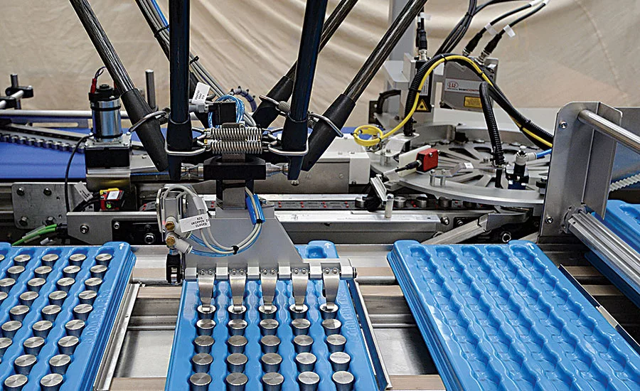

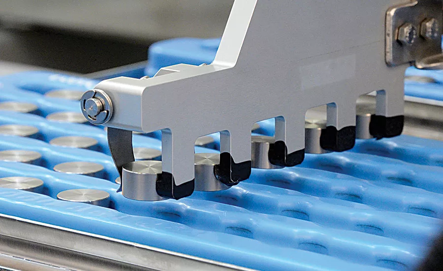

A Delta robot equipped with specially designed tooling lifts five magnetic-material parts at a time and moves them into packaging trays. Photo courtesy GB Innomech Ltd.

An operator inserts a tray of magneticmaterial parts into the automated packaging system. The parts are then indexed on a rotary turntable, and the height of each part is verified with a high-speed laser micrometer. Photo courtesy GB Innomech Ltd.

The system handles two distinct product families, each of which contains multiple variants and requires no manual adjustment. After an operator inserts a tray of more than 100 parts into the system, they are indexed on a rotary turntable, and the height of each part is verified with a high-speed laser micrometer.
Parts within height tolerance (a few microns) are dispensed onto a toothed conveyor belt and moved into large work-in-progress trays. Shortly thereafter, a Codian delta robot equipped with specially designed end-of-arm tooling lifts five parts at a time and moves them into packaging trays that are ready for shipment.
