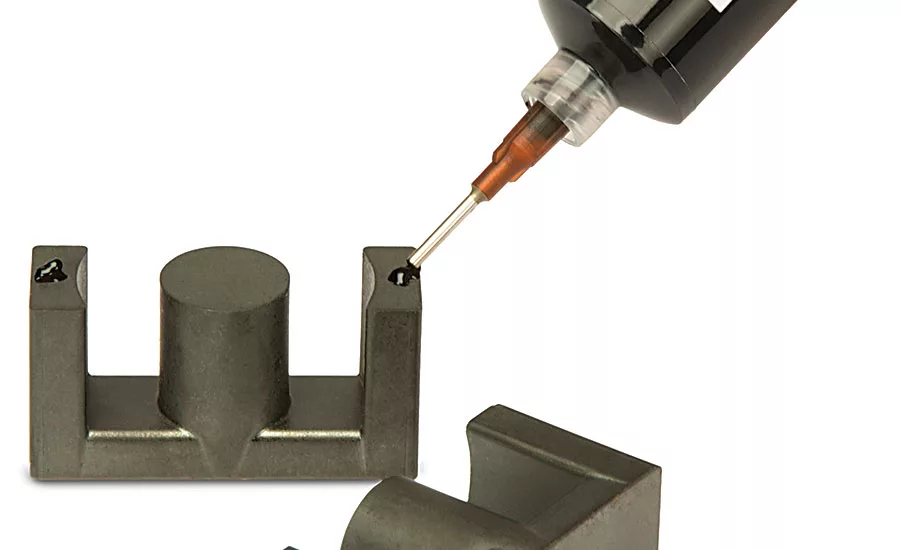

Most adhesives work best when applied in just the right amount to create an optimal bond line. Too much or too little adhesive can produce variable bond strengths. Photo courtesy EpoxySet Inc.

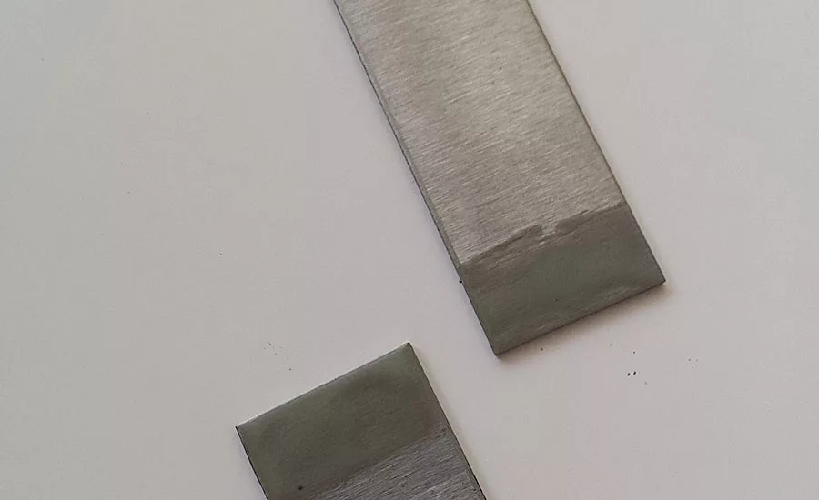

When testing bonded joints, engineers look for cohesive failure, that is, adhesive remaining on both substrates when pulled apart, as shown here. This can be achieved with proper preparation of the substrate surface. Photo courtesy EpoxySet Inc.

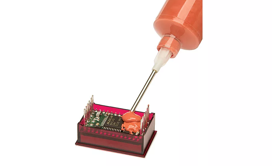

Contamination is the most common cause of bond failures. Grease, oil or other impurities on the surface of the parts can potentially cause loss of adhesion. Photo courtesy EpoxySet Inc.

One of the first considerations should be contamination. Grease, oil or other impurities on the surface can potentially cause loss of adhesion. Dirty substrates are an obvious potential problem, but contamination can be inadvertent. Oils from skin contact, especially on small parts, could be enough to cause a problem. Components may have been improperly cleaned. Component manufacturers sometimes change a production process that does not affect component performance or tolerances, but can unintentionally affect the bonding of that component.
Controlling the cleaning process where the parts are made or used is the best way to ensure that contamination does not cause bonding problems.
Another possible source of contamination is silicone release agents that can settle onto surfaces and prevent adhesion. Care must be taken to prevent cross-contamination when using silicones or any release agent. For this reason, some manufacturing facilities do not allow the use of any silicone compounds.
Surface preparation is essential for bond consistency. There are many methods to prepare surfaces, including washing, abrasion, and plasma or corona treatment. The best surface preparation will depend upon the specific substrate and adhesive chemistry used. Consult with your substrate provider or adhesive manufacturer for the appropriate preparation. Lack of consistent surface preparation can be a big contributor to adhesion issues.

Application technique can be critical. If adhesive is manually applied, ensure that the amount is consistent for each unit. Most adhesives work best when applied in just the right amount to create an optimal bond line. Too much or too little adhesive can produce variable bond strengths. If applicable, make sure that the adhesive is applied in the same location on every component.
If automated dispensing technology is used, ensure that the equipment is clean when starting and remains clean during use. Some adhesives can partially cure in the dispensing apparatus, thus clogging the unit and preventing a consistent amount of material being applied to each part. Less adhesive could result in decreased strength.
