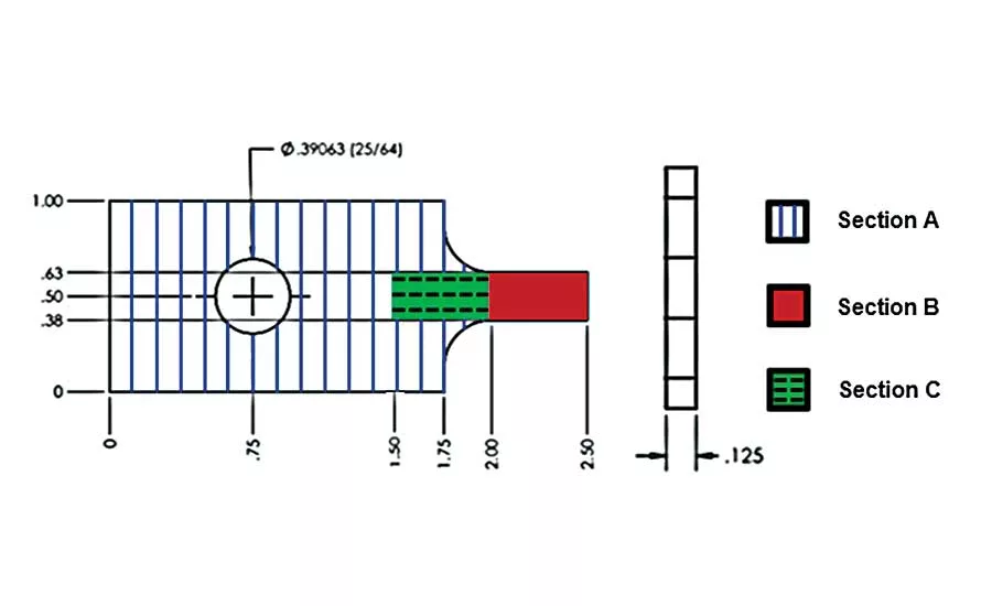

FIGURE 1: To gauge the effectiveness of carbonic cleaning, the authors tested the technology on tab-shaped coupons of aluminum, ABS and stainless steel. The contact area of each coupon (Section B) was sanded using 240 grit sandpaper, except for the ABS coupons, which had an additional contact area (Section C) that was also sanded. GRAPHIC COURTESY RELIABOTICS LLC

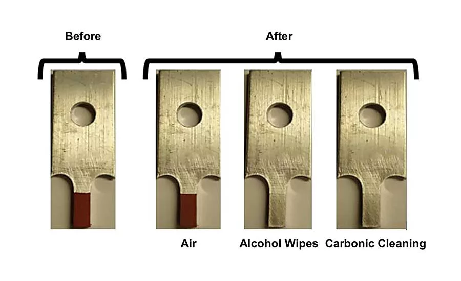

FIGURE 2: These images show the test coupons after contamination with dry chalk (far left) and after cleaning with air (middle left), alcohol wipes (middle right) and after carbonic cleaning (far right). This set of coupons are 6061 aluminum. PHOTOS COURTESY RELIABOTICS LLC

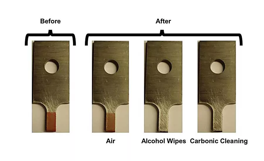

FIGURE 2: These images show the test coupons after contamination with dry chalk (far left) and after cleaning with air (middle left), alcohol wipes (middle right) and after carbonic cleaning (far right). This set is 304 stainless steel. PHOTOS COURTESY RELIABOTICS LLC

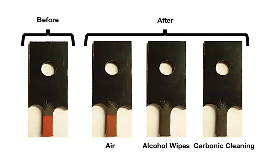

Figure 2: These images show the test coupons after contamination with dry chalk (far left) and after cleaning with air (middle left), alcohol wipes (middle right) and after carbonic cleaning (far right). This set is black ABS. PHOTOS COURTESY RELIABOTICS LLC

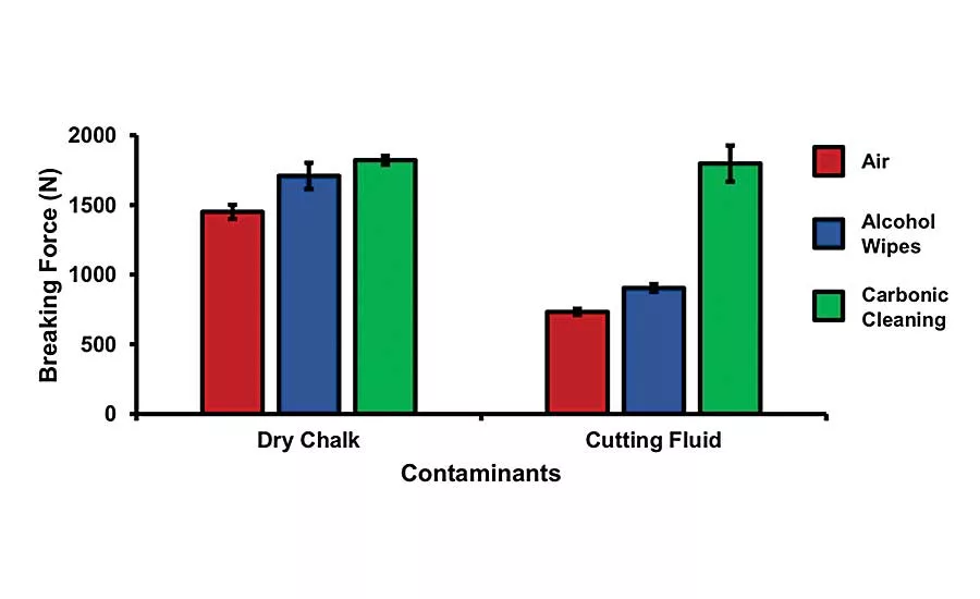

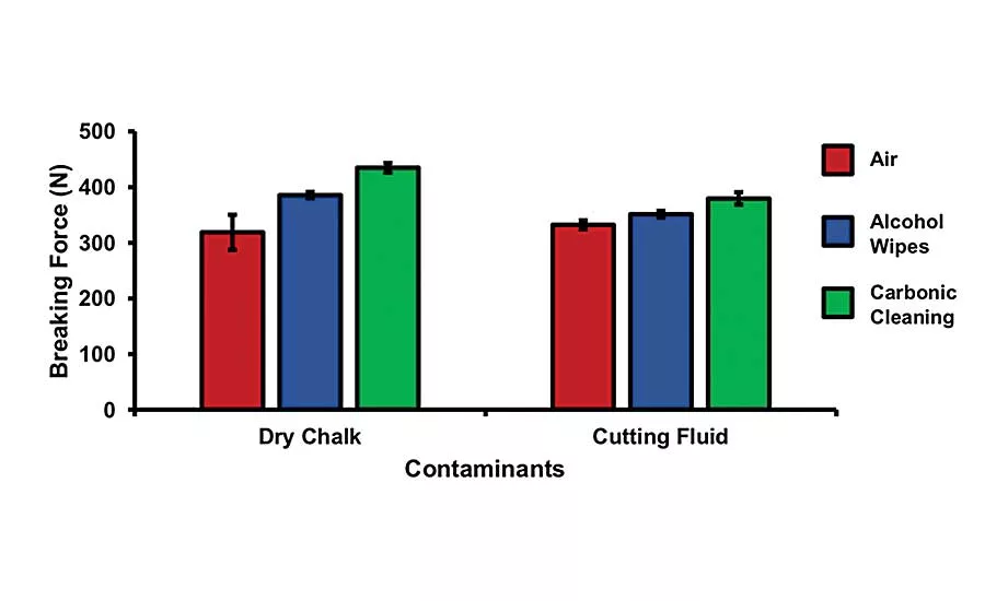

FIGURE 3: Parts treated with carbonic cleaning consistently produced the highest breaking force, regardless of the materials or contaminants used. This graph shows the sheer test results for aluminum to aluminum. SOURCE: RELIABOTICS LLC

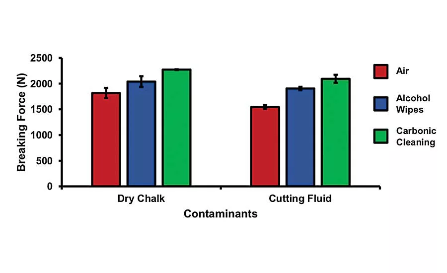

FIGURE 3: Parts treated with carbonic cleaning consistently produced the highest breaking force, regardless of the materials or contaminants used. This graph shows the sheer test results for stainless steel to stainless steel. SOURCE: RELIABOTICS LLC

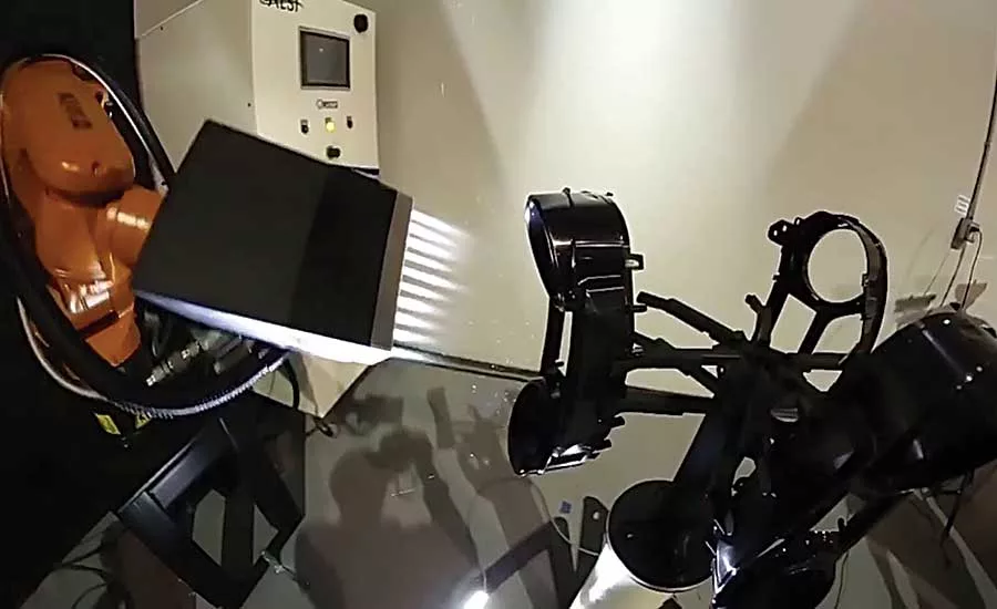

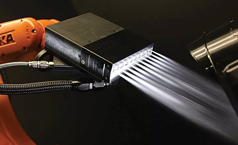

The carbonic cleaning process is easily automated using a six-axis robot.

There are many ways to clean surfaces prior to bonding. One of the newest is carbonic cleaning, which uses tiny particles of CO2 propelled by a temperature-controlled air stream. CO2 is inert, nontoxic and nonflammable, making it a safe and versatile organic solvent. It is also nonaqueous and sublimes on any material it is cleaning, leaving behind only a clean surface.
In carbonic cleaning, compressed liquid CO2 is expelled from an insulated nozzle. Due to the Joule-Thomson effect, the liquid CO2 rapidly changes into a mixture of solid particles and gas, which impact the surface to be cleaned.
The particles are propelled by a heated, compressed air stream. The air stream has two benefits. First, it adds additional kinetic energy to the CO2 particles, which increases their velocity on impact with a material. It also raises the temperature of the particles, which changes their shape into bullet-like particles. The fine points of these bullet particles enable them to easily transfer kinetic energy to the substrate.
Momentum transfer isn’t the only mechanism involved in carbonic cleaning. Thermal strains caused by the temperature of the CO2 also play a role, since CO2 stays solid for temperatures up to -78.5 C. And, the CO2 itself acts as a solvent, particularly for hydrocarbon contaminants.

To gauge the effectiveness of carbonic cleaning, we tested the technology on tab-shaped coupons of 6061 aluminum, black ABS and 304 stainless steel. The coupons were 1 inch wide, 2.5 inches long and 0.125 inch thick (see figure 1). The contact area of each coupon (Section B) was sanded using 240 grit aluminum oxide sandpaper for all materials except for 36 of the ABS coupons, which had an additional contact area (Section C) that was also sanded.
A calibrator was used to mark 0.5 inch from the bottom of each material. This allowed all coupons to have a consistent 0.5 inch by 0.25 inch surface area to apply epoxy to and bond to one another. For the 36 ABS coupons that had Section C sanded, a calibrator was used to mark 1 inch from the bottom in addition to the 0.5 inch mark, so these coupons had both Section B and Section C clearly marked.
In our experiment, we bonded aluminum to aluminum, stainless steel to stainless steel, ABS to ABS, aluminum to stainless steel, aluminum to ABS, and stainless steel to ABS. Eighteen assemblies of each material combination were produced.

After pretreatment with air, alcohol wipes and carbonic cleaning, chalk contaminants were visibly reduced for all pretreatments on all surfaces. However, only alcohol wipes and carbonic cleaning visibly removed most of the contaminants from the surface. Air left behind most of the chalk. Figure 2 shows chalk contaminants on each material before and after cleaning.
The results indicate that when coupons were cleaned with CO2, more force was needed to break apart the two coupons than when materials were cleaned with air or alcohol for all materials and contaminants. Alcohol wipes recorded the second most force to break apart the coupons for all dry chalk and cutting fluid contaminants. Parts contaminated with cutting fluid took less force to break apart than those contaminated with chalk for all materials and surface pretreatments, except for air on ABS to ABS assemblies.
Parts treated with carbonic cleaning consistently had the highest breaking force, regardless of the materials or contaminants used. (See Figure 3.) This indicates that after carbonic cleaning, common materials in industry such as 6061 aluminum, black ABS and 304 stainless steel form stronger bonds when using epoxy compared to traditional cleaning methods, such as compressed air and alcohol wiping.

Cleaning with air left the most contaminants after cleaning, and this was reflected in the results. For all material combinations, coupons cleaned with air required 32 percent less force to break apart for dust-contaminated parts and 74.9 percent less force to break apart for oil-contaminated parts, compared with coupons treated with carbonic cleaning.
Cleaning with alcohol wipes was slightly better. For all material combinations, coupons cleaned with alcohol wipes required 14.1 percent less force to break apart for dust-contaminated parts and 41.9 percent less force to break apart for oil-contaminated parts, compared with coupons treated with carbonic cleaning.
The contaminant affected the breaking force required for all materials and pretreatments. Removing cutting fluid resulted in a much lower breaking force than chalk for all materials when they were cleaned with air or alcohol wipes, but only a small decrease in breaking force when they were pretreated with carbonic cleaning. The breaking force decreased 45.1 percent for parts cleaned with air and 36.9 percent for parts cleaned with alcohol when the contaminant changed from chalk to cutting fluid for all experiments. However, the breaking force for carbonic cleaning only decreased by 10.1 percent when the contaminant changed from chalk to cutting fluid for all experiments.
