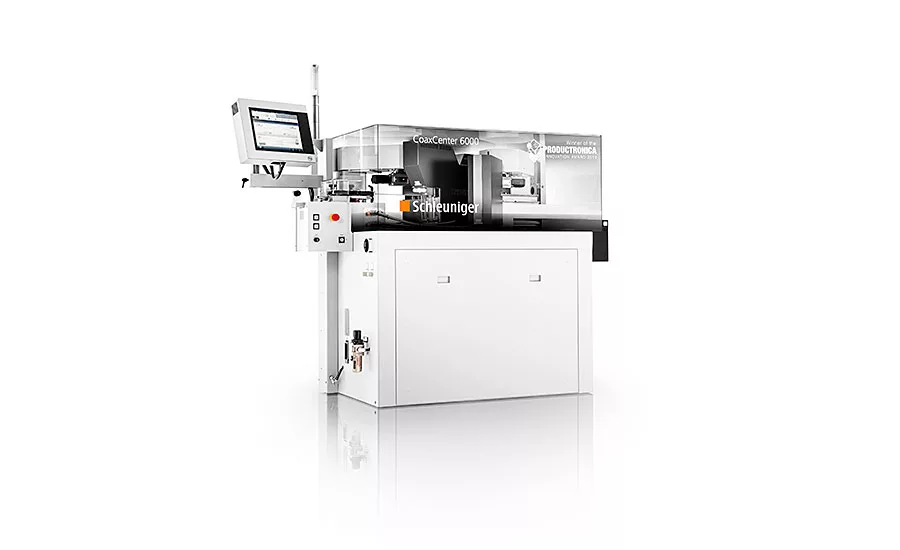

Fully automatic cutting, stripping and crimping machines like this one are required for processing ultra-miniature RF cables in high-volume operations. Photo courtesy Schleuniger Inc.

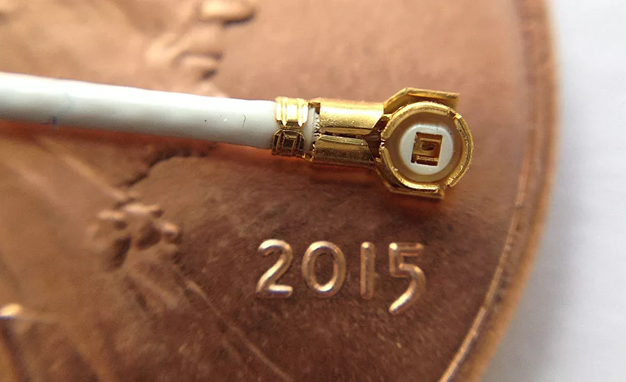

Ultra-miniature RF cable assemblies are now common in mobile electronics. These cables connect tiny antennas to the circuit board. Photo courtesy Schleuniger Inc.

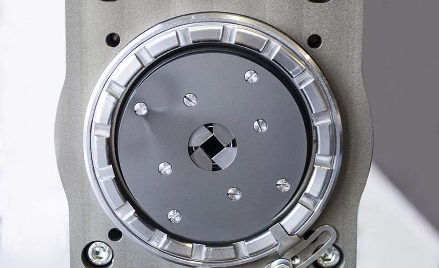

The rotary stripper on the CoaxCenter 6000 can handle cables ranging from 40 AWG to 5.5 millimeters in diameter. Photo courtesy Schleuniger Inc.

To meet these performance requirements, ultra-miniature radio frequency (RF) cable assemblies are now common in mobile devices. These cable assemblies connect tiny antennas to the circuit board inside mobile electronic devices. The connectors for these cable assemblies must have a very low mating height, so as not to increase the thickness of the device. In addition, to permit serviceability, the connectors need to attach and detach easily from the board.
One of the smallest connectors currently in use has a mating height of only 1.2 millimeters! These tiny RF connectors are typically interfaced with a 36 AWG micro-coaxial cable with an outer diameter of 0.81 millimeter. Smaller connectors with even smaller micro-coaxial cables are already in development and will likely become the new standard soon.

The CoaxCenter 6000 is a fully automatic machine for processing micro-coaxial and coaxial cables, as well as single-conductor wires.
The machine has a unique, rotary stripping unit that precisely cuts and strips each cable layer. A centering device, consisting of six segments, ensures that the cable is kept in its optimum position during the incision without being damaged by the clamping pressure. Stripped parts are removed by a powerful extraction.
The machine’s rotary stripper can handle cables ranging from 40 AWG to 5.5 millimeters in diameter. Depending on the diameter and stiffness of the cable, the machine can cut cable lengths as long as 1,000 millimeters. (Longer cable lengths are possible with an optional active wire stacker.) Minimum cable length is 15 millimeters, excluding the stripped portion of the cable.
The machine can process both ends of the cable simultaneously. Maximum strip length on either side is 26 millimeters. Minimum strip length is 0.1 millimeter. Strip lengths are accurate to ±50 microns, depending on the cable type. The machine can process a variety of insulation, including Kapton, polyurethane, PVC, rubber, Teflon and Tefzel.
When programmed to produce a 100-millimeter long cable with a three-step stripping process on both ends, the machine can produce 1,200 pieces in an hour.
The CoaxCenter 6000 can be equipped with a variety of additional processing equipment, including a vision system, crimping press, tinning station, wire straightener, prefeeder and signal tower.
After cutting the cable, the machine holds the cable end with a single gripper for all subsequent processing. The cable is not transferred from one gripper to another. As a result, the cable retains its exact position and is fed to each station with maximum positional accuracy.
After all process steps have been carried out, the gripper sets the cable down without damaging the ends.
The vision system, QCam 360, automatically monitors stripping quality, eliminating the need for time-consuming manual measurements following production. Measurements are accurate to ±10 microns. The vision system can also be used to check the quality of the crimping process, such as determining if the terminal is seated correctly on the cable end. For traceability purposes, all production data, including 3D images of each cable, are recorded.
