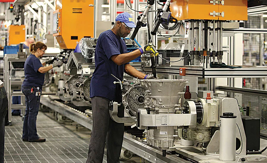

Changeover is an important component of any lean manufacturing initiative. Photo courtesy ZF Friedrichshafen AG

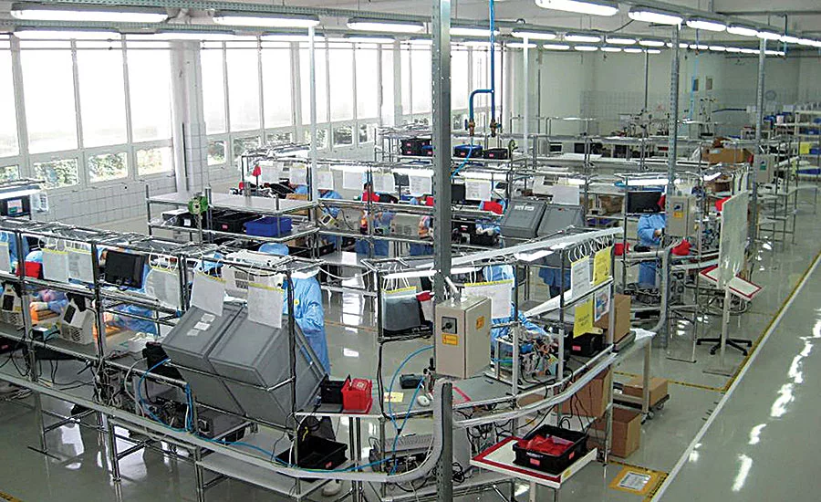

Changeover is critical in high-mix production environments, such as this battery pack assembly line. Photo courtesy Videoton Holding

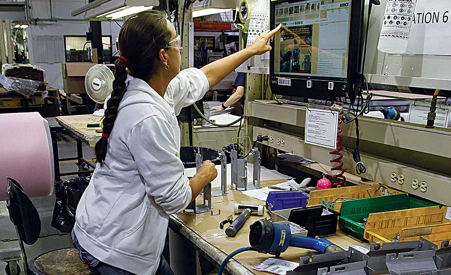

Operators have to make psychological adjustments each time they start to assemble a different product. Photo courtesy Visual Knowledge Share Ltd.

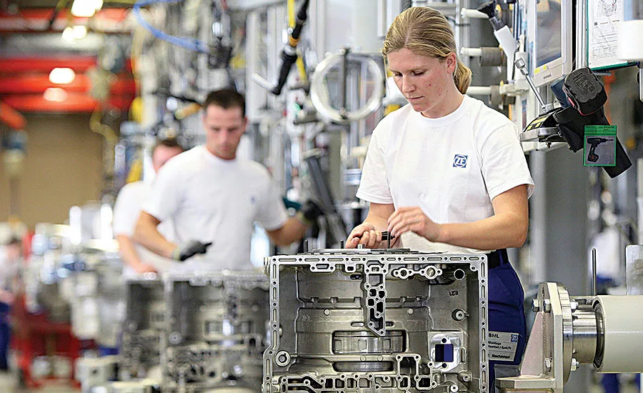

Although the terms changeover and setup are often used interchangeably, they mean different things. Photo courtesy ZF Friedrichshafen AG

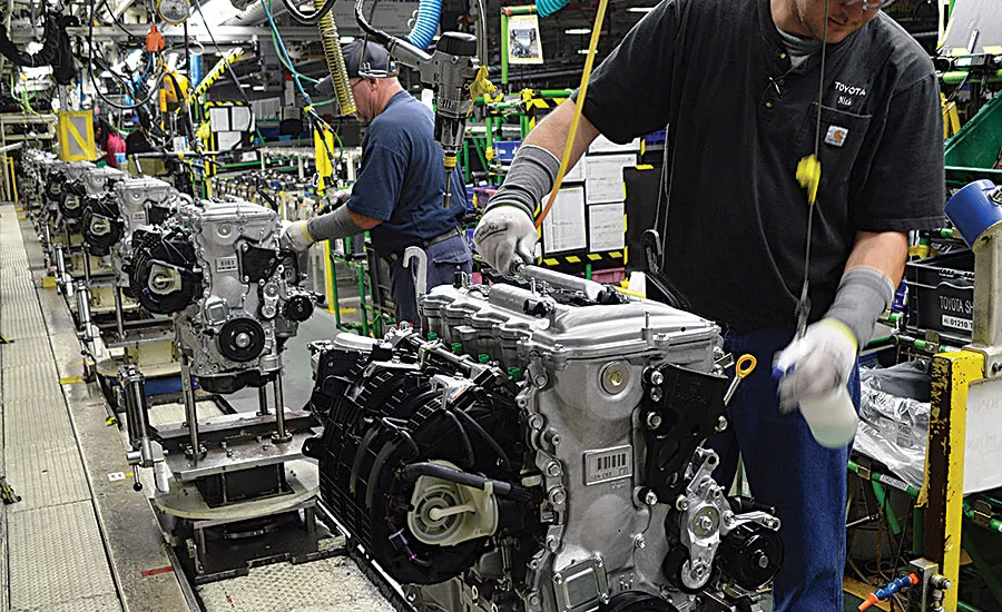

Part counts and assembly complexity can make the changeover process easier or more difficult. Photo courtesy Toyota Motor Corp.

Changeover also is an important component of lean manufacturing initiatives. But, in today’s high-mix production environment, it can create numerous challenges for engineers.
“The higher the mix, the more important changeover is,” notes Sammy Obara, president of Honsha Associates. “The complexity depends more on the process itself—factors such as number of internal steps, stabilization and validation—and not on the fact it is a high or low mix.”
Changeover is defined as the time it takes from the last accepted part being produced of one item to the first accepted part being produced of a different item. This includes disassembling the previous equipment and tooling setups, configuring any new setups, staging and verifying the materials required for the new item, adjusting any settings to their new required values, beginning production, and dialing in the first good part.
“In a simple sense, it is the time and activities spent from last good part to the next good part when an order change of some type occurs,” says Art Smalley, president of the Art of Lean Inc. and a former Toyota Motor Corp. engineer. “However, it is not always as straightforward as one might think.
“The hallmark of a lean changeover is one that is safe, simple and efficient,” claims Smalley. “If it is hard, dangerous or difficult, that’s a sign there is waste, inefficiency and overburden in the process that needs to be examined.
“Ideally, it helps improve flow and reduce downtime,” explains Smalley. “When changeover time is small and approaches zero, then you can level production (heijunka) more easily. That is true for the assembly line or a batch asset.”
Some manufacturers use the terms “changeover” and “setup” interchangeably. Typically, industries with large-scale equipment that runs more or less continuously tend to use changeover, while batch industries, such as job shops, tend to use setup. Most experts recommend using the term changeover when talking about switching between products and setup when referring to a machine or process.
“Changeover refers to the process of preparing [assembly lines] to produce a particular item,” says Quarterman Lee, president of Strategos Inc., and a former engineer at Boeing and Ford Motor Co. “Generally, it means switching from one item to another.
“I like to define it as the time required for this switching or preparation measured from the last item produced for the previous part number until the first acceptable subsequent part number is ready to start the operation,” explains Lee. “This will include any shutdown time for the previous part number; preparation of tooling; change out of raw material or component stocks; exchange of tooling; adjustments or fine tuning; trial runs; and quality checks, such as first-piece inspection.”

Today’s high-mix production world is putting extra pressure on engineers to address changeover. In fact, it’s now more important than ever.
“The demand for changeovers has increased, but so have the awareness, techniques, tools and capabilities necessary to meet the challenge,” says Bell. “The single biggest impediment remains the traditional cost accounting mindset that incentivizes long runs and extended overseas supply chains over flexibility and vertical integration.”
“The higher the mix, the more important changeover is,” notes Sammy Obara, president of Honsha Associates. Obara spent three years studying lean manufacturing principles in Toyota City, Japan, and another 10 years applying it at Toyota assembly plants in Brazil, Venezuela and the United States.
“The complexity depends more on the process itself—factors such as number of internal steps, stabilization and validation—and not on the fact it is a high or low mix,” Obara points out. “That said, for high-mix production, you have to pay added attention to external steps.
“For example, you have a very short production time until you have to change to product B, then again, a short production time until you start product C,” adds Obara. “This means that during these short moments of production, you must prepare all the external steps for the next changeover. This requires good common sense and experience.”
Changeover isn’t always more difficult in high-mix production environments. But, depending on the number of different parts involved and the assembly complexity that’s required, it  may take more time and thought to develop a system.
According to Smalley, high-mix assembly lines don’t necessarily make the changeover process more difficult. “What is changing is the frequency of the requirement,” he explains. “If we only make black Model Ts, then changeover is pretty simple.
“However, as you try to create more options or flavors for the customer, that increases the quantity of changeover work that has to be performed,” notes Smalley. “That requires careful thought in design of the product, process and production scheduling system, just to name a few things.”
