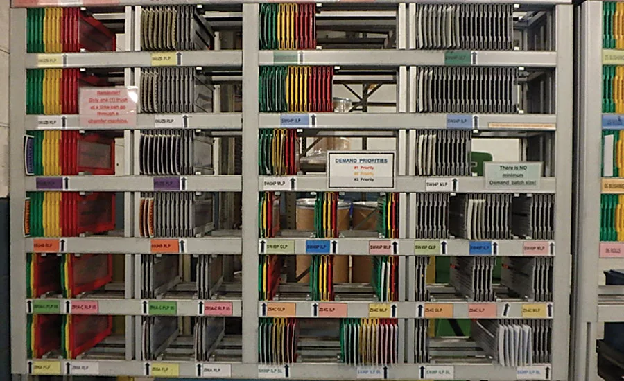

Custom kanban and heijunka boxes can improve flexible assembly applications. Photo courtesy U.S. Tsubaki Automotive and Lean Factory America LLC

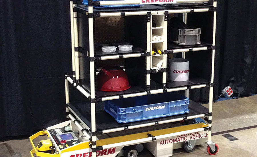

AGV-driven kit carts are a common sight on many mixed-model assembly lines. Photo courtesy Creform Corp.

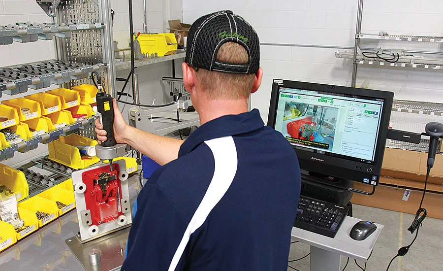

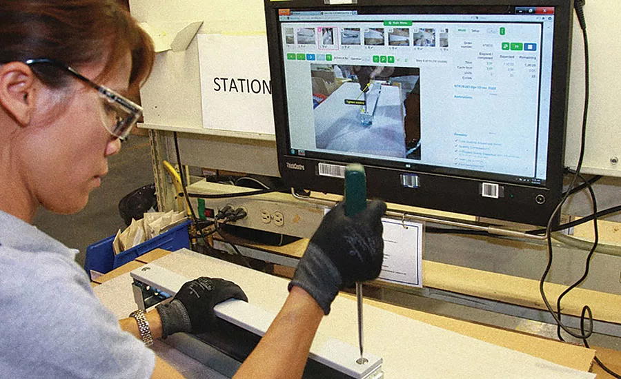

Visual work instructions play an important role in mixed-model assembly lines. Photo courtesy Visual Knowledge Share Ltd.

“Heijunka is the least familiar, but most important lean component in a flexible assembly system,” claims Greissinger. “It is used at the variant-defining step in the process to help level the line and ensure the right products are produced at the right time.
“Professionally produced heijunka boards include highly engineered kanban card boxes, a sliding time marker to show progress throughout the period, and lettering clips to label the time axes and products to be produced,” says Greissinger.
“Heijunka is intended to help overcome imbalances, and level loading is a necessary discipline, but a mixed-model line will never be highly balanced,” warns Rahn. “Flexing can go a long way to overcoming this. It’s a practice that is universally ignored, but could make a huge difference in productivity.

“Material delivery carts and mini-tuggers allow for frequent delivery and exchange of parts,” adds Greissinger. “From a physical infrastructure standpoint, mixed-model assembly lines have very few tools or machines dedicated to just one product.”

“Visual work instructions must have quality information embedded in them to ensure flow,” says Kevin Duggan, president of Duggan Associates. “That’s critical on assembly lines where there’s constant changeover or where there are new employees.”
“Clear, precise work instructions will ensure that processes and controls are carried out each and every time,” adds Kyle O’Reilly, sales and marketing manager at Visual Knowledge Share Ltd. “The biggest benefit is your production line knowing exactly what to do and when to do it. Your line will be as flexible as the fickle trends that drive manufacturing today.”
