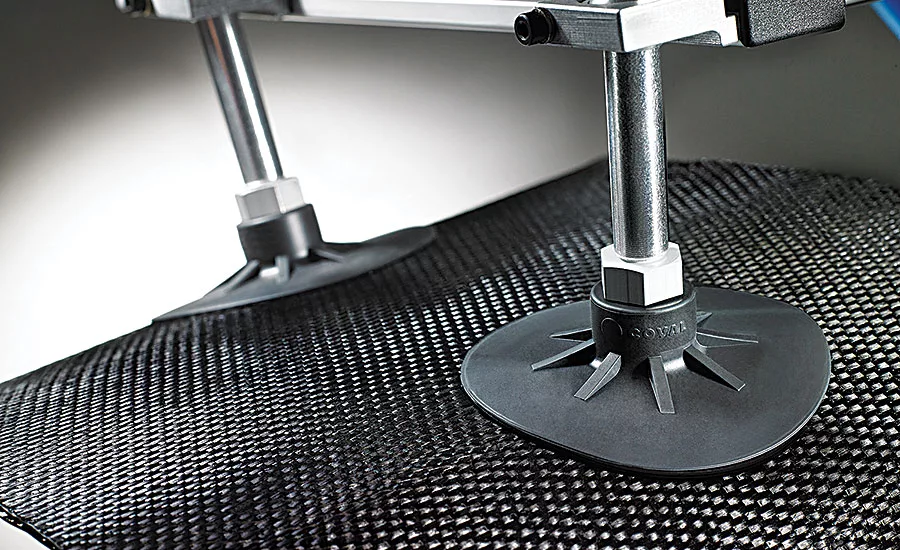

Vacuum grippers work best on parts with a flat, clean surface and a surface area at least equal to the pressed, cross-sectional area of the gripper. Photo courtesy Coval Vacuum Technology Inc.

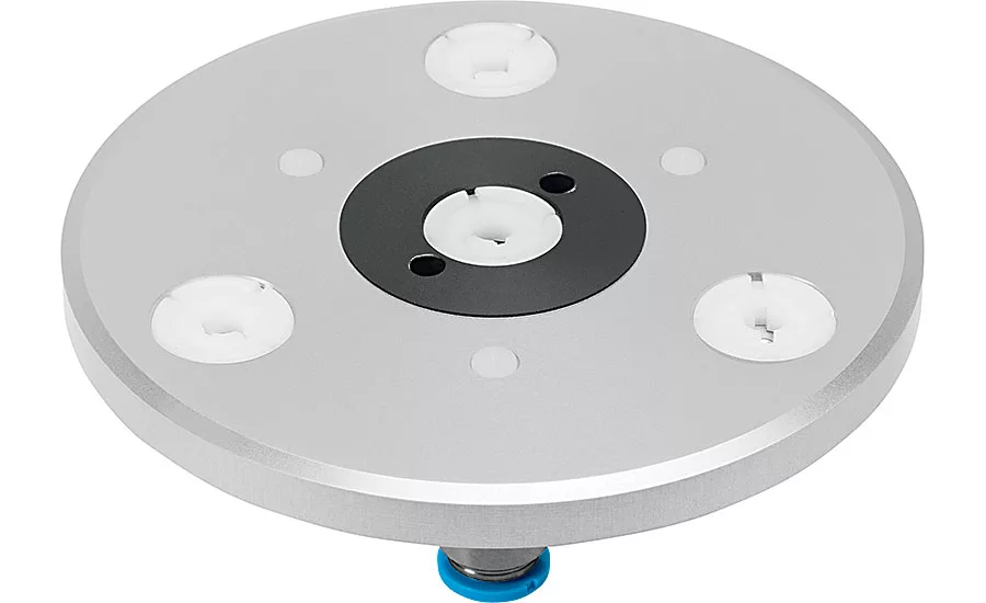

Bernoulli grippers lift and transport objects with minimal contact. The OGGB series cup produces a holding force of 7 to 10 newtons and can be mounted in any position. Photo courtesy Festo Corp.

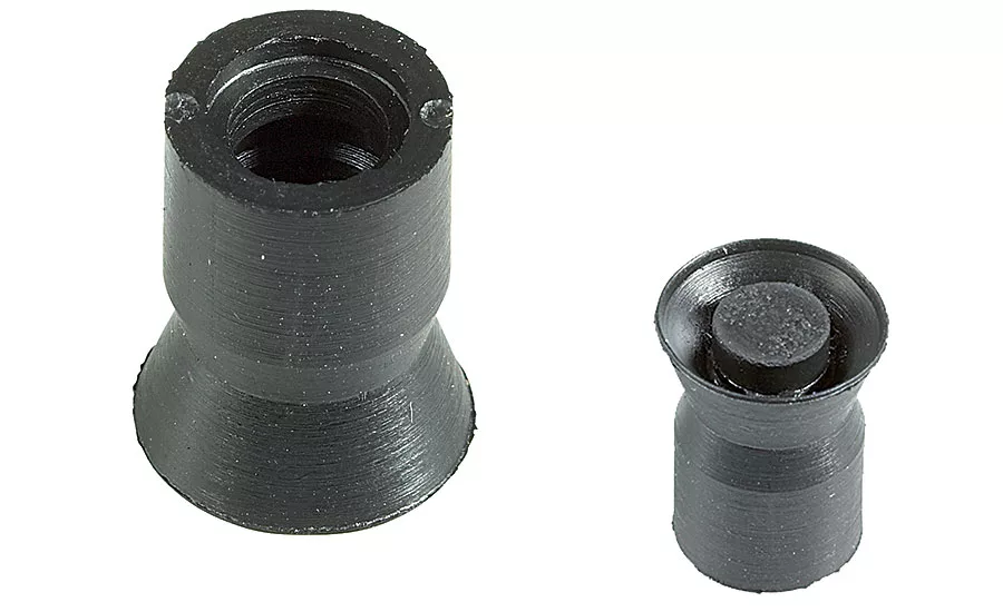

The SR/SK Torus vacuum cup features an inner core that creates suction on objects with perforated surfaces. Photo courtesy Zimmer Group US

A vacuum gripper is the simplest, cheapest and most common device for manipulating smooth, lightweight parts made of plastic, metal or composites. It works best on parts with a flat, clean surface and a surface area at least equal to the pressed, cross-sectional area of the gripper. Usually, the vacuum gripper grabs a part perpendicular to its surface, although ball-joint-type grippers are available for grabbing parts at various angles. A level compensator can be used to help the gripper balance objects with different levels and absorb shocks during part transport.

The SR/SK Torus vacuum cup from Zimmer Group features an inner core that creates suction on objects with perforated surfaces. Russell Tyler, regional sales manager at Zimmer Group US, says the cup can be used on parts with flat, slightly curved and open surfaces, so long as the perforation diameter is no greater than 70 percent of the core diameter (6 to 25 millimeters, depending on cup model).

Also popular are Bernoulli grippers that lift and transport objects with minimal contact. Incoming compressed air is deflected radially in the gripper and flows back out between the workpiece and gripper surface. The air is routed through a very thin gap between the gripper body and core to greatly accelerate its speed and generate a vacuum between the gripper and part.
Festo’s OGGB Bernoulli gripper comes in diameters of 60, 100 and 140 millimeters. It has an operating pressure of 0 to 6 bar, produces a holding force of 7 to 10 newtons, consumes 111 liters of air per minute and can be mounted in any position. The cup handles solar cells and wafers, flat panels, thin glass panes, PCBs, flexible parts with large surface areas, and thin and porous materials.
