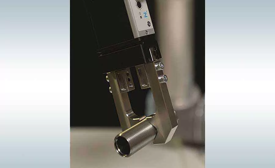

Small parts, especially cylindrical ones, can vary in weight and shape, making it even more difficult for a gripper or cup to establish proper grip. Photo courtesy Zimmer Group

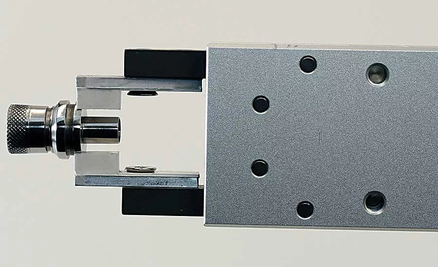

These custom gripper fingers are made of white non-castable silicone bonded to aluminum or steel. The fingers measure up to 0.125 inch wide by 3 inches long, although the silicone layer that actually grabs the part is only up to 0.5 inch long. Photo courtesy Schwerdtle

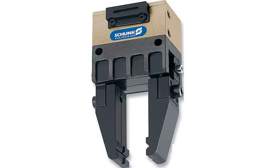

One electronics manufacturer quickens PCB assembly by using several MPG-Plus grippers equipped with workpiece-specific top jaws. Photo courtesy SCHUNK Inc.

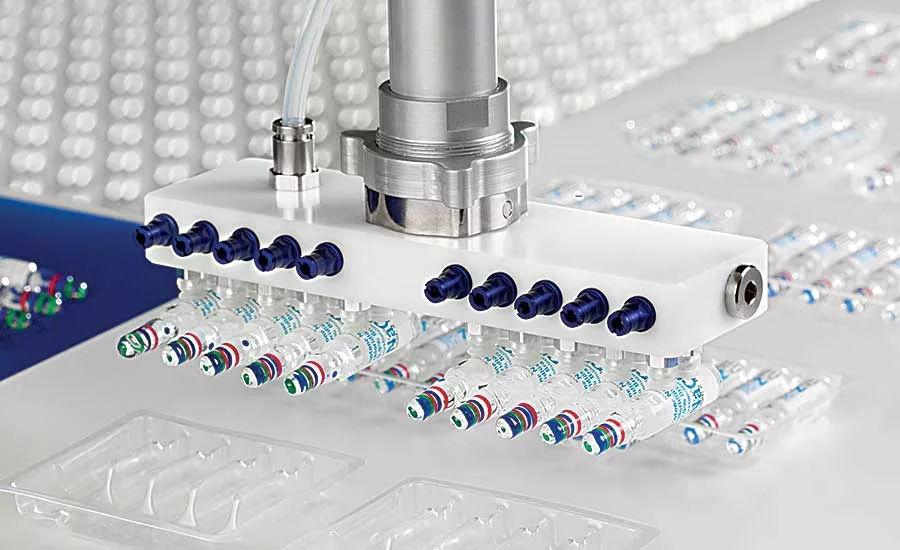

A collection of small bellows suction cups simultaneously manipulate 10 medical vials. Photo courtesy Schmalz Inc.

“Grippers and vacuum cups always need a light tough to properly grab small parts because they’re delicate,” notes Costas Charalambous, regional manager at Zimmer Group. “This is especially important for high-volume applications where a large amount of small parts are close together and one or more need to be handled quickly.”
For one large bearing manufacturer, Zimmer’s custom solutions division recently developed a mechatronic gripper that simultaneously grabs, orients and places nine or 12 plastic races as they come out of an injection molding machine. The division also made a custom pneumatic gripper back in 2010 with dual-stroke (2 or 4 millimeters) capability for a medical-device-component manufacturer.

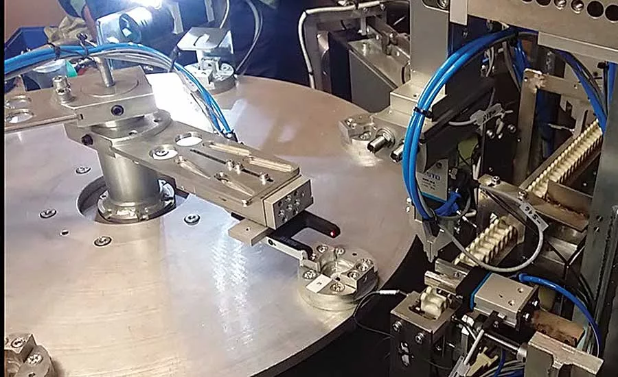

Several of Festo Corp.’s pneumatic grippers are able to handle small parts, according to Michael Guelker, product manager for pneumatic actuators at Festo. He cites an example of one plumbing parts manufacturer using Festo’s
DHTG rotary indexing table and two-finger DHPS and three-finger DHDS parallel grippers to automatically assemble water taps instead of doing it manually. Each gripper features an SME-8M sensor to verify grabbing and ensure accurate placement of all tap components at the four assembly stations and one inspection station.
Small parts can vary in weight and shape, making it even more difficult for a gripper or cup to establish proper grip. Cylindrical parts definitely present this challenge, says Kyle Kopac, applications engineer of vacuum automation at Schmalz Inc.
Recently, Schmalz worked with an integrator on a robotic system for a customer in the defense industry. The robot is equipped with an anti-static, bellowed rubber cup that grabs individual pellets from a bin and moves each one to a testing inspection station. The pellet measures 5 to 40 millimeters in diameter, weighs 0.5 to 20 grams, and is made of an explosive blended material.
“The bellows proved advantageous for this application because it wraps the cup around a curved object for proper grip and enables lifting of each pellet by interfacing only with its top surface,” explains Kopac. “The cup also allows the robot to handle different parts without having to change grippers, and each part has at least one gripping surface that was tested before integration.”

Markus Walderich, automation group manager at SCHUNK Inc., says consumer-products and electronics manufacturers frequently handle small parts. One consumer-products customer relies on two SCHUNK MPG-Plus pneumatic grippers to deposit pairs of curtain clips on a conveying belt. If an optical test of the clips proves negative, this information is sent to the controller, and the faulty clip or clips are deposited in a reject container.
As for electronics manufacturing, another customer quickens PCB assembly by using several MPG-Plus grippers equipped with workpiece-specific jaws. As a PCB passes by on a conveyor belt, each gripper places a different tiny component on the board. Special adapter plates enable a hose-free supply of compressed air to the grippers.
SCHUNK offers various models of electric grippers, including the EGP Speed series, designed to be just as fast as a comparable-size pneumatic gripper. The smallest model, EGP 25, features a reduced internal gear ratio that drives the jaws open or closed in 0.03 second for quick picking and placing of parts weighing up to 0.05 kilogram. Cross-roller guidance in the jaws ensure dynamic, precise and energy-efficient movement. The gripper weighs 110 grams, has a grip force of 13 newtons with a 3-millimeter stroke per finger and accepts the sensor systems used in MPG-Plus models.

Schwerdtle places the utmost importance on gripper finger design, according to President Kathy Saint. Founded in 1879, the company has made hot-stamping dies and tooling from millable HTV silicone since 1968, sheets of aluminum molded with various thicknesses of silicone since 1968, and custom gripper fingers made of silicone bonded to aluminum or steel since 2007.
Tiny fingers used for gripping medical devices are up to 0.125 inch wide by 3 inches long, although the silicone layer that actually grabs the part may be only 0.5 inch long. The fingers are usually screw-mounted to the gripper jaws, but can also be held in place by dowels, or slid into a slot, or magnet-mounted. Saint says the silicone is soft enough to gently grip small parts, but strong enough to provide good tensile strength, a high coefficient of friction, a low compression set (so as to not take the part shape) and handle just-made parts up to 500 F from a hot injection-molding machine.
Current customers for small-parts handling include medical-device companies (like Boston Scientific and Becton Dickerson), cosmetic and consumer-product manufacturers (including Gillette and P&G), battery makers (that grab thin, fragile films) and several university incubators that transitioned into commercial start-ups. Purchase orders range from a single custom finger to 1,000 per month.
“A while ago, one of our medical device customers was using a red silicone formulation for its gripper fingers,” explains Saint. “Unfortunately, this color caused the vision camera used in the application to see a shadow on the clear part that wasn’t there. We created a white compound for their fingers, immediately solving the shadow problem.”

“With small-part handling, it’s a good practice to keep gripper jaws as small as possible because space is usually limited,” notes Charalambous. “The jaws also should be light and made of plastic, and, if a pneumatic gripper is used, air should be run via a manifold plate for hose-less connections to keep a small installation profile.”
Manufacturers in various industries use Zimmer’s MGP-800 pneumatic parallel grippers, which are available in two- or three-jaw versions. The grippers are able to precisely handle parts smaller than a postage stamp, including tiny gears, pulleys and plastic components for medical devices. Their jaw stroke is as short as 1 millimeter, and the grabbing force as little as 1.8 pounds. Charalambous says end-users also like that the grippers are narrow enough for several to be positioned next to each other on the assembly line.
When using a cup to handle small parts, the biggest challenge is maintaining the proper level of vacuum, according to Kopac. This can be achieved by using a vacuum-level sensor in the vacuum generator and checking it daily.
Schmalz PFYN flat cups come in diameters of 1 to 200 millimeters, with the 3-, 5-, 6- and 10-millimeter sizes most commonly used for small parts. The cups are made of NBR, silicone, natural rubber, HT1, polyurethane, FPM (fluoro rubber) or anti-static vinyl.
