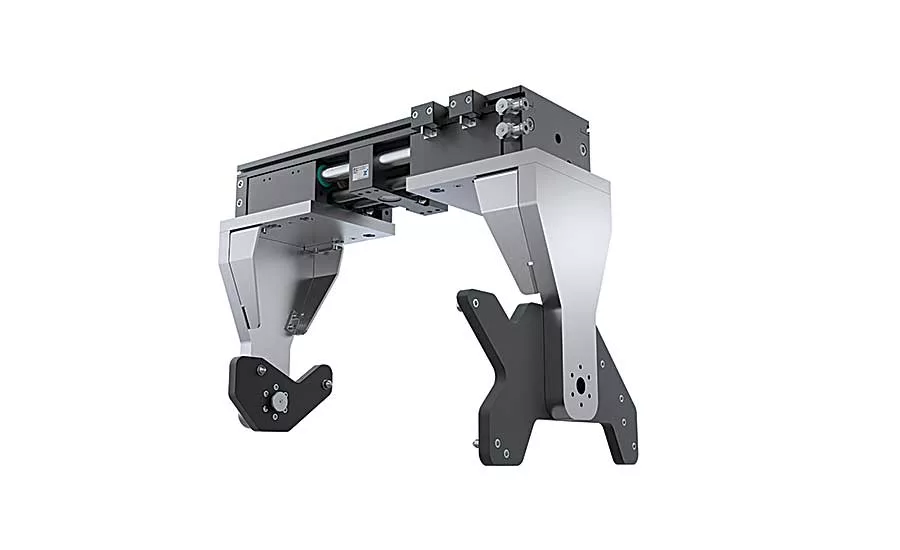

This new gripper is designed to handle large payloads, such as engine blocks. Photo courtesy Zimmer Group

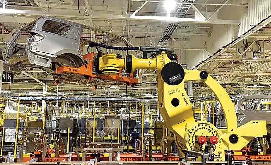

A new breed of robots can handle bulkier parts and heavier payloads. Photo courtesy Ford Motor Co.

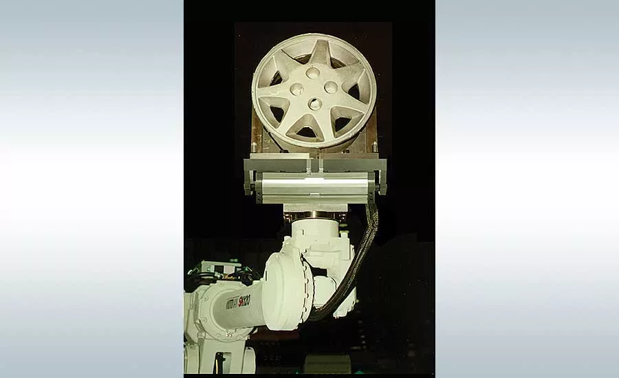

Large grippers are commonly used in the auto industry to produce wheels. Photo courtesy Festo Corp.

Collaborative robots have been grabbing all the headlines recently, but a new breed of brawny, six-axis robots has slowly been gaining favor with some manufacturers. Vendors such as ABB, Fanuc, Kawasaki, Kuka and Motoman now offer machines that can routinely handle heavy parts or bulky subassemblies.
For instance, Fanuc boasts that its M-2000iA robot is one of the strongest on the market. It can handle payloads up to 1,350 kilograms. With a reach of more than 4,600 millimeters, the machine can also perform many tasks traditionally handled by cranes or hoists.
Those types of machines appeal to manufacturers of cast and forged metal parts. They’re also attractive to companies that need to move automotive floor pans, car bodies, rear-axle assemblies, household appliances or other big objects, such as aircraft, railcar and ship parts.

“A common application for our large robotic grippers are machining workcells where aluminum wheel castings are being loaded and unloaded for various milling or finishing operations,” Hessler points out.

One of the newest large grippers on the market is Zimmer’s GPH8000 series, which was unveiled recently at the Motek show in Germany. It can accommodate extremely long and heavy gripper fingers, can be ordered with either synchronous or asynchronous finger movement, and can optionally be fitted with an integrated clamping element to secure the workpiece in the event of a loss of pressure.
“The GPH8000 is a two-jaw, parallel, long-stroke gripper that features up to 150-millimeter stroke per jaw,” says Charalambous. “It’s designed for picking up wide, heavy parts. The GPH8000 series is eventually going to consist of five different sizes of gripping force and four different lengths.”
