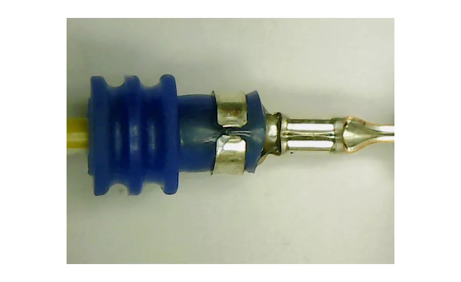

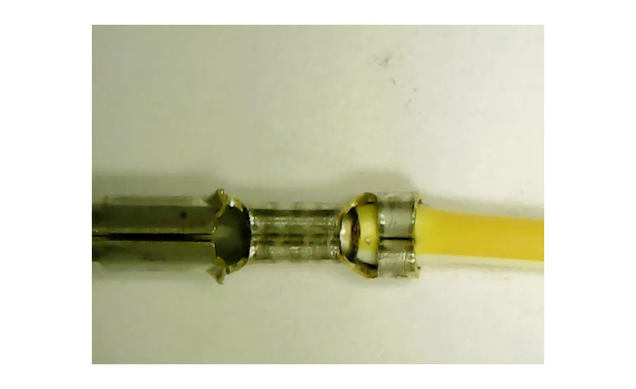

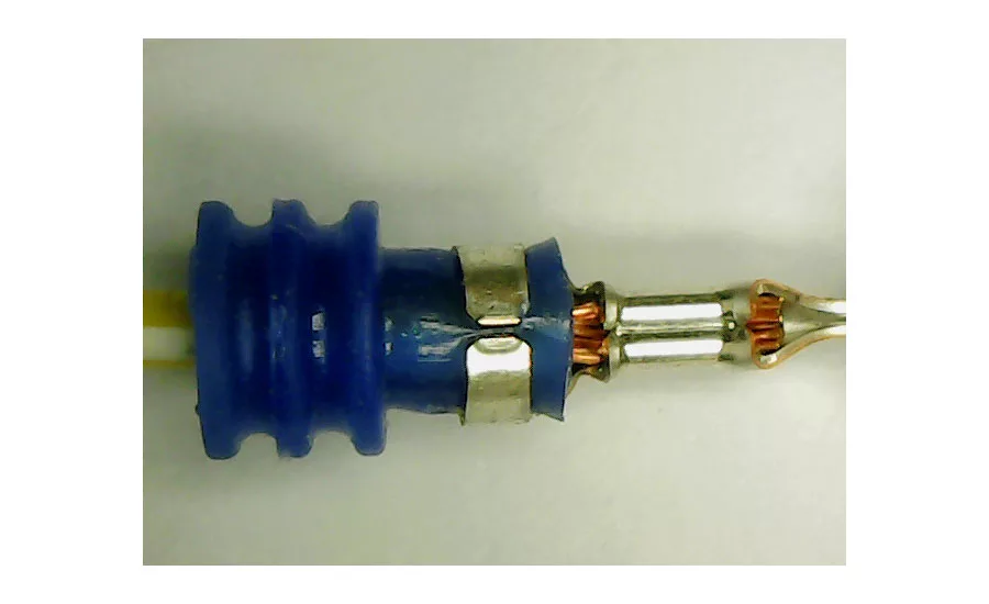

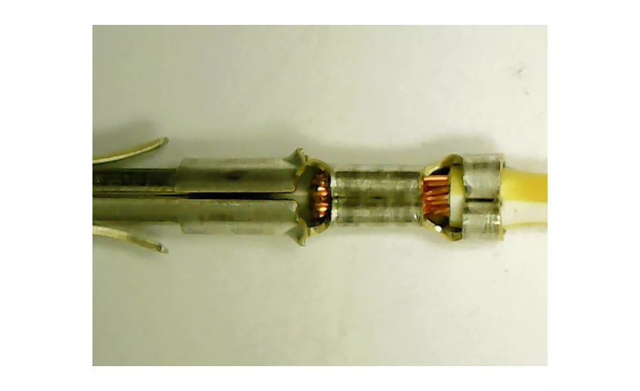

A. LV 214-4 defines what an empty crimp is. In a good crimp, the conductor crimp is filled with all wire strands, while the insulation crimp contains all the undamaged insulation material (photos B and D). Crimp parameters are at the nominal values as specified by the manufacturer. An empty crimp has a full insulation crimp, but the conductor crimp is empty (photos A and C). Photos courtesy Schleuniger Inc.

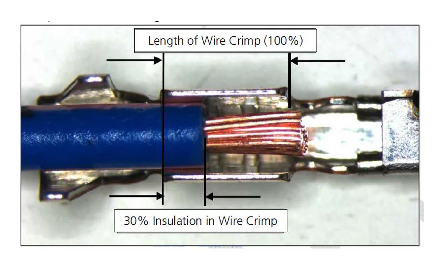

Under the LV 214-4 standard, a crimp force monitor must be able to detect an assembly with 30 percent insulation inside the crimp. Photo courtesy Schleuniger Inc.

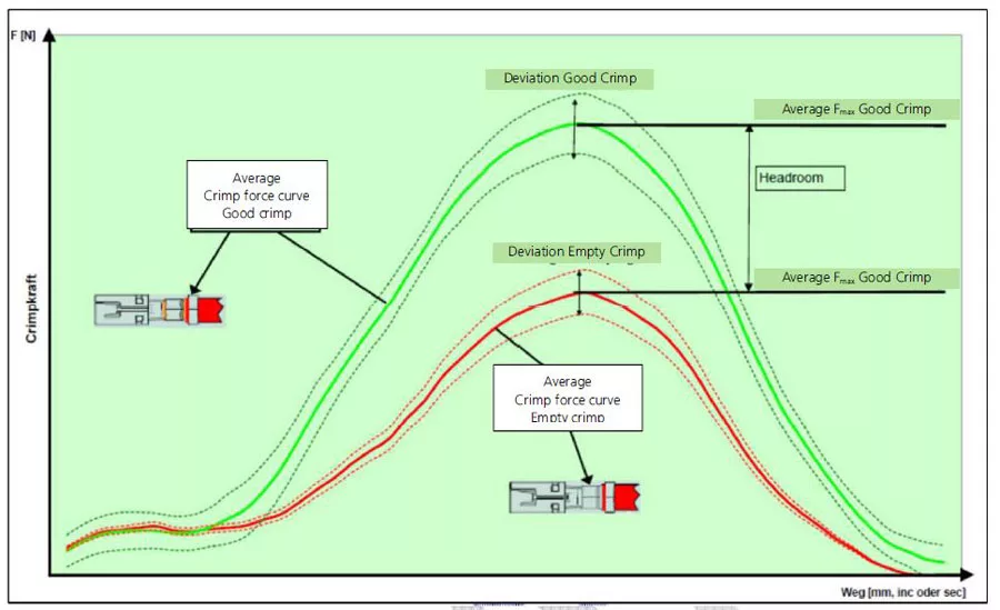

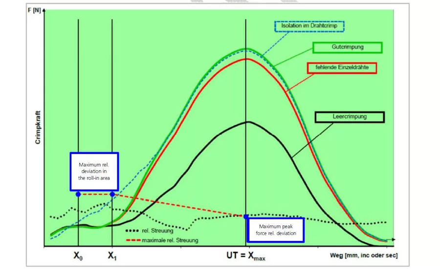

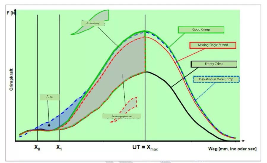

For many years, crimp force monitors have analyzed the total area under the crimp curve. However, the new LV 214-4 standard defines four area segments: one for good crimps and one for each error mode (empty crimp, missing strands and insulation-in-the-crimp). Illustration courtesy Schleuniger Inc.

Headroom is the difference between the peak forces of the average good crimp and empty crimp curves, also expressed as a percentage. Illustration courtesy Schleuniger Inc.

The LV 214-4 standard provides a formula to determine specific locations for X0 and X1. X0 is generally where the good crimp and the insulation-in-the-crimp curves begin to diverge. X1 is generally where the good crimp and empty crimp curves begin to diverge. Illustration courtesy Schleuniger Inc.

The standard focuses on relative deviation of force curves and headroom, both common concepts with regard to crimp force monitoring. Relative deviation is the variation of peak force expressed as a percentage. Headroom is the difference between the peak forces of the average good crimp and empty crimp curves, also expressed as a percentage.

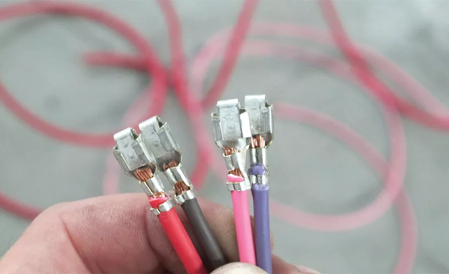

LV 214-4 defines what an empty crimp is, something that is not clear to all. In a good crimp, the conductor crimp is filled with all wire strands, while the insulation crimp contains all the undamaged insulation material. Crimp parameters are at the nominal values as specified by the manufacturer. An empty crimp has a full insulation crimp, but the conductor crimp is empty.
For many years, crimp force monitors have analyzed the total area under the crimp curve. However, LV 214-4 defines four area segments: one for good crimps and one for each error mode (empty crimp, missing strands and insulation-in-the-crimp). The good crimp area is the area between the good crimp curve and the empty crimp curve. Similarly, the missing strand area is the area between the missing strand curve and the empty crimp curve. Alternatively, the area for insulation-in-the-crimp is the area between the insulation-in-the-crimp and the good crimp curves. Differences in each of these areas must be detectable for the corresponding error mode.
The LV 214-4 looks closely at the “roll-in” portion of the crimp. The roll-in area is the beginning of a crimp force curve, where the terminal wings begin to roll in and close around the wire. Most monitors ignore this portion because forces are usually inconsistent, and this part of the crimp process is not very important. However, LV 214-4 analyzes relative deviation and defines the positions X0 and X1.
X0 is generally where the good crimp and the insulation-in-the-crimp curves begin to diverge. X1 is generally where the good crimp and empty crimp curves begin to diverge. The LV 214-4 standard provides a formula to determine specific locations for X0 and X1.
At this time, however, no crimp force monitor analyzes the area under the crimp curve as described in the LV 214-4 standard. Similarly, the force curve data in the roll-in area is typically ignored during monitoring with filters. Therefore, the different area regions, X0 and X1 are theoretical and will only be considered during initial validation of the terminal.

The next step is to detect insulation in the crimp. Like with missing strand detection, 10 wires must be processed with insulation in the crimp area and all must be detected as defects. LV 214-4 mandates 30 percent insulation inside the crimp for these tests and provides a clear method of measurement. If all are not detected as defects, the terminal fails and the test stops. If all are detected successfully, the test continues.
