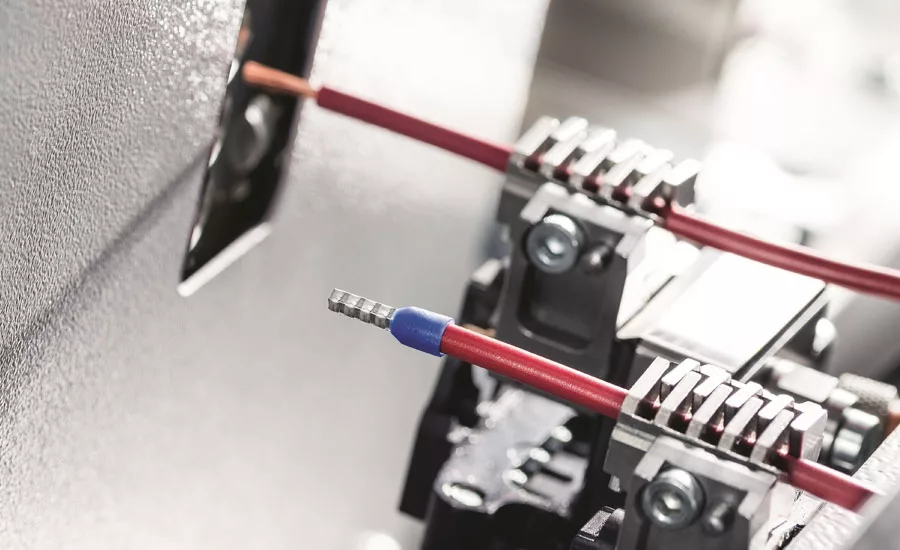

Up to five sizes of ferrules can be terminated at one time by the CM 1/5 GS module, when used with the Zeta 630 machine. Photo courtesy Komax Corp.

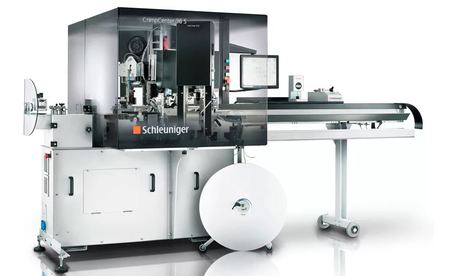

Harness manufacturers can integrate the CrimpCenter 36 S machine with up to six processing stations (three for crimping). The machine handles 26 to 12 AWG wire and feeds it at up to 26.3 fps. Photo courtesy Schleuniger Inc.

Two of the units are CrimpCenter 36 S fully automated cut, strip and crimp (CSC) machines. Joe Prior, president of MRG, says these machines have helped reduce setup times by 50 percent and increased processing speeds by 25 to 30 percent. He also likes the machine’s ability to store wireprocessing programs on a cloud network for easy access and quick recall by the Massachusetts and Mexico facilities.

Dawson says that manufacturers of electrical control cabinets often integrate their CSC machines with one of these welding stations. There, exposed conductor strands are compacted into a slug, which is then inserted into a terminal block.
In 2015, Komax introduced the Zeta 630 to specifically help control cabinet makers quicken wire processing. The machine processes 24 to 10 AWG wire, and its automatic selector loads up to 36 different wires. As many as five sizes of ferrules can be terminated simultaneously with the optional CM 1/5 GS module. Other modules perform MIL-spec crimping, ink-jet marking and wire-end solidifying, splicing or welding.

Schleuniger’s compact CrimpCenter 36 S machine can be integrated with up to six processing stations (three for crimping). It handles 26 to 12 AWG wire, features a user-friendly touchscreen and EASY operating software, and integrates with existing networks via TCP/IP. The machine feeds wire at up to 26.3 fps, and quickly saves and retrieves all wire, crimp and seal data. Processing capabilities, besides crimp to crimp, include crimp to seal; seal to seal (both sides sealing); double crimp (two or three terminals); double crimp with a crimp or seal (two terminals), or twist or tin (one terminal); and twist or tin to crimp or seal.
