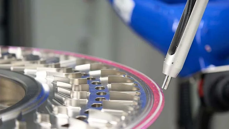

Kaltenecker’s colleagues manually attach, fit and clamp the adhesive tape, silicone rings, masks or metal covers to these areas with a precision of less than a millimeter. By contrast, the fully automated dispensing system applies the elastomer to a component without human intervention. Then, a UV lamp cures the material in seconds. After the component passes through the process, whether it be thermal coating, shot blasting or electroplating, the maskant is pulled off the component without leaving residues behind.

The automated dispensing and curing system grew out of those efforts. As Kaltenecker tells his story, a blisk revolves in the robot cell behind him. The machine’s optics have recognized that it is dealing with the fourth stage of a specific high-pressure compressor. The control unit loads the corresponding program, sets up the correct dispenser and moves it into position. While the rotary table turns, tilts, lifts and lowers the component, an automatic dispensing valve continuously conveys elastomer from the cartridge. The valve applies the material precisely along the edges of the thin blisk blade tips. The machine can also fill drilled holes or apply maskant over broad areas. The system can accommodate numerous applications and variations.
“The exact shape of the specific mask is defined by the respective process parameters, such as the type of dispenser attachment, the distance and angle of the dispenser to the component, and the flow rate,” Kaltenecker explains.

The dispensing valve is the preeflow eco-PEN from ViscoTec. The eco-PEN is a positive-displacement dispensing system that provides accurate and repeatable dispensing by means of a rotor that turns inside a stator. The device operates like a progressive cavity pump, dispensing a wide range of material viscosities with no stress to the material. The valve can dispense amounts as small as 0.001 microliter with an accuracy of ±1 percent. A slight reverse motion of the stator sucks back material at the tip, preventing drips and ensuring a clean cut-off of flow.
Once the material is in place on the parts, a UV lamp buzzes past and cures the elastomer. Finally, a vision system inspects the parts. “The system can spot, for example, whether there are unwanted little air bubbles or imperfections in the masking,” says Kaltenecker.
