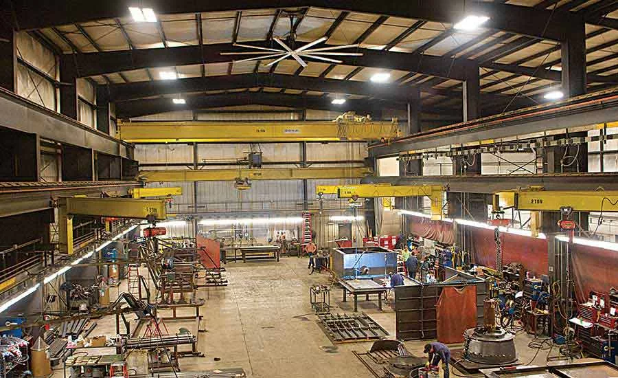

Although overhead fans can disperse shielding gases used in welding operations, it’s by no means a certainty. Thousands of welding facilities have installed fans successfully. Photo courtesy Big Ass Solutions

While it’s true that fans can disperse shielding gases, it’s by no means a certainty. Thousands of welding facilities have installed fans successfully. It simply required a few more steps and a little more expertise than installing a ceiling fan in, say, a dry-goods warehouse or a living room.
It’s all about finding the sweet spot—the combination of fan speed, fan size and adequate distance from the welding area—to achieve a cooling airflow without blowing away shielding gases. However, because no two facilities are alike, there is no one-size-fits-all solution. The ideal type, size and speed of a fan will vary based on factors such as the facility’s dimensions and layout, and what type of welding is being done.
For example, at the request of a major manufacturer of earth movers and farm equipment, extensive testing by our research and development team showed that the manufacturer could run 18-foot fans at 60 to 70 percent of maximum speed without affecting shielding gases in their welding facility. At that speed, the fans still provided enough airflow to create approximately 5 to 7 degrees of perceived cooling for employees. That customer has since bought some 60 fans from us.
However, in a smaller facility where the only viable mounts for overhead fans were bar joists directly over the welding bays, installing overhead high-volume, low-speed (HVLS) fans proved problematic. In that case, the presence of numerous I-beams meant variable-speed directional fans could be mounted so that they delivered the correct airflow without disrupting gas delivery.
The best way to guarantee that HVLS fans will work in a welding facility is to enlist the help of a fan company with an applications engineering team that can provide custom fan layouts accounting for all variables. In complex situations, a mobile team of engineers can be called in to perform on-site measurement and evaluation.

Installing a fan directly over a welding area will almost always affect shielding gases. However, many facilities managers who have resisted HVLS fans don’t realize that a fan needn’t be directly overhead to provide cooling airflow.
Much of the breeze from an HVLS fan isn’t a result of air being pushed downward by the fan. Rather, it’s from air that impacts the floor and flows outward, creating what’s known as a floor jet.
To have the smallest impact possible on shielding gases, fans should be installed away from the welding area, giving the floor jets enough space to slow down before reaching the welding station. At the correct distance, the fans can provide all their normal benefits—year-round thermal comfort and improved air circulation—while floor jets can even send a few degrees of cooling to welding technicians.
