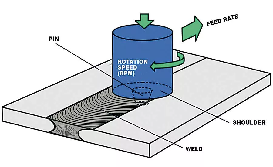

In friction stir welding, a cylindrical shouldered tool with a profiled pin is rotated at high speed and plunged into the joint area between two abutting metal plates. Frictional heat causes the metal to soften without melting. Then, the rotating tool traverses along the joint line, transferring the softened material around itself as it moves. Photo courtesy RWTH Aachen University

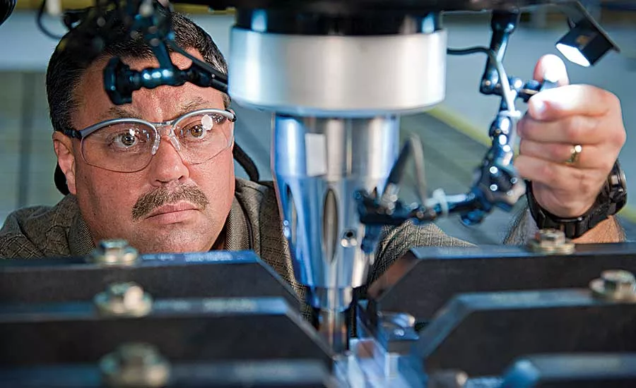

Tim Livengood, a welding engineer with The Boeing Co., confirms the setup on a friction stir weld test fixture. Photo courtesy The Boeing Co.

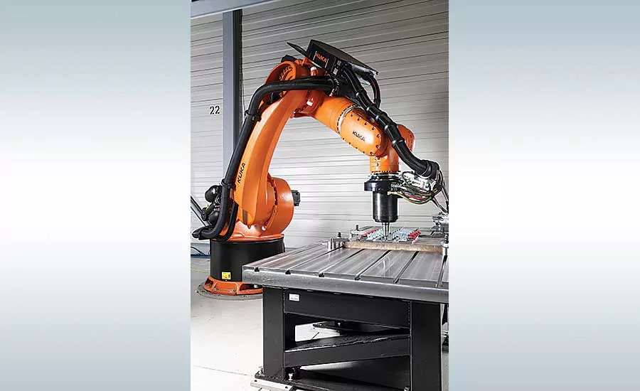

Friction stir welding can be performed by an XYZ gantry machine (if the joint line is on one plane) or a six-axis robot (for three-dimensional joint lines). Photo courtesy Kuka Robotics Corp.

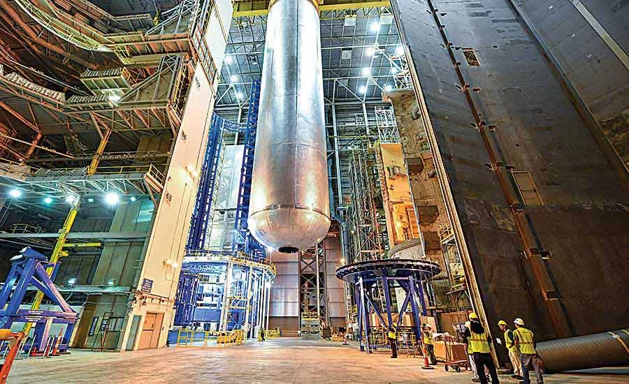

Friction stir welding was used to assemble the liquid oxygen fuel tank of NASA’s new SLS deep-space rocket. Photo courtesy NASA

On Sept. 1, NASA finished welding the rocket’s liquid oxygen tank, one of five major components of the 212-foot-tall core stage of the SLS. The other four are the engine section, liquid hydrogen tank, intertank and forward skirt. The liquid hydrogen and liquid oxygen tanks will hold 733,000 gallons of propellant to power the stage’s four RS-25 engines.
Made of an ultra-lightweight, high-strength, low-density aluminum-lithium alloy, the tank cannot be assembled with conventional fusion welding techniques. There are simply too many process factors that must be controlled, such as purge gas, voltage and amperage, wire feed, travel speed, shield gas and arc gap. Instead, the tank was assembled with a relatively new technology: friction stir welding.

In friction stir welding, a cylindrical shouldered tool with a profiled pin is rotated at high speed and plunged into the joint area between two abutting metal plates or sheets. The parts must be securely clamped to prevent the joint faces from being forced apart. Frictional heat between the wear-resistant welding tool and the workpieces causes the latter to soften without reaching their melting points.
Then, the rotating tool traverses along the joint line, transferring the softened material around itself as it moves and stirring material from each part together. The plasticized material is pressed downwards by the tool shoulder, preventing the material from flowing out from the joint line. The material is transported from the front of the tool to the trailing edge where it is forged into a joint. On cooling, a solid-phase bond is created between the workpieces.
Friction stir welding is most often used to create butt joints. For butt welds of thin plates, a cylindrical tool is employed, whereas a conical tool is used for butt welds of thicker plates. Whether cylindrical or conical, the tool surface is threaded. The length of the tool closely matches the thickness of the workpieces.

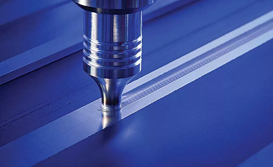

The main variables of the friction stir welding process are welding (travel) speed, tool rotation speed, axial force on the tool, the tilt angle of the tool, and tool design. These variables determine the peak weld temperature, linear force, torque and power.
Peak weld temperature increases significantly as tool rotation speed increases and decreases slightly as travel speed increases. Weld temperature also increases with as axial pressure increases. Axial pressure also influences joint quality. High pressures lead to overheating and thinning of the joint, while low pressures may lead to insufficient heating and, in turn, void formation.
Higher travel speeds may cause excessive linear force, which may, in turn, lead to tool erosion and even tool breakage. The power requirement also increases as axial pressure increases.
The torque depends on several parameters, such as axial force, tool design, tilt angle, local shear stress at the tool-workpiece interface, the friction coefficient, and the extent of slip between the tool and workpiece. The torque decreases with an increase in tool rotational speed, owing to an increase in peak temperature. On the other hand, torque is not significantly affected by a change in travel speed.
The peak temperature is not significantly affected by travel speed. High travel speeds tend to reduce heat input applied to the workpieces during friction stir welding. Therefore, the torque increases only slightly with increasing travel speed, since material flow becomes somewhat more difficult at slightly lower temperatures.

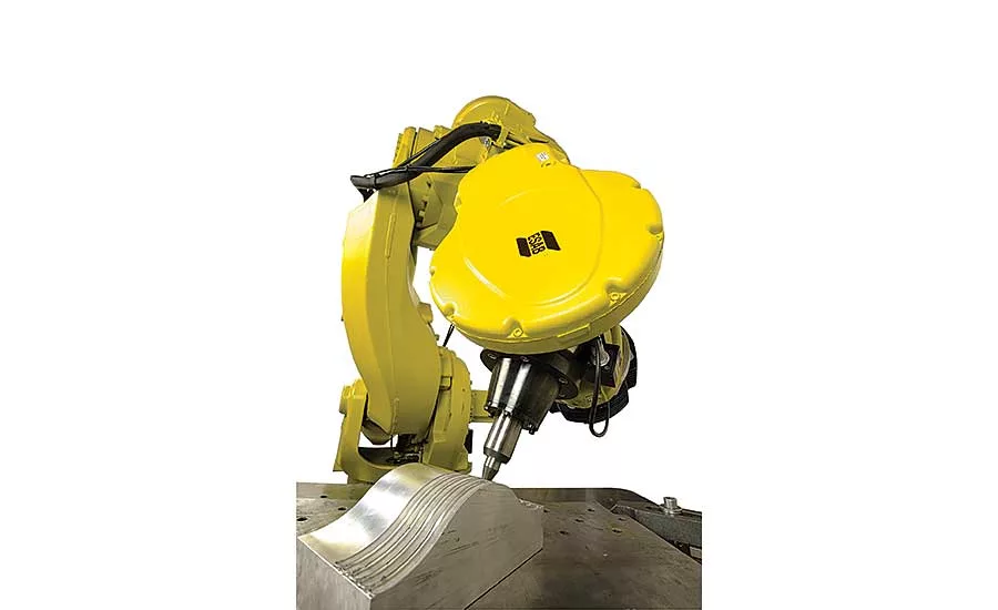

Alternatively, friction stir welding can also be done by a six-axis robot, such as ESAB’s Rosio. The cell consists of an ABB IRB 7600 robot, modified for the purpose of friction stir welding. The welding equipment is integrated in the mechanical structure of the robot without limiting the robot’s standard working envelope. The robot’s work envelope spans more than 2.5 meters. The robot can apply as much as 13 kilonewtons of downward force during welding.
