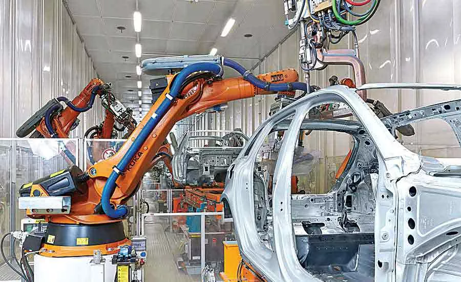

Welding robots need to be properly integrated into a plant’s IIoT platform to obtain helpful data for manufacturers. PHOTO COURTESY BOSCH REXROTH

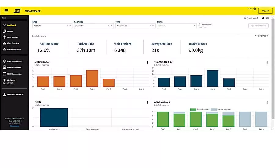

On an Android device, users of WeldCloud can log the welding consumable, operator, and job or part number, then view this data in real time on a dashboard. PHOTO COURTESY ESAB

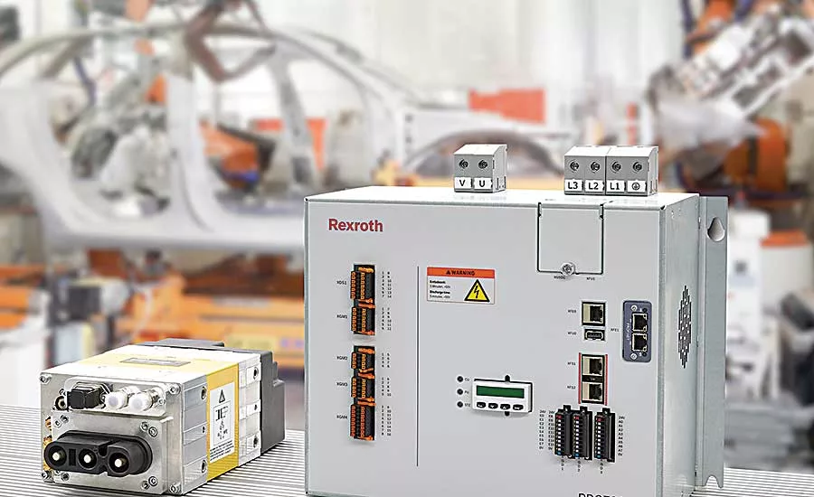

The PRC7300 controller works with several open interfaces that are commonly used for the welding process and communication with robots. To its left sits a welding transformer that mounts in a robot’s weld gun. PHOTO COURTESY BOSCH REXROTH

A mobile app for Android devices is required to configure and link the Connector to the server. Through the app, users are able to scan and log the consumable type (wire, gas, etc.), operator, and job or part number. They then view this data in real time on a dashboard, or screen graphic.
“There are three beneficial aspects to WeldCloud for manufacturers,” says Weisensel. “The first is productivity, and it can really help companies that are focused on kaizen and operating lean. Recorded data lets managers determine arc-time efficiency by department, shift, welding asset and time. They can quickly see if a work cell is meeting uptime demands or not, and recognize other performance trends by welders.”
Another benefit is documentation, courtesy of the software’s Notes feature. Weisensel says that managers can now register all the welds and components in a project, including base metals, welders and filler metals. They can also write a book with all the welding procedures used in a project, and generate a PDF containing all of this information.
“Equally important, management can select the proper welding procedure specifications that have been approved and are qualified for a project, and then include them in a PDF report,” adds Weisensel. “Plus, they can quickly qualify welders and keep track of their welder certification with reminders for when they are about to expire.”
The last benefit is machine-fleet maintenance. At any time, managers can accurately determine how active each welding power source is on the production line, and find out the source’s lifetime usage. They can also program all WeldCloud-enabled machines in their fleet to send service alerts to maintenance personnel.

Other German manufacturers, including BMW and Daimler AG, rely on the PRC7000 series controller from Bosch Rexroth to improve their resistance spot welding. The controller comes in 600- and 1,600-amp versions, both of which feature Adaptive control algorithms that ensure repeatable, high-quality welding of aluminum, steel and other materials in different thicknesses.
“By precisely adjusting welding current with this controller, spatter and expensive reworking can be avoided,” says Paul Patterson, resistance welding salesperson for North America at Bosch Rexroth. “It offers advanced processing control and monitoring, and enables efficient handling and diagnostics with PRI7000 software, which can store up to 10,000 welding programs.”
The controller has an open system architecture with integrated application layer and electric servo-gun functionality. An integrated web server facilitates welding operation and diagnostics via smart phones and tablets. State-of-the-art electronics improve energy efficiency.
The 600-amp PRC7300 controller offers similar features and benefits, along with quick commissioning, and 16 digital inputs and eight digital outputs. It also works with several open interfaces (ProfiNet, EtherNet/IP, DeviceNet, etc.) that are commonly used for the welding process and communication with robots. This flexibility allows for easy integration into customer-specific automation systems and Industry 4.0 environments.
“In 2018, Daimler told us it wanted to upgrade to PRC7000 welding controllers in two of their large plants in Germany,” explains Patterson. “They had been using our PRC6000 series controller for close to 17 years, but wanted to improve their welding operational diagnostics by being able to collect and analyze more data.”
Both plants are highly automated and feature 400 to 500 six-axis KUKA robots, each of which has its own controller. The only staff working in the facility are managers, people who load and unload parts from the robot welding cells, and maintenance personnel.
According to Patterson, the main reason why Daimler upgraded to the PRC7000 is the controller’s built-in MQ Telemetry Transport (MQTT) network protocol. The MQTT enables the manufacturer to send welding data more quickly to an onsite server such as OPC-UA at each plant. This data includes voltage, force, resistance, position and adaptive curve information for each weld.
Daimler also likes that the controller provides precise control of both the servo weld gun and its weld tip. Patterson says that the PRC7000 is one of the only controllers with such capability, through one interface.
“All of this data is stored on each plant server, and Daimler carefully manages it in-house,” notes Patterson. “Whenever any data is not within a tolerance parameter, managers and workers are notified on screens located all through the plant. Also, maintenance people immediately get a text message, and act on it to resolve the problem.”
