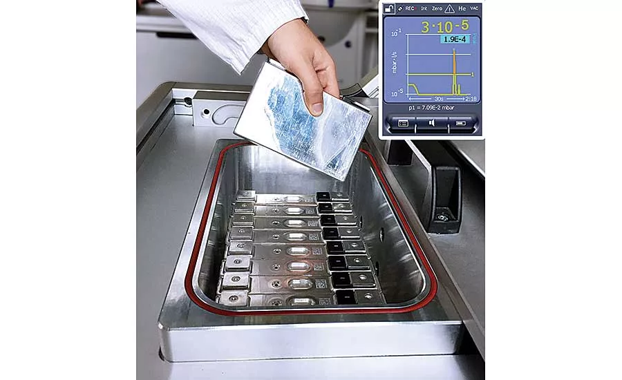

Battery cells for electric vehicles are leaktested at an Inficon facility in Cologne, Germany. Testing of individual battery cells after production and again prior to assembly into battery packs is critical to ensuring battery pack longevity. Photo courtesy Inficon

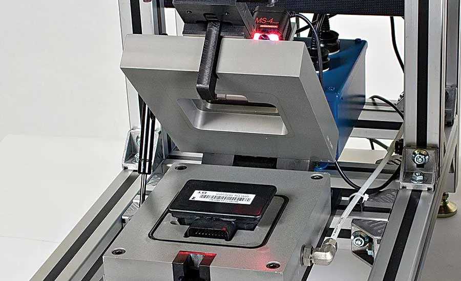

two-step test cycle checks this electronic control module for gross leakage and then fine leakage to a limit of 0.6 standard cubic centimeters per minute and 10 percent gauge R&R. Photo courtesy InterTech Development Co.

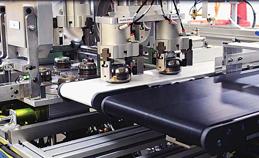

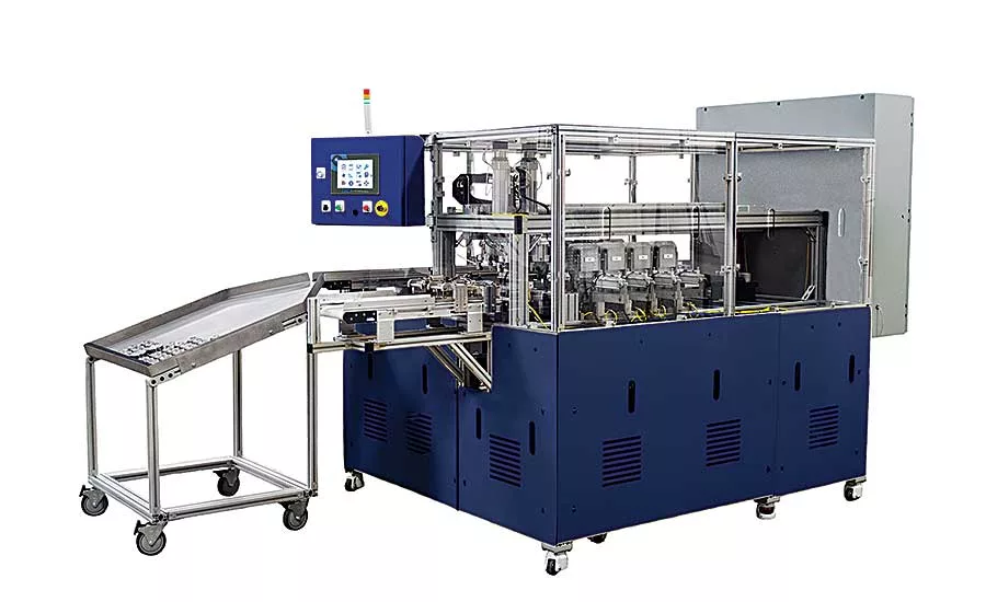

This automated test system uses helium to check air bag inflators for leaks. Photo courtesy Laco Technologies Inc.
Ingress Leak Testing
Leak rate specifications for ingress testing are typically stricter than for outflow tests, particularly for assemblies like these air bag inflators. Photo courtesy Laco Technologies Inc.

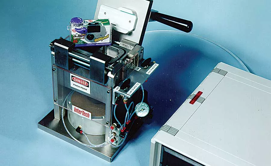

This system was designed to test a waterproof camera to a limit of 0.5 standard cubic centimeters per minute at a rate of 180 parts per hour. Photo courtesy InterTech Development Co.

The most common method of ingress leak testing is a pressure decay test. The assembly is placed in a chamber, which is then pressurized with air. At a predetermined pressure, the chamber is cut off from the pressure source. If there’s a leak, air will flow into the assembly, causing the pressure inside the chamber to drop. The leak rate can then be calculated based on the change in pressure over a certain period of time.
A variation on the pressure decay method is the mass-flow method. The test part is placed in a chamber. The chamber and a reservoir are pressurized to test pressure, then isolated from the pressurizing source. If the test part leaks, the pressure inside the chamber will force air into the part. Since the reservoir remains at test pressure, air will flow from the reservoir into the chamber to maintain equilibrium. A mass-flow transducer, located between the reservoir and the test chamber, measures that air flow, providing a direct assessment of how badly the assembly is leaking.
“The advantage of positive pressure over vacuum is that it will be more searching,” says Jacques Hoffman, president of InterTech Development Co. “It simulates actual operation, whereas when you pull a vacuum, you might be closing up leaks.”
With either the pressure decay or the mass-flow method, it’s important that the test instrument check for gross leaks prior to looking for fine leaks, says Dewailly. An assembly with a gross leak is essentially open to the atmosphere. Thus, the air pressure inside the assembly will instantly be identical to the air pressure in the chamber. In other words, there will be no pressure loss inside the chamber, and an assembly with a gross leak will appear to be good.
Gross leak detection is accomplished by controlling the volume of air used to charge the chamber and monitoring the final pressure. Failure to achieve test pressure in a specific time indicates a gross leak.
“When you put a known volume of air inside the test chamber, you would expect pressure to reach, say, 2 psi, if the component is good,” explains Dewailly. “But if the component is wide open, the chamber will only reach 1.5 psi.”
For pressure decay testing to work, the assembly must have enough internal volume that the test instrument can detect a gross leak. In addition, the amount of “dead volume”—the volume between the interior of the chamber and the exterior of the part—is a major factor in the cycle time of the test. The larger the dead volume, the longer the cycle time.
That’s why test chambers are typically custom-made for each assembly. It’s also a good idea to keep the test instrument close to the test area, to minimize the amount of air in hoses.

Another option for ingress leak testing is a technique known as “helium bombing.”
In helium bombing, a batch of assemblies is placed in a chamber and exposed to helium at a set pressure for a set length of time. If an assembly has a leak, helium will gradually seep into it. Next, the assemblies are removed from the helium chamber and placed, one at a time, in a second chamber and a vacuum is drawn. A mass spectrometer then looks for helium leaking from the assembly.
This is how air bag igniters are tested. For example, InterTech recently designed a helium bombing system that automatically tests small air bag igniters to a leak rate specification of 10-6 standard cubic centimeters per second at a rate of 1,800 parts per hour. The igniters were approximately the size of a medication capsule.
That latter aspect is important, since the bombing technique works best with smaller assemblies. “Helium bombing is only suitable for small devices, because they have a small internal volume,” says Chamberlain. “It’s not practical to pressurize parts with large internal volumes. The cycle times become unreasonable.”
“Bigger parts have more surface area, which can retain ambient humidity and helium. That can slow down cycle time,” adds Parker. “When testing larger parts, companies will often have more than one test unit to meet throughput.”
Handling time is also important with the helium bombing method. “You have to get the part from the bombing chamber into the testing chamber rather quickly, because helium could leak from the product on its own [without the aid of vacuum]. You can’t wait days to test those [bombed] parts,” advises Parker. “Parts can be in that chamber for hours. Some companies have recipes calling for four to eight hours in the helium chamber.”
As an alternative to the bombing technique, some air bag manufacturers seal small amounts of helium into inflators during assembly. Depending on the manufacturer, this helium may have a functional role in the air bag, or it may simply be added to facilitate subsequent leak testing.
Either way, the inflator is placed in a sealed chamber and a vacuum is drawn. As with the bombing technique, a spectrometer detects helium leaking from the assembly.
“The challenge with that method is that you’re measuring helium leaking out from the part when you’re actually concerned about gas leaking into the part,” says Chamberlain. “It’s not the ideal test, but it’s adequate. We would prefer to test the part…under the same conditions that it will see in use.”
