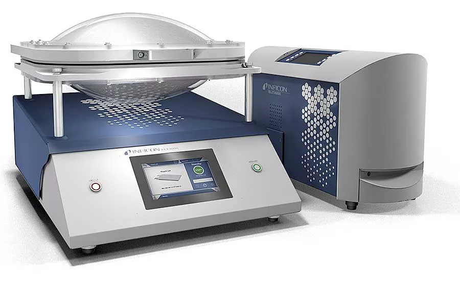

The new ELT3000 will enable automakers to leak-test fully assembled EV battery cells accurately and reliably. The flexible, saucer-shaped chamber on the left is designed to test pouch cells. PHOTO COURTESY INFICON

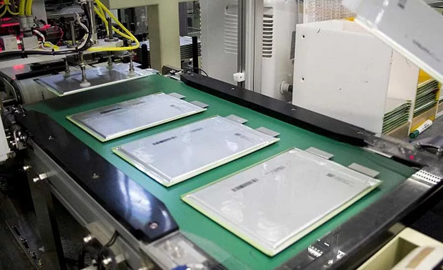

Lithium-polymer, or pouch, cells are not amenable to conventional vacuumbased leak-testing methods, because the pouch itself holds a vacuum. PHOTO COURTESY GM

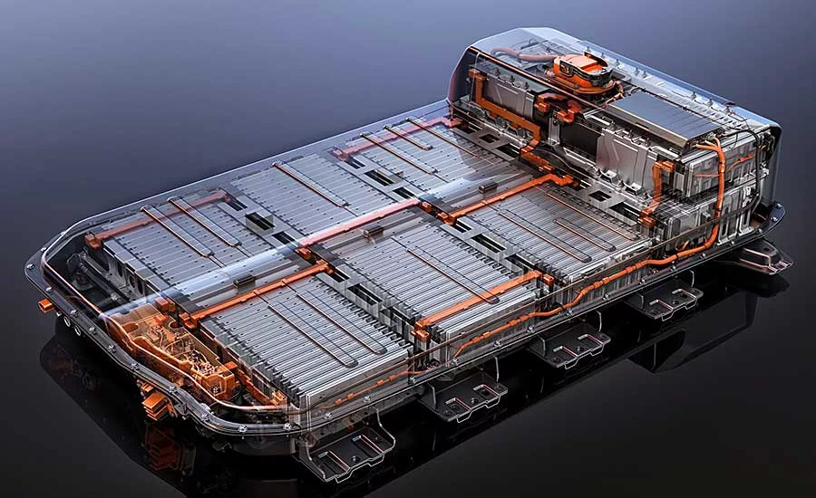

For EVs to surpass gas-powered cars, however, OEMs will need to assuage consumer concerns over quality, durability and safety, particularly for the primary component of EVs: the battery pack. For starters, the pack—and all the individual cells that make up the pack—must be absolutely leakproof. The electrolyte solution must not leak out of the cell, and moisture must not leak into it. That’s no small thing, considering that an EV contains hundreds or even thousands of battery cells.

Now, a new technology from Inficon, the ELT3000, will enable automakers and battery suppliers to leak-test fully assembled EV battery cells more accurately and reliably.

Pouch cells don’t have a rigid metal case, which makes them lightweight and compact. The pouches resemble packages of vacuum-packed coffee—only longer, wider and thinner. The design is not amenable to conventional vacuum-based leak-testing methods, because the pouch itself holds a vacuum.
“You have vacuum conditions inside the pouch cell and that makes it more complicated to test,” says Wetzig. “You need vacuum outside of the cell to force [molecules] from inside the product to the outside [where they can be detected.]”
Pressure-based leak-testing methods are also problematic. “You could put the cell in a pressure vessel, apply pressure, and if the pressure changes by a certain amount in a certain amount of time, you can assume that pressure has gone inside the part, and you have a leak,” explains Parker. “Another approach is simply to let these pouches sit for hours or even days. Then, technicians will check the cells to see if they’ve expanded. It’s a visual inspection.
“Neither method can find a hole that could allow humidity to penetrate the cell.”

Inficon’s new system will, for the first time, enable automakers and battery suppliers to accurately test battery cells that have already been filled with electrolyte and welded shut. The instrument can identify leaks 1,000 times smaller than what can currently be detected with existing technologies. The system consists of a mass spectrometer, a vacuum control unit, and a vacuum chamber. Equipment for testing prismatic and cylindrical cells is scheduled for introduction in October, while instruments for testing pouch cells will be available in late 2020 or early 2021.
As with tracer gas methods, Inficon’s process begins with placing the battery cells in the chamber and pulling a vacuum. However, instead of trying to detect a tracer gas, like helium, Inficon’s technology is designed to detect molecules from common electrolyte solvents used in batteries, including dimethyl carbonate (DMC), diethyl carbonate (DEC) and ethyl methyl carbonate (EMC). The system can detect leak paths as small as approximately 2 microns, equivalent to the smallest detectable helium leak rate of 1 x10-6 millibar-liter per second.
“We took established technology that we developed to detect refrigerants in the air conditioning and refrigeration industry, and we applied it to detect electrolytes coming from the battery cell,” says Parker. “It took us two to three years to figure out the best way to detect the electrolytes.
“We also had to figure out the best way to fabricate calibrated leaks for metrology purposes. Because of the viscosity of the electrolyte, it’s hard to make a repeatable, calibrated leak. Our customers are focused on metrology and measurement certainty. Whether you’re making an air bag inflator, a pacemaker or a battery pack, you have to prove that your process is capable.”
Another innovation is Inficon’s flexible, saucer-shaped vacuum chamber for testing pouch cells. The chamber is based on the company’s Contura S400 system for leak-testing flexible food packages. It features a pair of flexible membranes that conform to the cell without blocking potential leak paths.
“If you put a pouch cell inside a rigid vacuum chamber, the pouch will expand under vacuum,” explains Wetzig. “With a flexible chamber, you can generate vacuum conditions directly around the pouch, but at the same time, atmospheric pressure still acts on the pouch. A small gap is maintained between the pouch and the chamber, and that volume is [enough to allow molecules] to leak from the test object.”
Depending on the size and type of the cell, the ELT3000 system can test more than one battery cell at once. Test time is 45 to 60 seconds per batch, depending on the size of the vacuum chamber.
