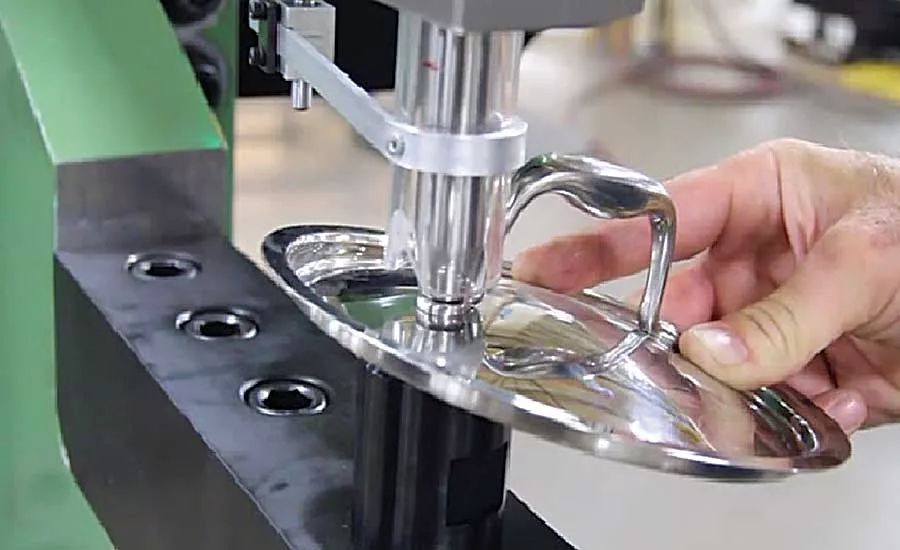

Impact riveting requires the machine operator to access both sides of the assembly. After placing parts (metal, plastic or rubber) in a fixture, he activates the machine by either pressing a button or stepping on a foot pedal. The rivet is fed from a hopper or a vibratory bowl, down a track, to open jaws that immediately close and insert the rivet shank into the part holes. A ram then strikes the rivet with enough compressive axial force to flatten the opposite end of the rivet and form a new head.
Machine tooling is unique to each application and includes custom jaws, a ram driver and an anvil, which determines the clinch shape. Kevin Klapperich, machine division manager at National Rivet & Manufacturing Co. (NRM), says failure to maintain the anvil can result in rivets that do not curl uniformly, have cracked curls or don’t securely fasten parts.

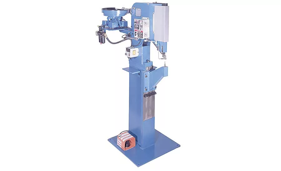

Grant Riveters offers several impact riveting machines. The Edward Segal P250-P pneumatic riveter is used for furniture, framing, automotive sheet metal piercing and various tubular products. It handles solid and semitubular rivets up to 0.3125 inch diameter and 1.625 inches long. Standard features include a single spindle, a 3-inch ram stroke, a 16-inch throat and a 14-inch vibratory bowl feed system. The pedestal machine has a 42-inch working height and a 24-by-36-inch footprint.
“Some manufacturers use impact riveting with a solid rivet because it distorts (swells),” notes Bruce McNaughton, president of Grant Riveters, which has made riveting machines since 1880. “If that type of rivet provides the best fit to the components and sufficient mechanical support, then it’s the best riveting option for that application.”

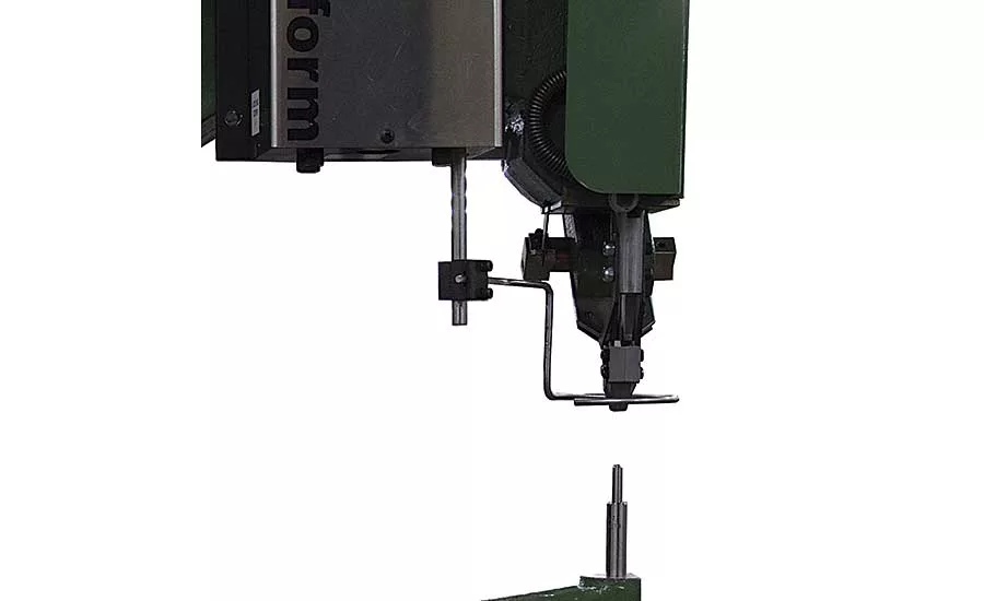

In recent years, as end-users have placed a greater emphasis on safety, suppliers have responded in kind. Most models now feature a safety probe, which has a small-diameter tube configured in a halo. This halo moves from the ram to the part to detect no interference prior to the ram advancing during the forming process.
Although the standard probe is OSHA approved, it can limit throughput by making it difficult to load the components being assembled, notes Wright. Aware of this, Orbitform developed a robust pneumatic safety probe in 2015 that is shorter and mounted next to the ram. It allows  maximum load clearance and helps increase throughput. The probe is offered as an option, although Wright says the company strongly recommends that its customers use a safety probe on every machine to satisfy OSHA
requirements.
