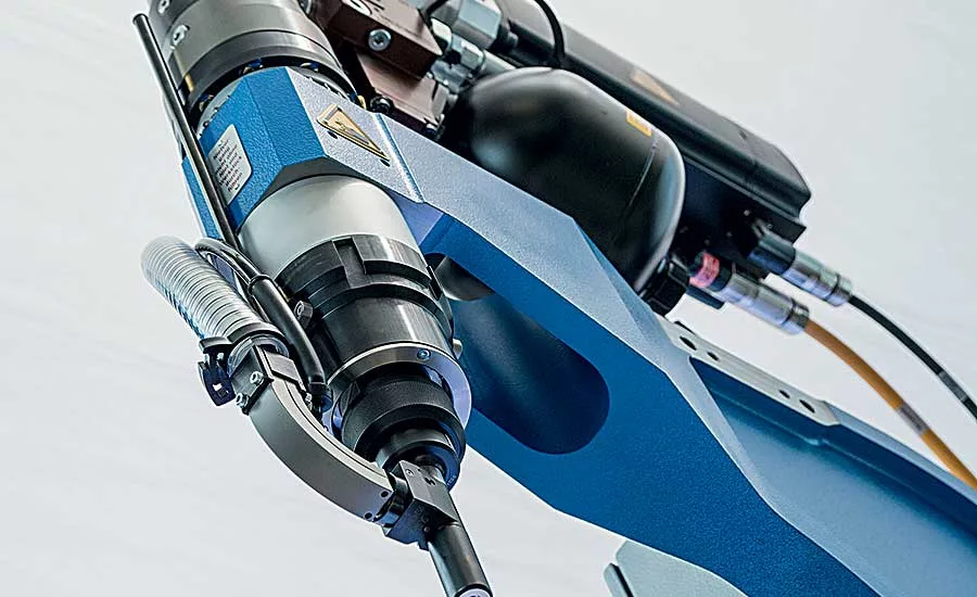

Servo-driven rivet setters like this one have largely replaced hydraulic equipment for installing SPRs. Photo courtesy Bollhoff

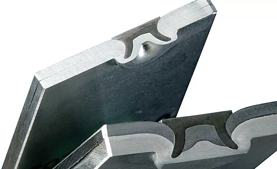

SPR can be used to fasten a variety of materials, including steel, aluminum, nylon webbing, plastic, and rubber. It can also join galvanized or pre-painted materials without damaging the coating. Photo courtesy Stanley Engineered Fastening

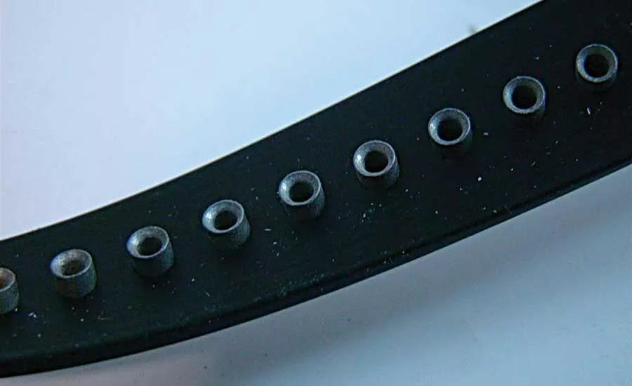

Tape feeding is fast, cost-effective and low-maintenance. Photo courtesy Atlas Copco Group

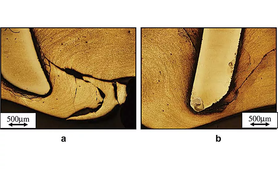

Laser-assisted SPR enables magnesium and other low-ductility materials to be riveted without cracking. In the left micrograph, cracks are evident in magnesium sheets riveted at room temperature. In the right micrograph, no cracks can be found in the same sheets riveted after a laser heated the joint area prior to insertion. Photo courtesy Swinburne University of Technology

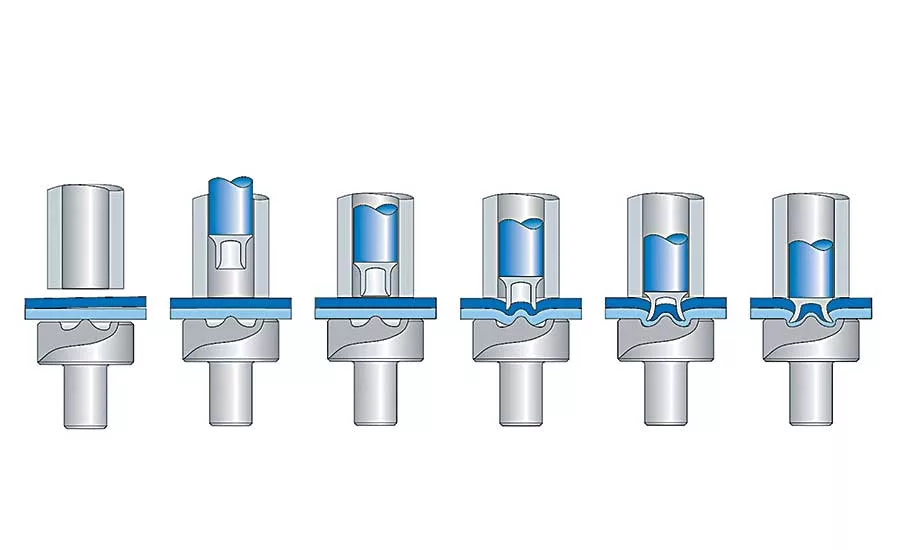

SPR is a cold joining process for fastening two or more sheets of material. During assembly, the rivet is driven into the material stack at a controlled force, piercing the top layer or layers. The rivet radially expands into the bottom layer or sheet, under the influence of a die, forming a strong mechanical interlock. The rivet does not break through the last material. From start to finish, installation takes 1.3 to 3 seconds.

“The biggest difference in the past 10 years has been the declining use of hydraulic actuators,” says Salisbury. “Most manufacturers now favor servo technology to install their rivets. With servo technology, you can use very accurate encoders to tell you if you’ve put the right rivet in the right place at the right time. These systems can tell you instantly when something goes wrong. Servo technology is also more energy-efficient.”
Assemblers also have several options for feeding fasteners to the rivet setter. Tape feeding is fast, cost-effective and low-maintenance. With a blow-feeding system, rivets are supplied from a remote hopper and blown through a tube to the rivet setter. Single- and dual-feed systems are ideal for high-volume applications. Magazine feeders are located directly on the riveting equipment. Rivets are supplied to the tooling via gravity. These systems provide fast cycle times and greater freedom of movement for the rivet setter.
Which to use depends on the application. “It boils down flexibility,” says Salisbury. “Actual feeding times are about the same. A tape feeder has fewer moving parts. It’s more robust and easier to maintain. However, when the tape runs out, someone has to enter the cell to change reels. Blow-feeders and magazine feeders can be filled from outside the cell.”

Another variation on the process is laser-assisted SPR. Developed by researchers at Swinburne University of Technology in Hawthorn, Australia, laser-assisted SPR enables magnesium and other low-ductility materials to be riveted without cracking.
Cracking of magnesium is due to its poor ductility and low formability at room temperature. These properties are inherently related to the hexagonal lattice structure of the metal. However, cracking can be prevented by heating the magnesium and increasing its plasticity by activating additional slip systems in the crystal structure, according to Yvonne Durandet, Ph.D., senior lecturer in advanced manufacturing at Swinburne and leader of the project.
