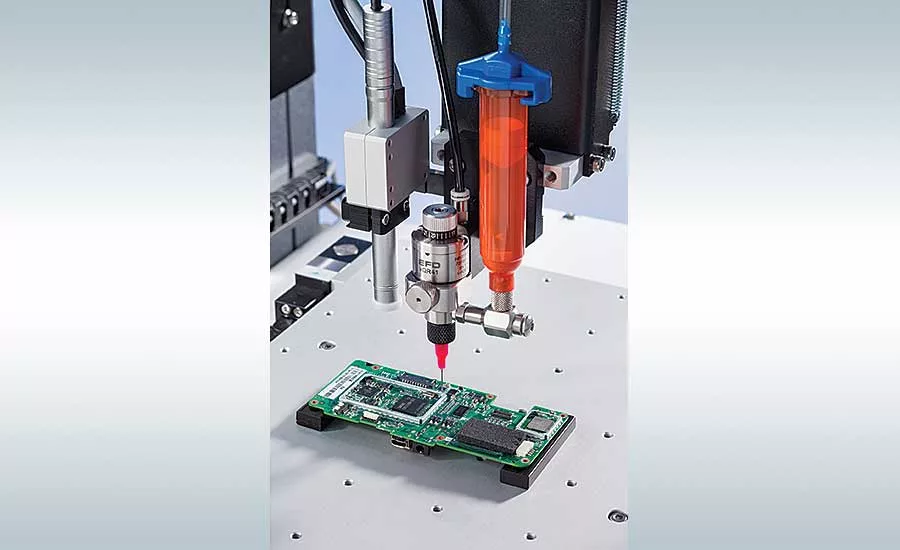

There are two basic types of micro-dispensing techniques: classic, needle-based, contact dispensing and noncontact jet dispensing. Although contact dispensing is still the predominant technology, it is slower than jetting technology, particularly when dispensing on irregular substrates. While the best method is ultimately determined by the material and application, high-speed jetting technology is gaining traction over needle-based contact dispensing for many automated dispensing processes.

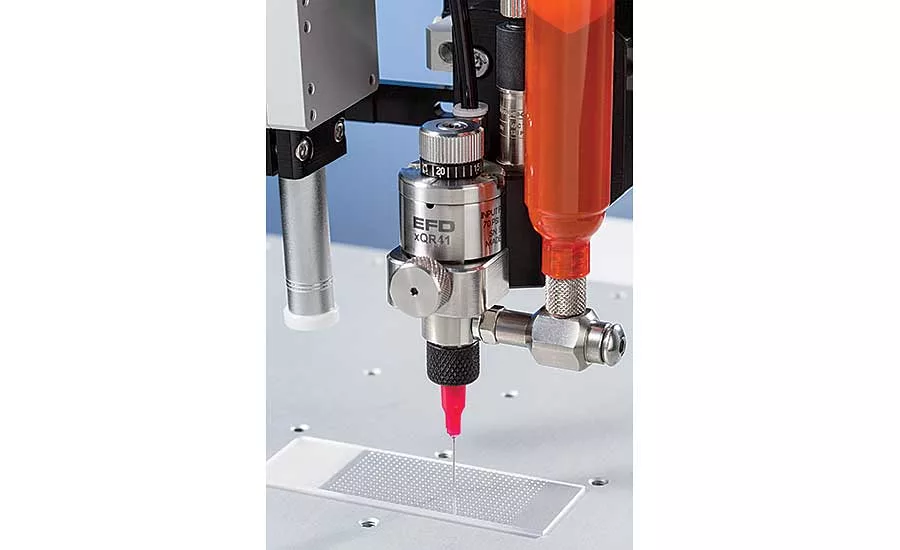

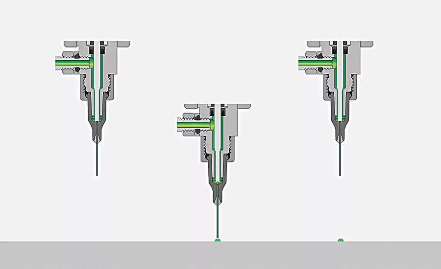

In contact dispensing, the fluid drop forms at the exit of a nozzle and is deposited on the substrate by contact while the drop is still on the nozzle.
Contact dispensing frequently relies on the time-pressure method. The amount of fluid dispensed depends greatly on the time the valve is open and amount of air pressure applied to the fluid reservoir. The amount of fluid dispensed may vary from deposit to deposit, for example, if the shop air pressure fluctuates.
Contact dispensing can also rely on a volumetric method. Here, the volume of fluid dispensed remains constant. However, there can be repeatability issues when fluid gets sucked back into the dispense tip and dispensed with the next deposit.
The benefits of contact dispensing are the versatility to dispense virtually any type of assembly fluid; easier and shorter time to set up and program; and reduced risk of creating stray droplets on the substrate.
Contact dispensing also has disadvantages, such as:
  • slow dispensing rates due to Z-axis movement, typically up to about 300 deposits per minute.
  • the substrate has to be touched to dispense the fluid, which can potentially damage the substrate.
  • the dispensed fluid is not always precisely in the expected place.
  • fluid deposit amounts are difficult to reproduce.
  • residual material can adhere to the tip, which can affect repeatability.

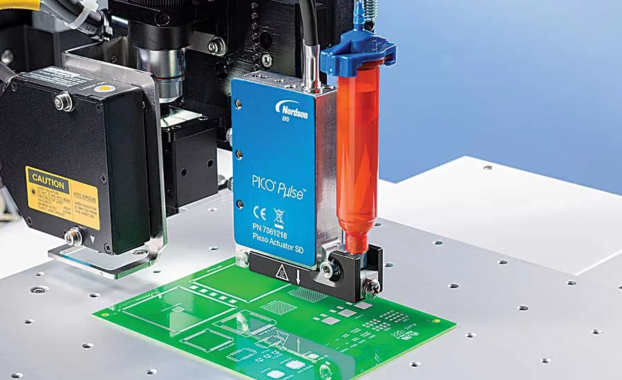

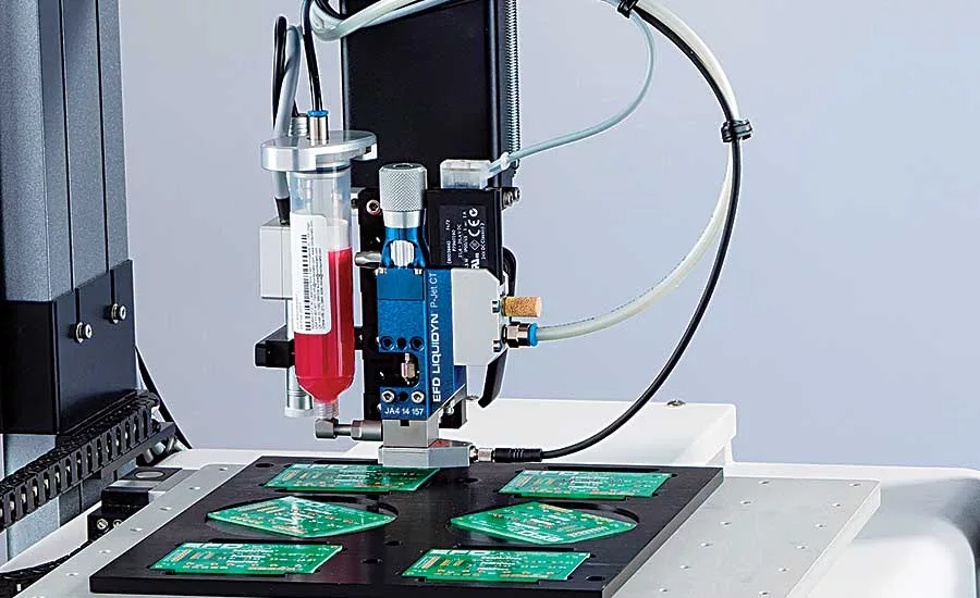

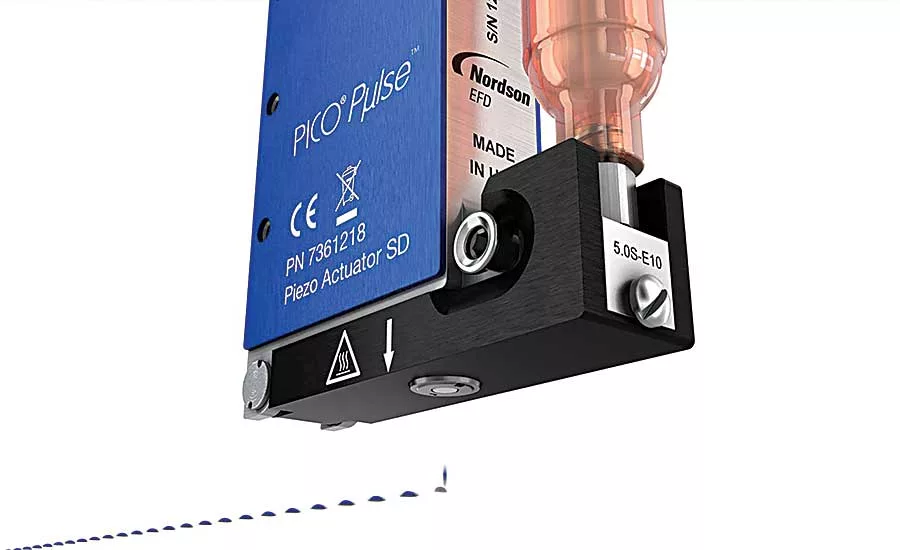

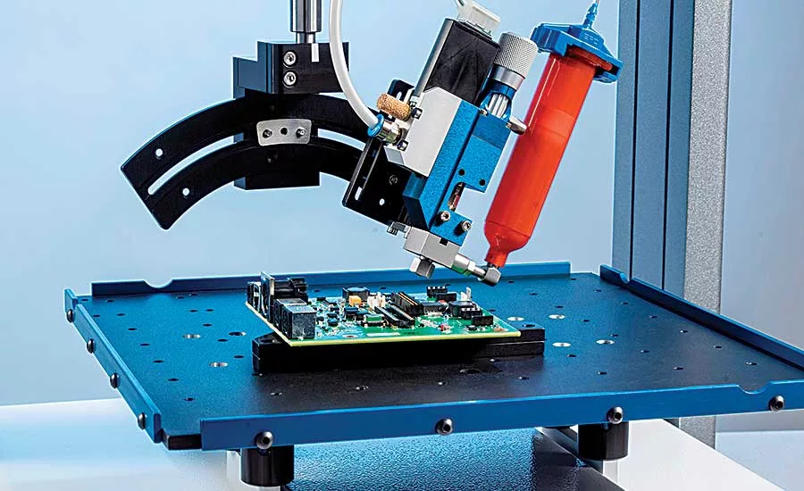

High-speed jetting is noncontact—the jet valve never contacts the product or substrate surface. As a result, it can be used in a wider variety of applications that otherwise would require a Z-axis system with height-sensing and positioning functionality. These features also provide advantages in dispensing speed and agility, dot capability and quality, maintenance, throughput, and cost of ownership.
High-speed jetting is made possible by piezoelectric technology, which can achieve extremely fast open-and-close cycles that eject, or “jet,” fluids onto a substrate. Jet valves can dispense fluids at speeds at up to 1,000 hertz.
Piezoelectric technology works like this: When pressure is applied to certain materials—such as layered structures of specialized lead zirconate titanate (PZT) ceramic stacks interleaved with electrodes—it creates voltage. Conversely, when voltage is applied to PZT, the material changes its shape. In the case of piezoelectric jet valves, voltage is applied to a piezoelectric actuator inside the valve. The voltage causes a bulk change in the ceramic’s length, allowing the actuators to be used for fast, high-force, real-time position control at the nanoscale level.
The benefits of jetting include:
  • Highly precise, repeatable deposits, independent of part topography or tolerances.
  • Continuous dispensing speeds of up to 1,000 deposits per second.
  • Dispensing from any direction, including horizontal and upside down.
  • Deposit tolerances as small as ±1 percent.
  • No damage to the substrate or dispensing tip, since there is no contact with the substrate.
  • Laser-based light barriers can count every deposit jetted—adding a level of process verification and quality control not possible with contact dispensing.
  • Jet valves can create patterns not possible with needle dispensing.
The disadvantages of jet dispensing include:
  • Larger deposits when compared to needle contact dispensing—dots as small as 0.3 millimeter in diameter vs. 0.05 millimeter in diameter with contact dispensing.
  • Some fluids, such as certain particle-filled and highly abrasive fluids, cannot be jetted.
  • Possibility for satellites or splashing can be greater than with contact dispensing, requiring time to adjust dispensing parameters.
