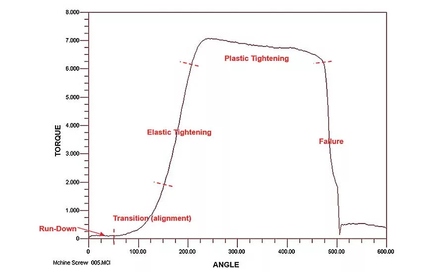

Plotting a torque-angle curve for a series of run-downs can help engineers set a torque specification for an application. Illustration courtesy Peak Innovations Engineering

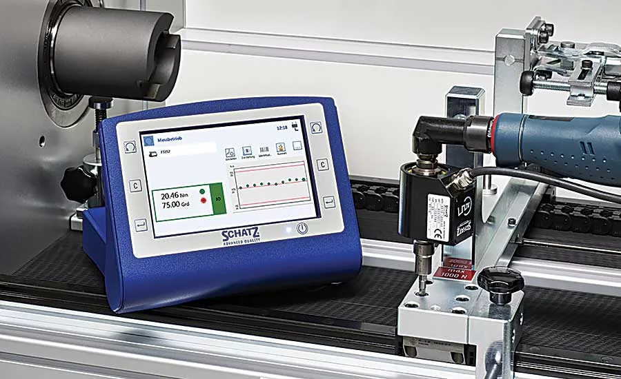

Test equipment like the SCHATZ-INSPECTpro enables engineers to determine specifications for torque and angle. Photo courtesy Kistler Instrument Corp.

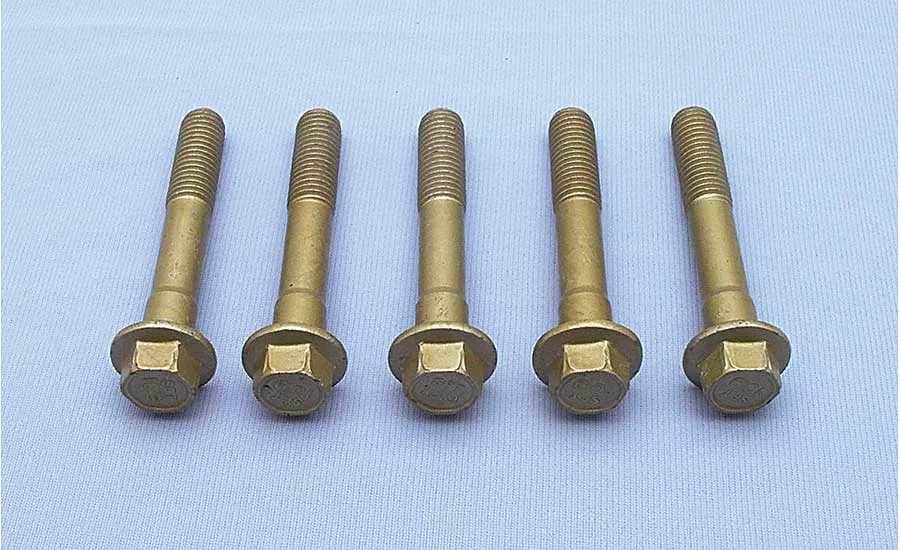

Because they affect friction, platings, coatings and lubricants have a significant influence on the torque specification. Photo courtesy NOF Metal Coatings North America Inc.

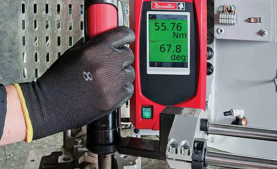

Regardless of test method, tests should be run using actual production parts. Photo courtesy Desoutter Industrial Tools

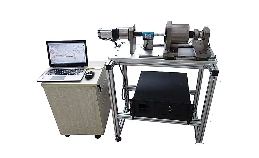

The UNIVER TOK-3001 torsion testing machine is used to verify the suitability of high-strength bolt, nut and washer assemblies for a particular application. Photo courtesy Univer Technologies Group

“K is your friction variable,” explains Avellon. “It’s a constant, but it’s a constant variable, because K is related to finishes like a black oxide or zinc plating. Are you using moly lube or copper anti-seizing lubricant? Even threadlockers can act as a lubricant initially.”
The most commonly used K factors arc 0.2 for plain finished bolts, 0.22 for zinc-plated bolts, and 0.1 for waxed or highly lubricated bolts. For a more accurate estimate of the nut factor, engineers can set up a standard fastening test to solve the equation for K.

The best way to develop a torque specification is through testing, argues Archer. The reason to do testing is that friction, run-down speed, part tolerances and other variables can significantly influence the relationship between torque and clamp load.
Two types of tests can be run to determine a torque specification: measuring torque and angle to failure and measuring torque and angle to a specific tension. “Torque-angle to failure is simpler. You need less complex equipment…but it’s probably not as accurate,” says Archer. “Torque-angle to tension is more accurate, but it requires some means of measuring either bolt tension or clamp load.”
In either case, the goal is to find a torque value that applies the most clamp load on the joint without the risk of tightening the fastener past its yield point or, worse, its breaking point.
Regardless of test method, tests should be run using actual production parts. “Don’t use prototypes, because they tend to made with different processes, materials and finishes,” advises Archer. “And, you should never reuse the bolts, because the whole point of testing is to understand the frictional characteristics of the assembly. If you reuse a bolt, you will get different characteristics each time.”
The number of run-downs needed to determine a torque specification varies. “For practical reasons, that number is influenced by the value of the parts, because at least some of the parts are going to be destroyed in the process of testing,” says Archer. “A common average is a dozen run-downs. A typical range would be six to 24 run-downs.”
In a torque-angle to failure test, engineers perform several run-downs, plotting torque vs. angle of rotation, and tightening the fastener until it fails. The goal is to find the yield point of the fastener.
Every fastener has a certain amount of elasticity as it is stretched. If the load is removed and the fastener is still within its elastic range, the fastener will return to its original shape. However, if the fastener is tightened past its yield point—past the elastic range and into the plastic range—it will no longer return to its original shape if the load is removed. The fastener is permanently elongated. Tightening the fastener past this point will, ultimately, cause it to break.
The installation torque specification would then be some percentage—perhaps 75 to 85 percent—of the average torque value when the fastener reached its yield point, plus or minus two or three standard deviations, Archer explains. Alternatively, the installation torque could be set at a smaller percentage—say, 60 percent—of the average torque value when the fastener failed.
Measuring torque and angle to a tension requires a load cell, a strain-gauge bolt, or an ultrasonic sensor. “The benefit of the ultrasonic method is that there’s no functional change to the joint. You’re not modifying the bolt or adding an extra part to the joint, so there’s no risk that the measurement method altered the test results,” says Archer.
An ultrasonic sensor measures bolt tension in real time. By establishing a fixed acoustic path between the sensor and the fastener, there is no measurement variation due to coupling between the sensor and bolt. Ultrasonic technology also allows long-term monitoring of joint tension to asses stability in use or after dynamic testing.
The torque-angle to tension test is performed in the same way as the torque-angle to failure test. Sample joints are tightened to the yield or failure point of the fastener. In this case, however, engineers are looking for torque that produces a specific clamp load.
