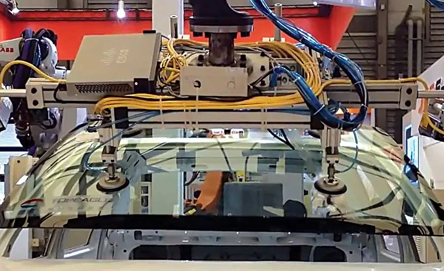

Bluewrist Inc. has developed an advanced 3D machine vision system to improve robotic insertion of front and rear windshields. Photo courtesy Wuhan TopEagle
Sensors Make Robots Smarter When Inserting Vehicle Windshields

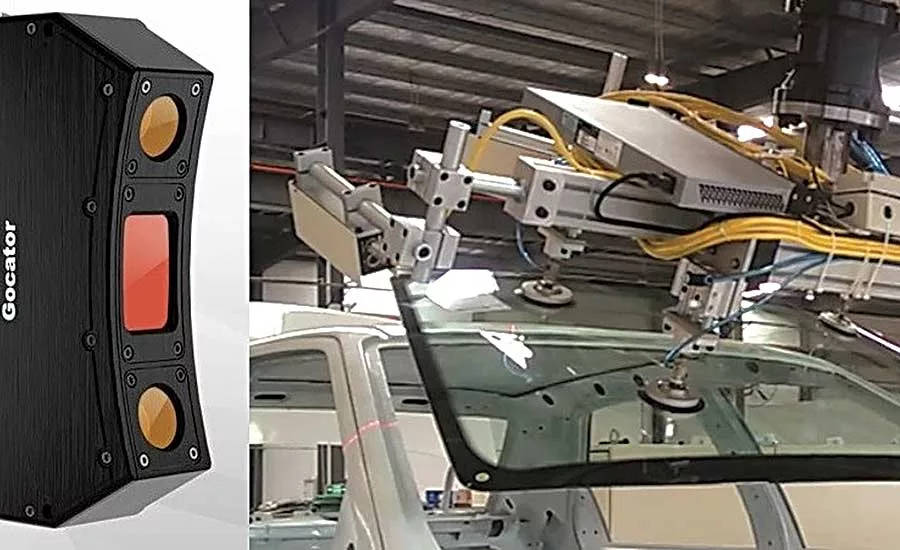

After a six-axis robot moves the windshield to a predetermined insertion point, sensors project red laser lines across the four edges of the windshield and autobody aperture. Photo courtesy Wuhan TopEagle

Systems integrator Bluewrist Inc. recently developed an advanced 3D machine vision system to improve robotic insertion of front and rear windshields. The system consists of Bluewrist’s proprietary EzRG robot guidance software and four Gocator 2300 series 3D smart sensors mounted on the robot’s end effector. Made by LMI Technologies Inc., the sensors are immune to robot movement and vibration.
On the assembly line, a large six-axis robot picks up the windshield from a fixed location using suction cups (that extend from the effector) and moves the glass to a predetermined insertion point. There, the sensors project red 635-nanometer laser lines across the four edges of the windshield and
auto-body aperture.
After reflected laser light is digitized by a camera embedded in each sensor, built-in measurement tools determine the X, Y and Z coordinates of the windshield and send this data to an external Advantech PC equipped with EzRG software. Within 0.5 second, the software calculates transformation data in six degrees of freedom and sends the results to the robot controller.
The robot uses the calculated transformations to guide the windshield into position on the aperture and insert the glass. Guidance accuracy is ±0.2 millimeter. The system’s high accuracy and speed also make it effective at installing vehicle hoods, trunk lids and doors.

Gocator smart sensors perform 100 percent noncontact product inspection at scan rates up to 32 kilohertz. They accurately measure all colors (including painted surfaces) and produce high-resolution images at distances up to 2 meters.
Compact and rugged, the sensors easily mount on the end effector without interfering with other components. They fit in small spaces, and their light weight does not add significant mass to the effector. The sensors integrate seamlessly with robotic machinery, and can be set up and controlled from a Web browser.
