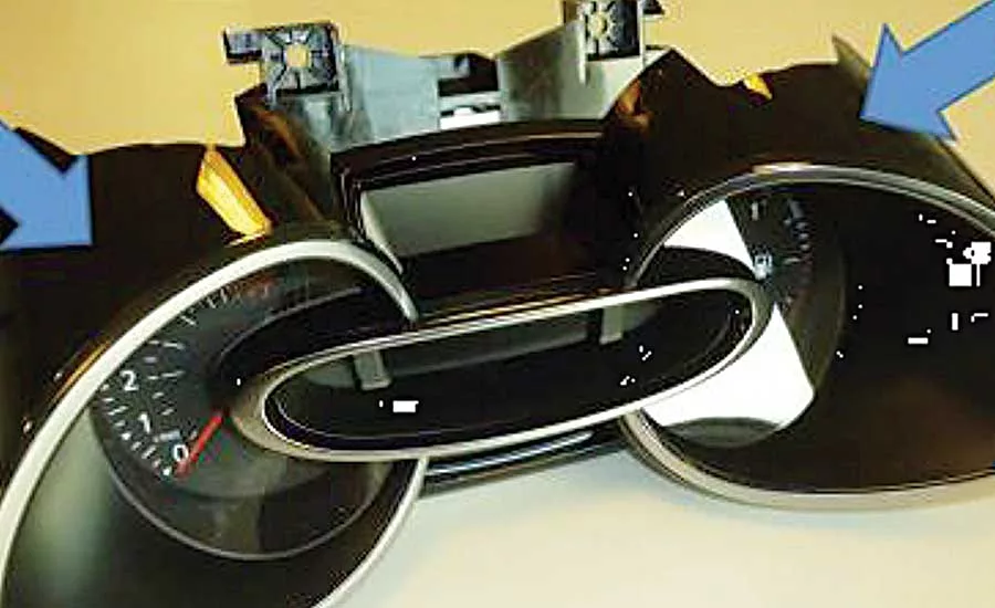

The shell of this automotive dashboard cluster is molded from Durabio, a bio-based polycarbonate derived mainly from plant-based isosorbide. Compared with conventional polycarbonate, Durabio features excellent optical properties and scratch resistance. Photo courtesy Mitsubishi Chemical Corp.

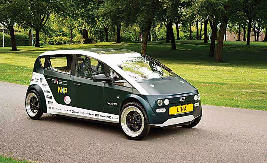

In January 2017, students from Eindhoven University of Technology in the Netherlands unveiled the world’s first car made almost entirely from bio-based materials.
Dubbed “Lina,” the four-seat electric car weighs just 661 pounds. The chassis and body were built from a honeycomb core made from polylactic acid (PLA)—a bioplastic derived from sugar beets—sandwiched between sheets of a flax-based composite material. The structure has a similar strength-to-weight ratio to that of fiberglass.
“Only the wheels and suspension systems are not yet of bio-based materials,” says Yanic van Riel, one of the students who worked on the project.
“Car manufacturers opt for lightweight materials, such as aluminum or carbon fiber, to create lighter, more efficient cars,” he adds. “However, processing of these materials requires five to six times more energy than steel, the material which they replace.”
Lina is powered by two DC motors and three lithium-ion battery packs. It has a top speed of 50 mph and maximum range of 62 miles on a full charge.
In response to the car-sharing trend, near-field communication (NFC) technology has been incorporated into Lina. Drivers gain access to the car using a smartphone or a card with an NFC chip. The car will recognize users by their unique identification codes, and activate their personal user settings, such as playlists, frequent destinations or telephone contacts.

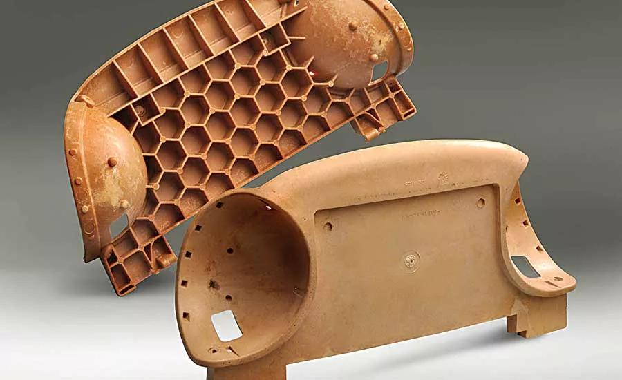

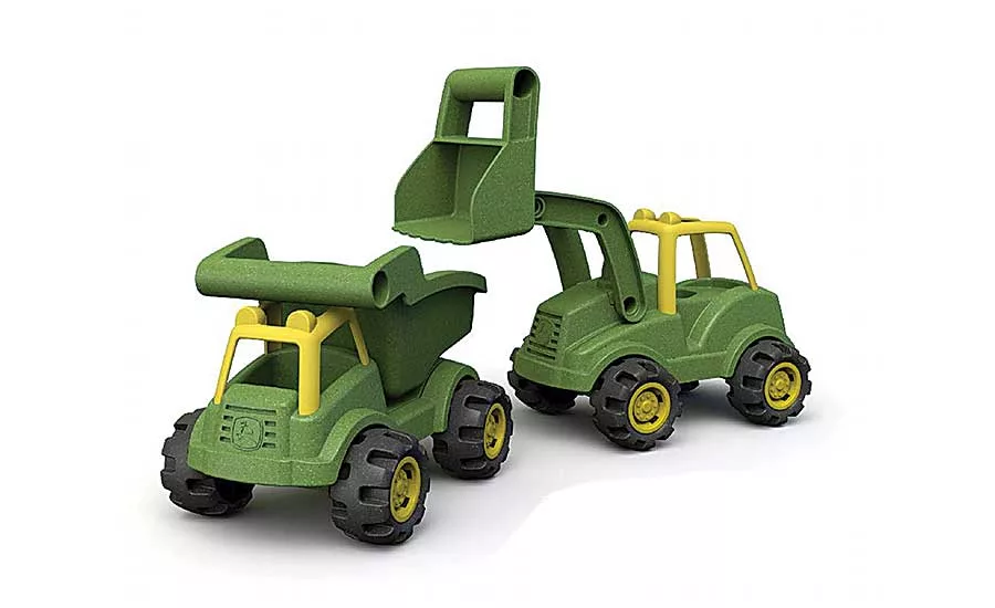

Then there are biocomposites: petro-based plastics or bioplastics reinforced with fibers derived from renewable plant resources—such as flax, hemp, kenaf or sisal—rather than glass or carbon fibers. For example, Ford Motor Co. is working with Jose Cuervo to develop ways to use agave fibers (a byproduct of tequila production) to create biocomposites for vehicles. Ford is testing the fiber-reinforced plastic for use in vehicle interior and exterior components, such as wiring harnesses, HVAC units and storage bins.
“Natural fibers have unique thermomechanical properties,” explains Grewell. “Glass fibers may be much stronger than some of these natural fibers. However, because natural fibers have a certain amount of flexibility, they tend to retain their length better as they’re going through an extruder or a mold. And, they’re much lighter than glass fibers, so there’s weight-saving potential as well.”

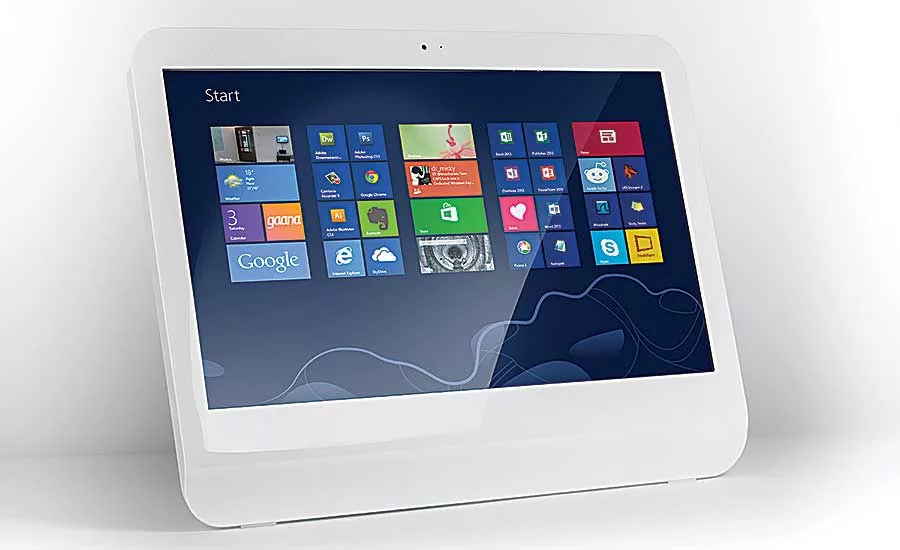

For example, Taiwanese plastic supplier Supla Material Technology Co. Ltd. has developed a PLA that has been optimized for use in consumer electronics, such as mobile phones, laptops and game consoles. Contract manufacturer Kuender Co. Ltd. is using the material to produce the plastic housing for a tablet computer. White in color with a high-gloss finish, the plastic provides high dimensional stability, which allows for tight tolerances during molding.  It was also formulated to resist impacts, scratches and heat. The latter characteristic was a key development: In the past, a lack of heat resistance has limited the suitability of bioplastics for consumer electronics.
