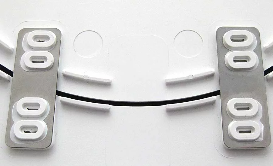

Staking can join a wide variety of materials to plastic components or housings, including metal shims or hinges; plastic keys or buttons; filters, cloth or insulating materials; printed circuit boards; sensors; and fragile glass and ceramics. PHOTO COURTESY EMERSON

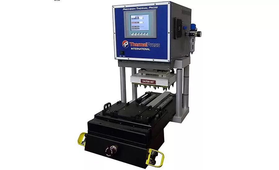

Hot-tool staking keeps the heat localized to the post, and it’s particularly good for glass-filled plastics. PHOTO COURTESY THERMAL PRESS INTERNATIONAL

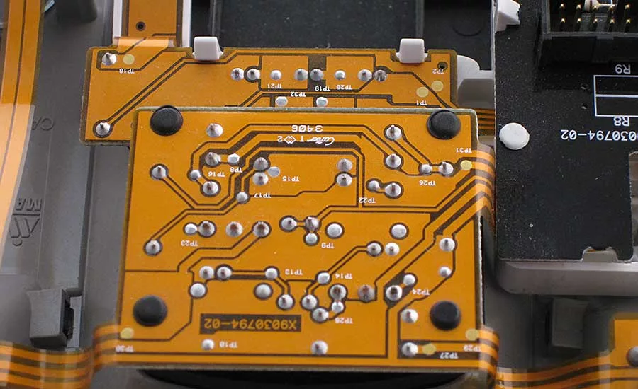

With staking, the base part must be made of a formable thermoplastic, but the entrapped part can be made of any material, like this flex circuit. PHOTO COURTESY EMERSON

Staking is ideal for assembling plastic parts. It’s quick and inexpensive. It can join dissimilar materials. It eliminates the cost of fasteners and adhesives, and it allows engineers to loosen the tolerances for molded parts.
In staking, a part with one or more holes in it is slipped over corresponding posts on a base part held in a fixture. Then, a tool mounted on a press comes down, deforms the posts and traps the top part tightly against the base. The tool applies energy to the posts to melt the plastic. The process is used to assemble small products, such as printer cartridges, and large parts, such as automotive interior components.
The base part must be made of a formable thermoplastic, but the entrapped part can be made of any material: sheet metal, FR4, glass, rubber, cloth, filter material, thermoset plastic or another thermoplastic.

One option is to melt the post directly with a heated tool. The post melts as the hot tool presses down on it. After the post has been formed, a shot of compressed air is blown onto the tool for 1 to 2 seconds to cool it down slightly. This ensures a clean release from the part and prevents the plastic from springing back to its original shape. Total cycle time varies from 6 to 10 seconds.
Hot-tool staking keeps the heat localized to the post, and it’s particularly good for glass-filled plastics. In addition, a large number of posts can be formed simultaneously, and the posts do not have to be located in the same plane.
