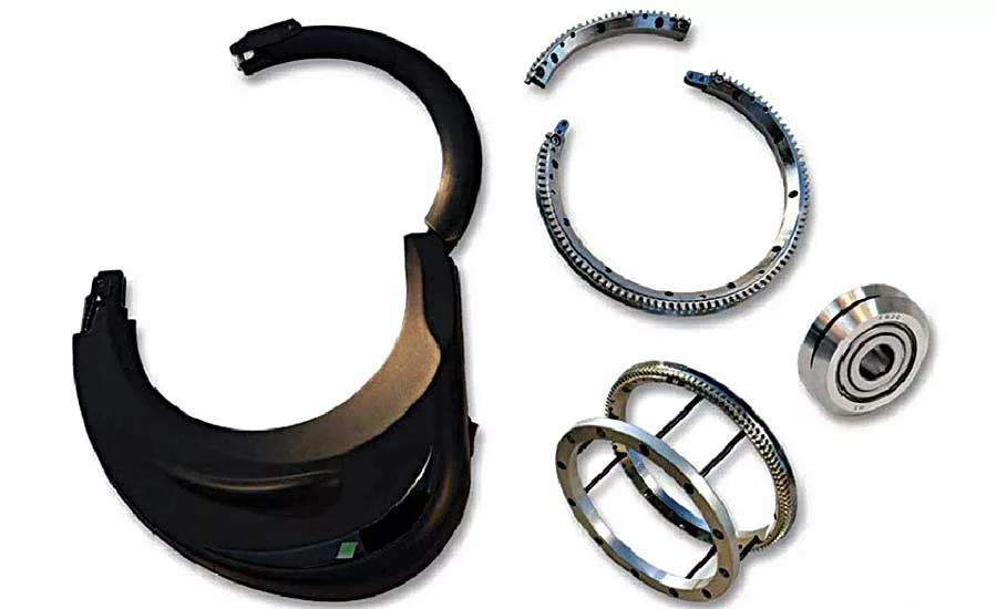

The OnTrac2’s mechanical drive unit mounts just below the steering wheel of any agricultural tractor, sprayer, spreader and combine. Photo courtesy Bishop Wisecarver Group

Engineers at Freemont, CA-based AgJunction (formerly AutoFarm Novariant) faced a different challenge several years ago. They needed a bearing durable enough to handle the high torque of a mechanical drive unit that powers a GPS-assisted device (OnTrac2) for steering agricultural equipment. The bearing also had to smoothly traverse joints, be quiet and reliable, and withstand a high volume of dust and temperature variations.
AgJunction selected size one and two DualVee guide wheels for the application. The wheels ride on the edge of a custom-made ring in different size drive units, which easily mount just below the steering wheel of any agricultural tractor, sprayer, spreader and combine. Once in place, the hands-free device automatically steers the vehicle so the operator works the field more efficiently and accurately. In addition, the OnTrac2 eliminates skips and overlaps, and reduces fuel and material consumption, and operator stress and fatigue.
