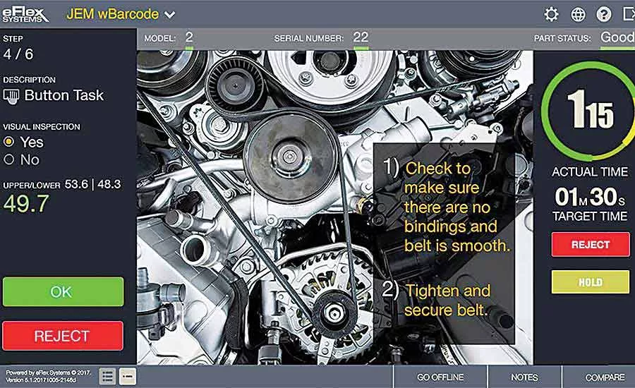

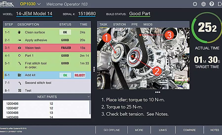

Instructions should not only allow user navigation for help but more importantly follow users as they work through station processes. As team members complete a task, the next instruction could show with a button. Operator displays could be set up as a multi-task view or single task view. However, more capable systems should also allow the instruction to sequence with timed steps or with feedback from devices such as barcodes, torque tools, vision systems, etc. The feedback should indicate pass/fail and the system should capture this data as well as task time.
Integrate with ERP/MES/BOMs to determine build components and variables to ensure proper information is shown
Manufacturers do not typically have the luxury of making just one model or product.  At times there are thousands of options.  With that, work instructions should react as BOMs change for a particular model or serial number.  Instructions from one to the other can be very different or require subtle changes which are easy to miss during production.  Real-time, work instruction software should be capable of displaying individual tasks with different instructions based on a BOM or model difference.  I would suggest this is one of the most important aspects of work instructions.  Team members typically understand processes after some time. However, mistakes are often made with changeover or when individual serial numbers contain many options.  From this, the software should be capable of easily pulling from an ERP or MES scheduling system.

As users begin to use work instruction software and particularly in real-time with the process, they typically realize the need to do more error proofing.  Devices such as torque tools, barcode readers, scales, gages, vision systems, etc. should interlock to the software to control the sequence, gather and present data, and control the tool based on product variation.
