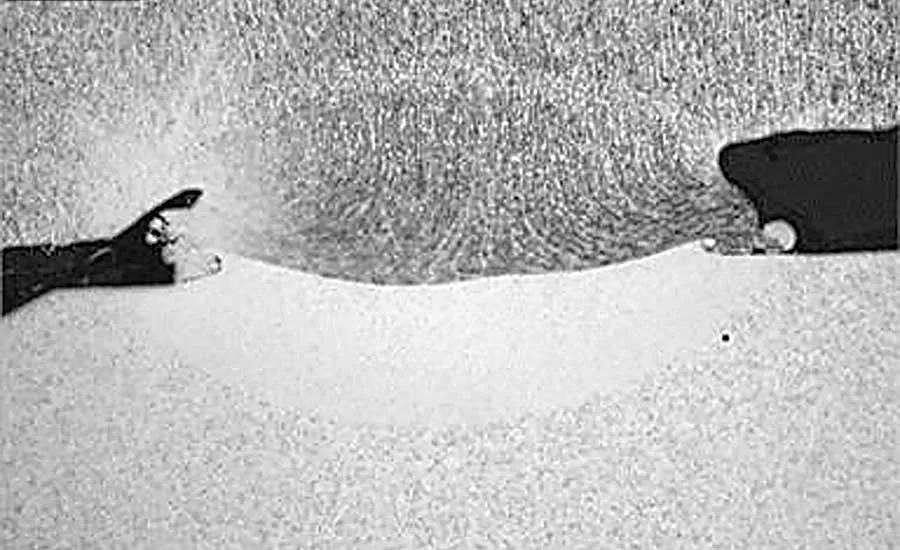

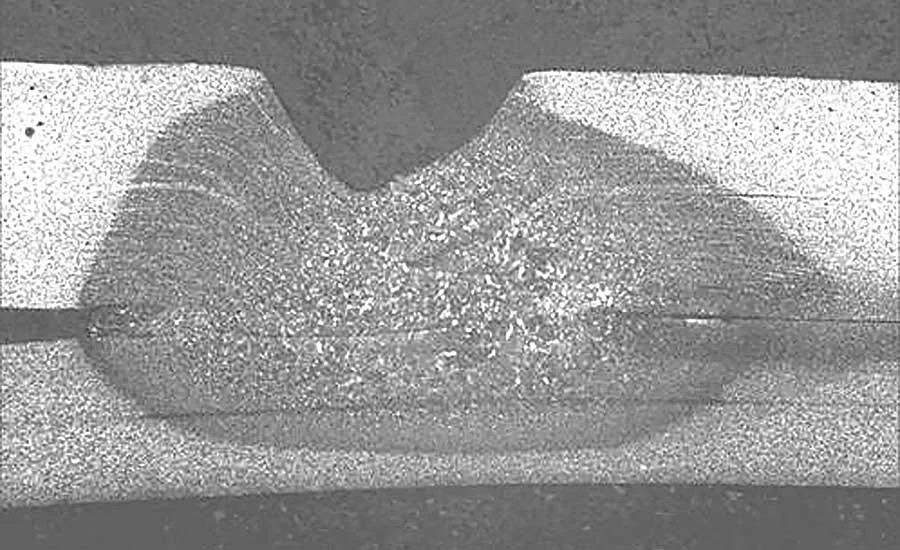

Projection welds can form in different ways. In an embossed projection weld a fused nugget forms.
Resistance Projection Welding
In an annular projection weld, solidstate bonding develops. Photos courtesy AET Integration Inc.

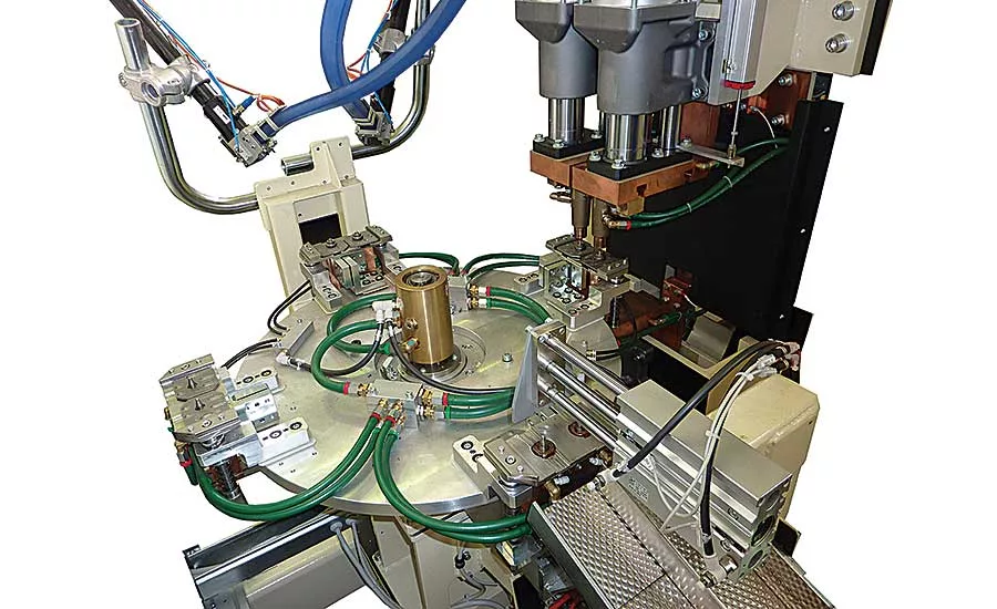

Fast cycle times mean that the resistance projection welding process can be integrated into automated assembly systems. Photo courtesy GEM Srl

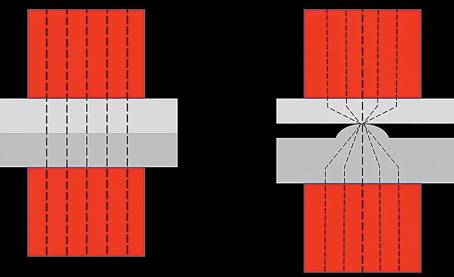

The key to RPW is that energy is focused through a dimple or other projection on one of the pieces being welded together. The projection side of one piece is mated against the other piece, and the two pieces are placed between two electrodes. As energy is applied through the electrodes, the projection softens, as does the flat metal opposing the projection. Simultaneously, the electrodes apply force, pushing the collapsing projection into the other piece, which closes the gap between the two pieces and creates a weld nugget.
In contrast, in conventional resistance welding, energy is not diverted to a focused point but instead flows straight across both pieces of metal from one electrode to the other, creating a larger weld area and larger nugget.
“The main benefit of RPW over regular resistance welding is the ability to focus the welding heat at a specific location,” explains Girish P. Kelkar, Ph.D., the founder of welding consulting firm WJM Technologies. “If executed properly, it may lead to less distortion and more consistent welding.”
A long-established welding process, RPW is commonly used to weld either parts of different sizes, such as flanges to sheet metal, or parts with different material properties, such as copper to steel.
RPW creates heat balance at the weld interface of dissimilar materials so that both parts get equally hot at the same time, notes Kelkar.

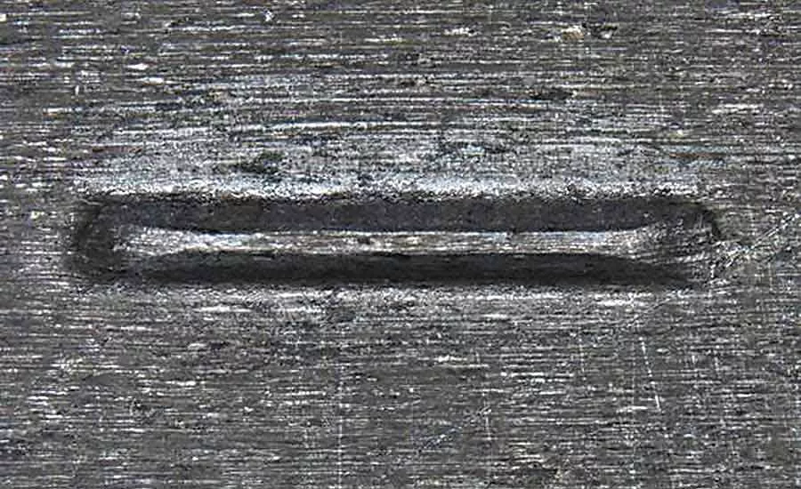

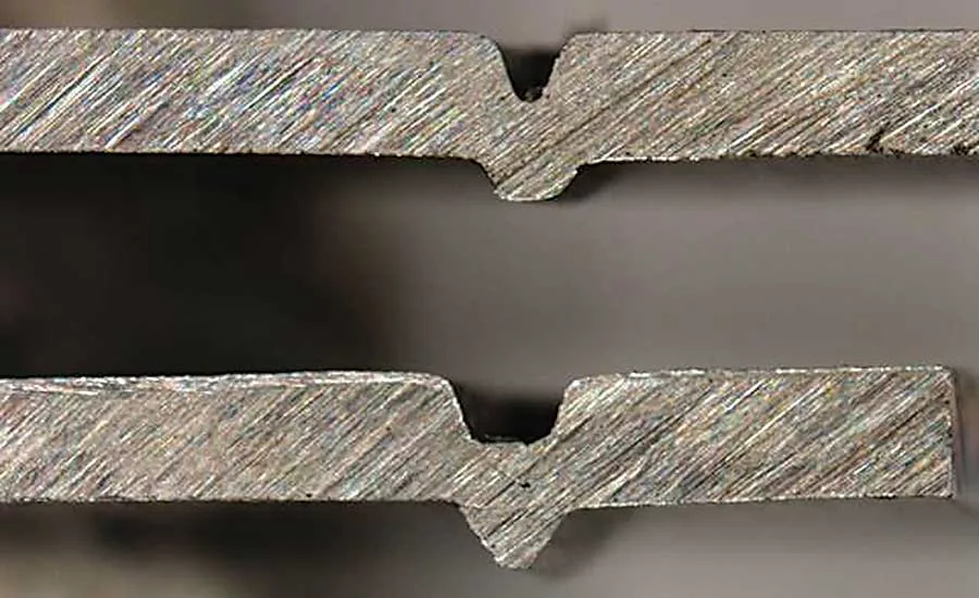

Projections used in RPW fall into four basic categories: stamped, machined, coined and corner. Stamping is used to create projections in relatively thin materials like sheet metal or foil, Kelkar notes. Machining and coining are used for thicker metal. With corner projections, an edge of one part is mated against an edge of the other part, using the natural shape of the parts to form a projection.
When welding material with different properties, the projection is usually placed in the more conductive metal. “If, for example, you’re welding copper to steel, you would put a projection in the copper,” Kelkar says.
