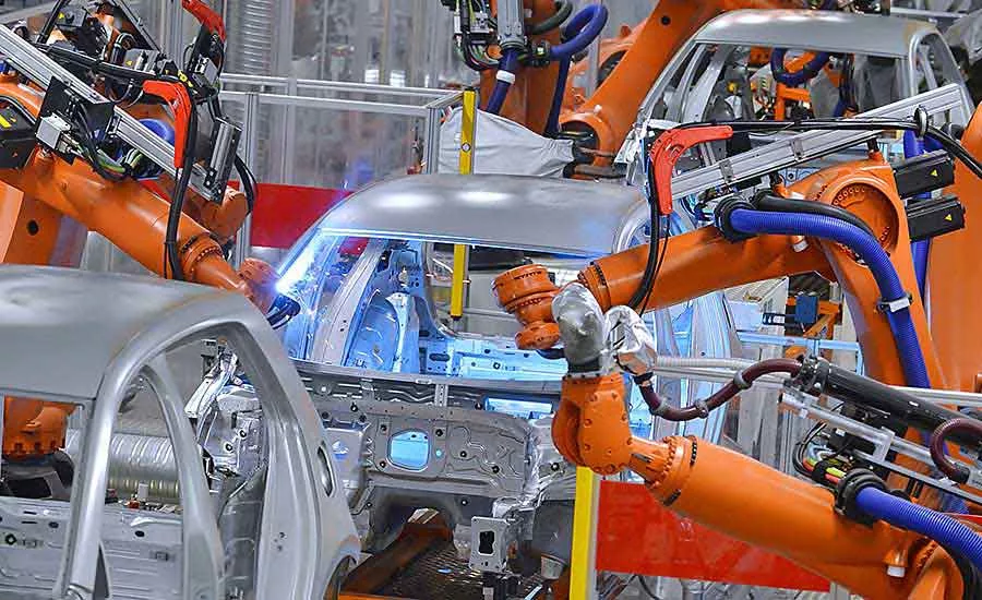

Bosch Rexroth has developed more sophisticated adaptive resistance control systems that incorporate advances in software and dual-processor architecture. Photo courtesy Bosch Rexroth Corp.

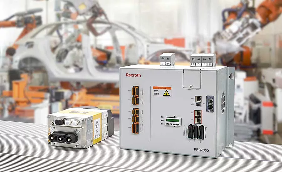

The new PRC7000 adaptive resistance welding platform expands the number of heat blocks available so that welding system programmers can customize the current waveform for each weld. Photo courtesy Bosch Rexroth Corp.

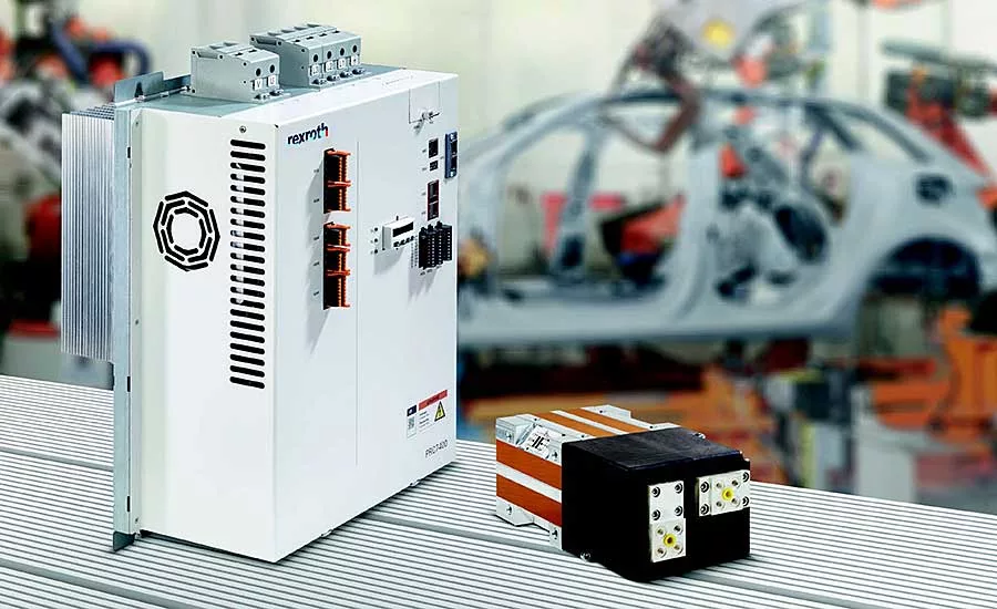

The PRC7000 can store up to 10,000 programs, making it easier for manufacturers to shift welding operations from one vehicle or model to another. Photo courtesy Bosch Rexroth Corp.

Bosch Rexroth’s introduction of adaptive control in 2012 advanced the quality and efficiency of robotic resistance welding. Using cutting-edge hardware and software, adaptive control monitors various process parameters to perfect each weld. The system samples weld parameters on a millisecond basis, compares them in real-time against a master resistance curve, and automatically adjusts the process to ensure consistent, quality welds.
However, recent trends in the automotive industry, such as lightweighting and electrification, presented challenges for this technology. As a result, Bosch Rexroth has developed more sophisticated adaptive resistance control systems that incorporate advanced software and dual-processor architecture.

The company’s new PRC7000 adaptive resistance welding control platform offers this capability. It also expands the number of heat blocks available so that welding system programmers and technicians can fully customize the current waveform for each weld. Previously, automated resistance welding platforms typically supported three heat blocks: the pre-weld, the weld itself and the post-weld. While effective, having only three heat blocks did not give welding operations the ability to create more sophisticated welding sequences that could respond better to minute variations in the parts being welded, such as specialized coatings, poor fits between two parts being welded, or changes in the amount of carbon or other trace alloys in newer high-strength, lightweight steel alloys.
The PRC7000 can store up to 10,000 welding programs that can be easily selected and built via a drag-and-drop graphical interface. Engineers can create sophisticated welding sequences with 100 or more heat blocks. Through user-friendly programming tools, each heat block can be configured as needed to handle the specific weld criteria.
For example, a particular weld for a higher-strength steel might need a pre-weld at 30,000 amps to heat the steel for 30 milliseconds, then a long transition to a higher force with a lower current for 500 to 600 milliseconds to contain the material. Each part or each type of material can now have more dynamically designed welds so that manufacturers have greater freedom to control and improve welding results. Engineers can add and store as many heat blocks as needed to create the perfect weld nugget and, ultimately, the perfect weld every time.
