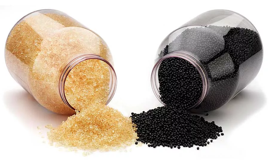

Hot-melt polyamide adhesives are delivered in granular form. Photo courtesy Henkel Corp.

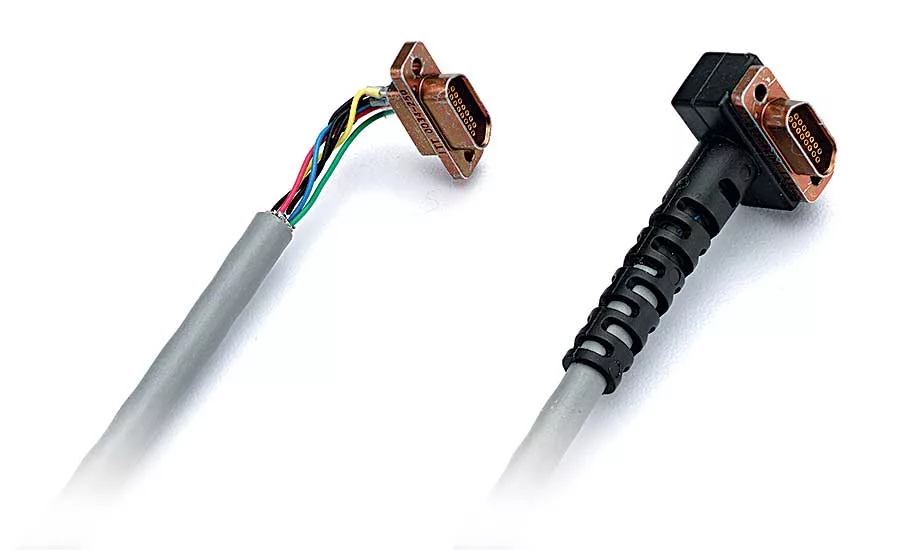

These images show a connector before (left) and after (right) application of a hot-melt polyamide material for strain relief. Photo courtesy Henkel Corp.

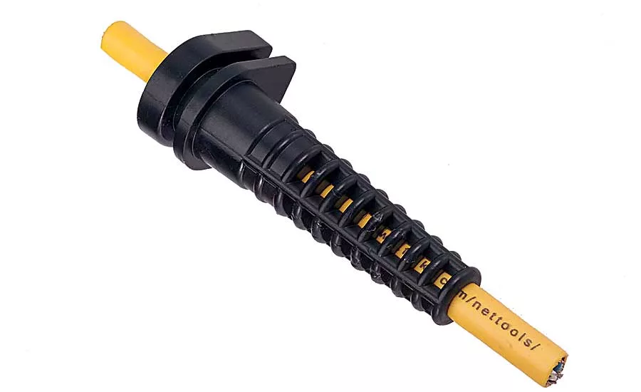

Bushing and grommets made from LPM hot-melts can replace similar parts made from rubber. Photo courtesy Henkel Corp.

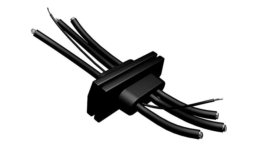

Polyamide hot-melts offer excellent thermal cycling performance and temperature resistance. Photo courtesy Henkel Corp.

Using adhesive technology, LPM creates a permanent bond with component parts. In LPM, a hot-melt polyamide adhesive in granular form is heated to temperatures between 180 and 240 C. These adhesives have no true melting point; instead, they have relatively wide softening and glass transition ranges. Once sufficiently softened, the adhesive’s viscosity hovers around 3,000 centipoise and the material is ready to be injected. The manufacturer places the component to be sealed into a specially- designed mold and the molding material is injected into the cavity, enclosing and bonding to the component. Injection pressures for polyamide LPM range from just 25 to 500 psi, much lower than the 1,500 to 15,000 psi pressures required for injection molding. This makes the process gentle enough for the most fragile parts.

Successful hot-melt molding requires parts to be completely encapsulated in the LPM material, making them impermeable to moisture and environmental contaminants. Parts should be centered in the mold to facilitate encapsulation and minimize bending during and after the cool down process. For components such as grommets that must allow bending of the cables, engineers should design the mold specifically for the part, keeping the bend away from the sealing area.

For potting connectors and switches, the LPM material over-molds the connector and the entire cable. The hot-melt protects the connector’s contacts from water, oil and other contaminants, relieves strain and stress on the cable and improves product aesthetics. LPM is more reliable than sealing with heat shrink tubing or injection molding, as the molding material forms a lasting bond with the connector or switch.

Bushings and grommets made of LPM hot-melts are often used in cable harnesses to replace rubber bushings that hold wires in position and provide strain relief. LPM bushings provide a cord grip for the cables and can be simply and quickly positioned on very complicated cable harnesses. Rather than being drawn onto complex cable harnesses like a rubber bushing, LPM bushings are manufactured-in-place in a targeted location, with the hot-melt adhering to the cables. The connection between the adhesive and the cable is watertight.
