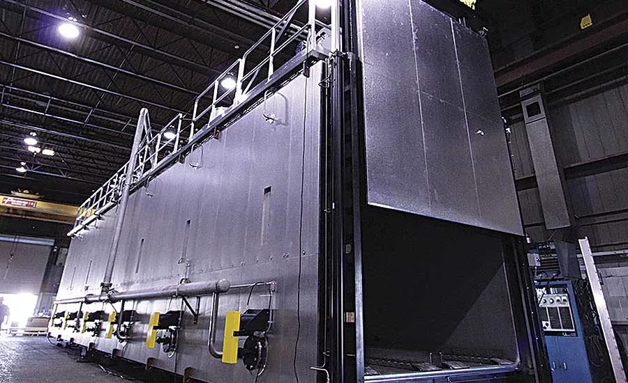

The sterilization with EO takes place in a sealed chamber. The three-phase process involves preconditioning the load, sterilization with EO, and aeration to purge the toxic gas. Photo courtesy Cosmed Group Inc.

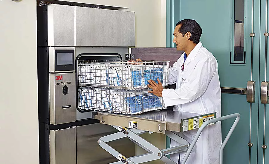

Despite being material-friendly, EO does have two minor limitations, Houghtling says. Because EO is a gas, it cannot be used to sterilize liquids, and it cannot be used on devices that are in gas-impermeable packaging.

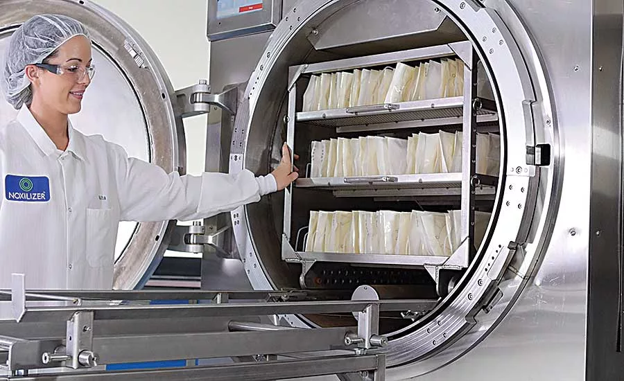

Another gas sterilant, nitrogen dioxide (NO2), is incompatible with cellulose materials, such as paper and cardboard, explains physicist David Opie, Ph.D., the senior vice president for research and development at Noxilizer Inc. NO2 also changes the chemical structure of polyurethane and nylon, as well as polyoxymethylene, which is commonly known by the brand name Delrin.

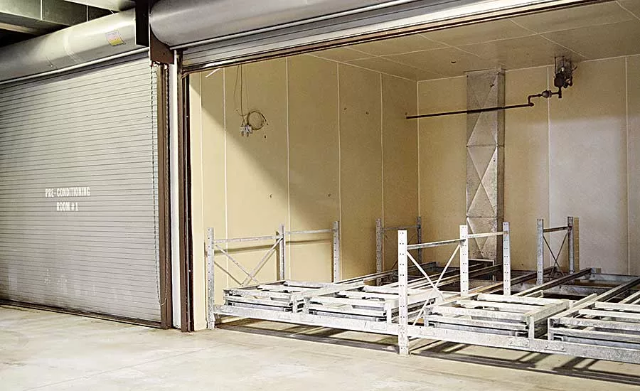

Conventional EO sterilization, for example, historically relied on a three-phase process that begins with preconditioning. Pallets of medical devices are placed in a room, chamber or cell, where they are exposed to heat and humidity for a defined period to acclimate the devices to the sterilization conditions and to make the microorganisms more susceptible to the sterilization process.
In the second phase, the pallets are placed in a sterilizer, which can range from the size of a tabletop to a full tractor trailer. The medical devices are sterilized in their final packaging, typically corrugated cardboard boxes.
In the United States, most EO sterilizers use 100 percent EO, as opposed to a blend of EO and carbon dioxide, Houghtling notes. When 100 percent EO is used, the process is done under vacuum, creating an environment that is lower than atmospheric pressure. After air is removed from the sterilizing chamber and humidity added, EO is introduced. Several hours are required for EO to permeate throughout the load and kill microorganisms to the designated SAL. EO is then flushed out of the chamber.
For EO sterilization, it’s essential that devices are packaged in gas-permeable sterile barriers. The pores in the barriers are large enough to allow EO to flow in and out but too small to allow microorganisms in. As a consequence, once EO kills the existing microorganisms on the devices, the devices remain sterile until their gas-permeable barriers are opened.
The last phase of EO sterilization is aeration to further remove EO. This is done in a room, chamber or cell with heat, but without humidity. Aeration reduces EO concentrations to or below permissible levels for the safety of both the workers who handle the devices and the patients who are treated with them.
Coming more into vogue in EO sterilization is all-in-one processing, in which all three phases take place in the sterilizer instead of in three different areas. The all-in-one process is safer for workers because they do not move the pallets until the product is nearly fully aerated. It also reduces process deviations and product damage.
On the other hand, because the entire process is executed in a sterilizer, the amount of time that the devices are in the sterilizer roughly doubles, cutting throughput in half. So to process the same volume, all-in-one processing requires roughly doubling the number or size of the sterilizers. In addition, sterilizers are much more expensive than preconditioning and aeration areas.

The phases of NO2 sterilization mimic those of EO, with a major difference being that medical devices are not sterilized in their cardboard packaging. Consequently, NO2 sterilization is more likely to be done in house than outsourced.
Opie notes that two-door sterilizers can be used to batch-sterilize medical devices in line. The devices are manufactured and packaged in sterile barriers in a clean room, moved into an NO2 sterilizer through its loading door in the clean room, sterilized, and removed through the opposite door into a normal manufacturing area to be packaged and labeled.
“You want the size of the sterilizer to match the speed of the packaging line,” Opie says. “If you have a two-hour cycle for sterilization, for example, then you need two hours’ worth of product to fit in the chamber.”

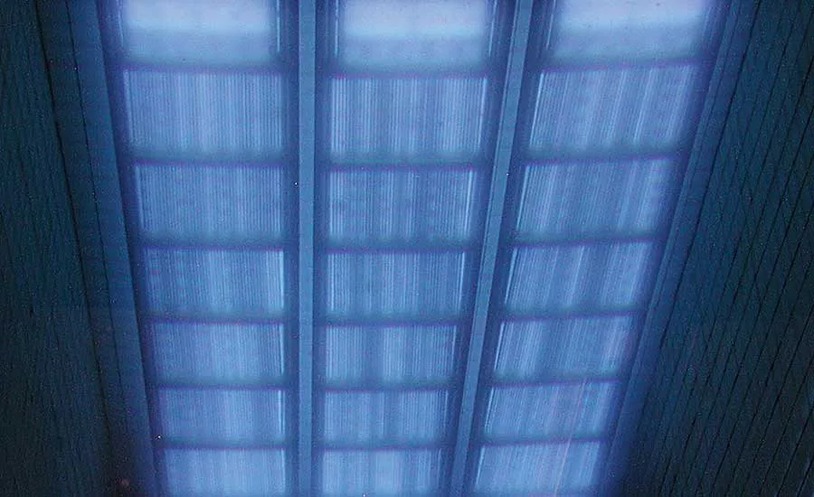

The most common source of radiation for sterilization is cobalt-60. Small rods of cobalt-60 are stacked in a column that is encapsulated by two separate layers of stainless steel. Each “pencil” of cobalt-60 is approximately 18 inches long and 0.375 inch in diameter.
Several pencils are placed in the source rack of an irradiator. As the cobalt-60 decays, more pencils are added to maintain the irradiator’s strength. Eventually, pencils are replaced either because they have decayed too much to be useful or because the source rack no longer has room for fresh pencils.
Cobalt-60 emits gamma rays at a steady rate in all directions as it decays. Consequently, products like packaged medical devices are circulated around the source rack. The gamma rays penetrate the products and damage the DNA and other cellular structures of microorganisms.

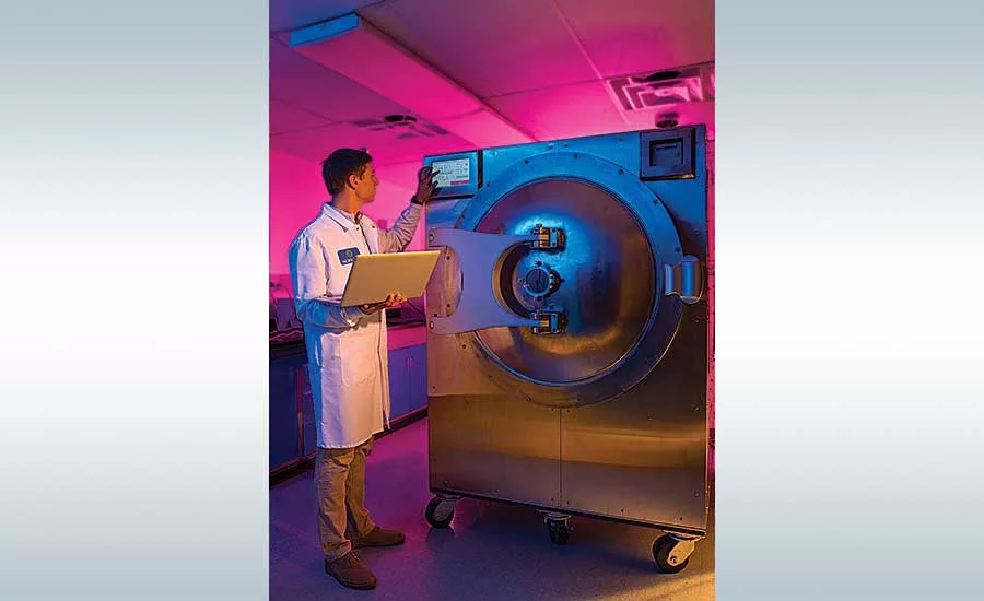

A critical advantage of NO2 over EO is that NO2 sterilization can be conducted at low temperatures, without a deep vacuum and in a relatively short time. As a consequence, NO2 can sterilize the exterior surfaces of syringes and other drug-delivery systems with minimal to no effect on the medicine in those systems.
Elastomeric closures, such as pistons in syringes and stoppers in vials, are vulnerable points in drug-delivery systems. “EO goes right through those elastomeric closures and contaminates the contents,” Opie says.
