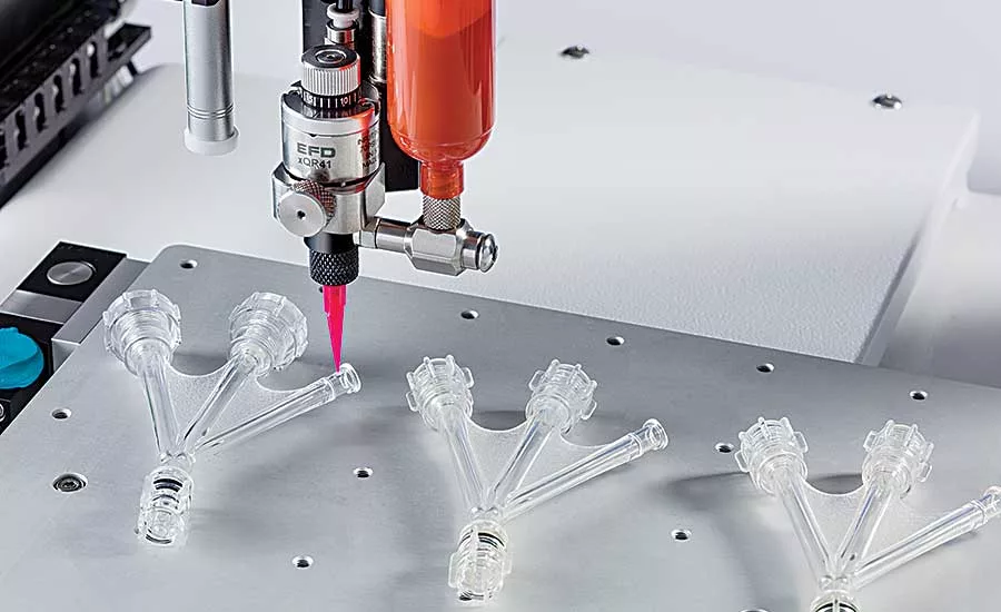

“In all dispensing applications, there is going to be some type of fluid waste,” claims Tom Muccino, sales manager at Nordson EFD. “Manufacturers can minimize that waste by using the proper dispensing components.
“For instance, if someone doesn’t use a piston inside their syringe barrel reservoir, they will leave residue on the inside walls of the device, which creates a fair amount of waste,” explains Muccino.
“Using the proper piston will wipe the inside walls clean, greatly reducing the amount of waste,” adds Muccino. “[Our] SmoothFlow pistons are manufactured with precise tolerances to the inside walls of the syringe, ensuring that 99 percent of the fluid in the syringe reservoir will be dispensed.”

According to Muccino, choosing the wrong type of adhesive dispensing components can create waste. “For example, there are a number of different pistons that can be used for any dispensing application,” he points out.
“The choice of piston an operator uses can make a big difference in the amount of waste in the application,” notes Muccino. “Using air-powered dispensers with inaccurate air regulators can contribute to the waste. Dispensers equipped with precision regulators [will produce] the most accurate dispense.”

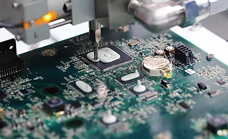

Several factors create waste in adhesive dispensing applications. For instance, a certain amount of oozing or dripping will occur after every dispense.
Another common source of waste is applying excess material to each part. That type of operator error is often associated with manual assembly applications.
“We still see customers put down ‘just a little’ more adhesive to be on the ‘safe side,’” says Patrick Kieselbach, sales manager at ViscoTec America Inc. “Human nature is to think that ‘more is better.’ That’s why automation can greatly reduce waste. It can guarantee that your dispense is going to be within ±1 percent of what it is programmed for.
“When production volumes are higher, there tends to be much less waste than with shorter runs,” notes Kieselbach. “That’s because the dispensing process is going to be much more dialed in.
“But, when you throw out a dispensing tip, there’s always going to be some material left in it,” adds Kieselbach. “Most waste, however, occurs before the point of dispense.
“One mistake that I see engineers make is using feeding lines or hoses that are too long,” warns Kieselbach. “Keeping supply lines as short as possible will help minimize waste.”

“Generally speaking, you can get more waste with a high viscosity fluid compared to a low viscosity fluid, because it can be more difficult to push thicker fluids out of a syringe reservoir while wiping the side walls clean,” says Muccino. “Materials like epoxy, silicones, greases and solder pastes can be very tacky.
“When dispensing these materials, it is important to use the proper piston inside the syringe reservoir that will not only help with accurate dispensing, but will dispense everything that is in the syringe,” Muccino points out. “A piston with wipers will wipe the inside of the syringe clean, but a flat-walled piston will leave a slight residue inside the syringe.”

“As a general rule of thumb, more waste occurs with manual dispensing applications,” claims Wagner. “With automation, you only dispense the amount that you need. It improves accuracy and ensures complete coverage. You can dial in the equipment to 0.1 millimeter dispensing accuracy and 0.02 millimeter X-Y-Z directional accuracy. Automated dispensing systems also enable continual purging at set time intervals.”
