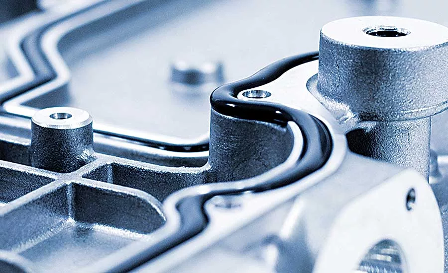

The types of materials that manufacturers dispense for assembly applications range from adhesives and primers, to threadlockers and thermally conductive gap fillers. Photo courtesy Scheugenpflug USA

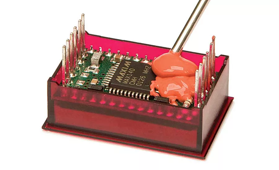

Silicone materials are used for many applications, such as potting and encapsulating PCBs. Photo courtesy EpoxySet Inc.

The types of materials that manufacturers dispense for assembly applications include adhesives, sealants, coatings, primers, lubricants, threadlockers and thermally conductive gap fillers. They are formulated with a base polymer of epoxy resin, acrylic, urethane, polyurethane or silicone, and cure upon exposure to light (UV or visible), heat, moisture or air.
“Factors like rheology, chemistry and mix ratio must be carefully considered when selecting a material for dispensing,” explains Barry Siroka, business development manager at EpoxySet Inc. “The rheology of one- and two-part materials is crucial. Newtonian materials, for example, are totally free-flowing and may need to be suck-backed in between dispensing cycles to prevent dripping.”
As for chemistry, Siroka says that certain epoxies (e.g., most imidozale curing agents), cannot be mixed in large quantities. A large reservoir, containing hundreds of grams of this material, is susceptible to an exothermic chemical reaction that releases energy by heat that causes material to gel and smoke before being dispensed. He recommends a reservoir of 25 to 30 grams. Exposing certain materials to sodium and water can also result in heat generation and unintended premature reactions.
Fillers in dispensing materials can present problems as well. Abrasive fillers can wear away the aluminum parts of dispensing equipment. If those microscopic metal particles mix with the adhesive, it can adversely affect the dispensing process.
“Achieving proper mix ratio is always a big challenge, especially for many two-part epoxies, urethanes and silicones,” notes Siroka. “If the viscosity difference between the resin and hardener is too wide, one material will run out too quickly and the other too slowly, and proper mixing won’t be possible.”
