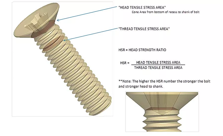

The variables in the head-to-shank juncture of a fastener that influence tensile strength can be limited to the effective geometry of the interface, while the tensile strength of the threaded portion of the fastener can be based on the effective tensile stress area of the thread itself. We must define the diameter to be used to calculate the effective tensile stress area of the portion of the fastener as it transitions from a threaded area to an unthreaded area. That “effective diameter” is different for a given thread geometry (10-32UNJF, for example) when it transitions to an unthreaded shank than when it transitions from a fully threaded part to the underside of the fastener head.
In a bolt, the thread transitions to a full body diameter (0.19 inch for our 10-32 UNJF example). The result is that the weakest tensile stress area occurs at the thread pitch diameter one or two threads below the thread-to-full body transition. The thread pitch diameter is often equivalent to the blank diameter (the diameter of the unthreaded fastener before the thread profile is rolled onto the base material).
In the case of a fastener that is threaded to the head, the minimum tensile stress area often occurs in the area between the last full thread and the bottom of the head or the thread-to-head transition zone. Here, the effective tensile stress diameter may be the same as the thread pitch diameter (a minimum of 0.1658 inch for our 10-32UNJF example), or it may be slightly smaller if this area is fillet-rolled to relieve stress built up during the manufacturing process.
This is significant, because the difference in the effective tensile stress area in the head-to-shank transition will be different for a full-body bolt than for a threaded-to-the-head screw. The stress cone—or the effective cross-sectional area between the shank-to-head transition and the bottom to the internal recess—is calculated using either the larger diameter of the bolt transition or the smaller diameter of the fully threaded transition.

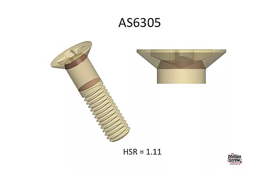

The calculation of the HSR then becomes a comparison of the effective tensile areas to the full-shank diameter for a bolt or the thread pitch area for a fully threaded screw. Ideally, the HSR will always be 1 or greater, so that a tensile failure of the fastener will always be at or above the minimum tensile strength of the thread pitch diameter. This assures that there is enough strength in the head-to-shank juncture to avoid popping the head off the fastener and failing the joint.
Figure 1 shows the tensile stress areas in the thread profile (shaded areas) and in the head-to-shank juncture area for a fully threaded fastener. Note in the head cross section that the stress area goes from the under-head diameter, which is approximately the thread pitch diameter, to the nearest point of the bottom of the recess. In this case, the recess is actually cruciform in the cross-sectional area nearest to the head-to-shank juncture. For the purpose of comparison with other fastener recess drive systems, we will ignore the minute amount of added material between the wings of the recess and only use a circular area based on the outer diameter of the wings at the cross section.

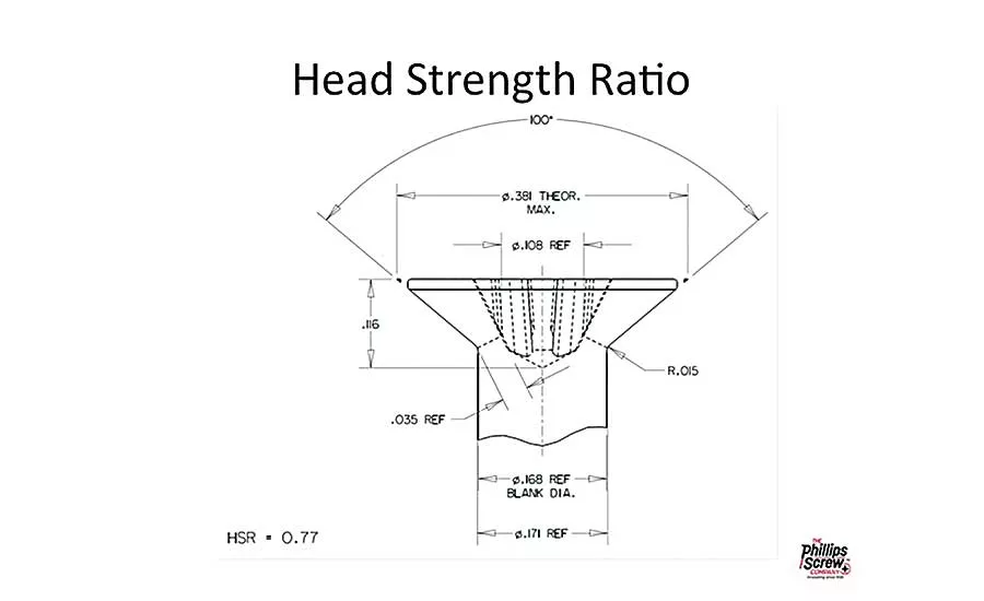

Now that we have agreed on the criteria to use for calculating HSR, it’s important to select whether the minimum or maximum of each dimensional variable should be used to determine the “worst case” scenario in which head-to-shank failure is most likely at tensile levels below those for the effective diameter of the thread pitch. We have already determined that for a fully threaded fastener, the cross-sectional area under the head is determined by the blank diameter, and that for a fastener with a full body, the larger body diameter will be used for the calculation. We should therefore use the minimum under-head diameter as the base line for the calculation.
Looking at Figure 2, it is easy to see that the maximum recess depth should be used as the base line for the calculation, since it yields the smallest cross-sectional area between the blank diameter and the nearest intersection with the recess. Typically, fully threaded fasteners are not used in critical applications, and in these circumstances it is often acceptable to allow an HSR that is less than 1 based on analysis of the application.

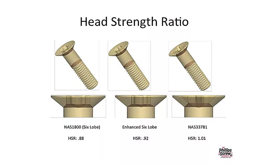

The last factor to consider when analyzing head strength at the head-to-shank juncture is the geometry of the recess drive system itself. Cruciform drive systems like Type 1 (Phillips), NAS33781 (Torq-Set) and Type 1A (Pozidriv) have a defined cruciform shape for most of the recess depth, from the top of the head to the bottom of the recess. In calculating HSR, we typically will ignore this shape and use a basic circular cross section based on the outer wing diameter at the closest intersection to the under-head transition radius for ease of calculation.
Straight-walled drive systems, like six-lobe (Torx) and others, have a constant outer shape from the top of the fastener head to the tapered bottom of the recess. In these cases, the distance from the head transition radius to the closest intersection with the recess shape is still used, except that the nearest intersection is often a circular area in the bottom of the recess, below the plane where the recess outer form has transitioned to a circular cross section.
Fasteners with unthreaded shanks are typically used in higher stress structural applications, and in these situations an HSR of 1 or greater is recommended. Ideally, the maximum recess depth will be shallow enough to provide an HSR greater than 1, especially if the fastener is in an application that is deemed critical or semi-critical. While the configurations in Figure 3 show an HSR below or near 1 at maximum recess depth, if the parts are manufactured with the recess depth closer to the minimum allowed in the part standard, the HSR will increase as the recess depth approaches this minimum limit.

Higher head strength is achieved with protruding head configurations where the bottom of the recess has significant distance from the head-to-shank juncture, as in the Fillister head. (See Figure 4.) Increases in head strength can also be achieved in thin-head designs if a shallow recess can be used, such as AS6305 MORTORQ spiral drive or NAS33750 dovetail slot. (See Figure 5.) However, in a bolt application where significant torque is required, the drive system should have a very high contact area between the driver and recess to accommodate the high torque required to achieve the needed clamp load.
