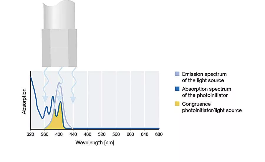

The lamp’s wavelength must match the adhesive’s absorption spectrum. Illustration courtesy DELO Industrial Adhesives

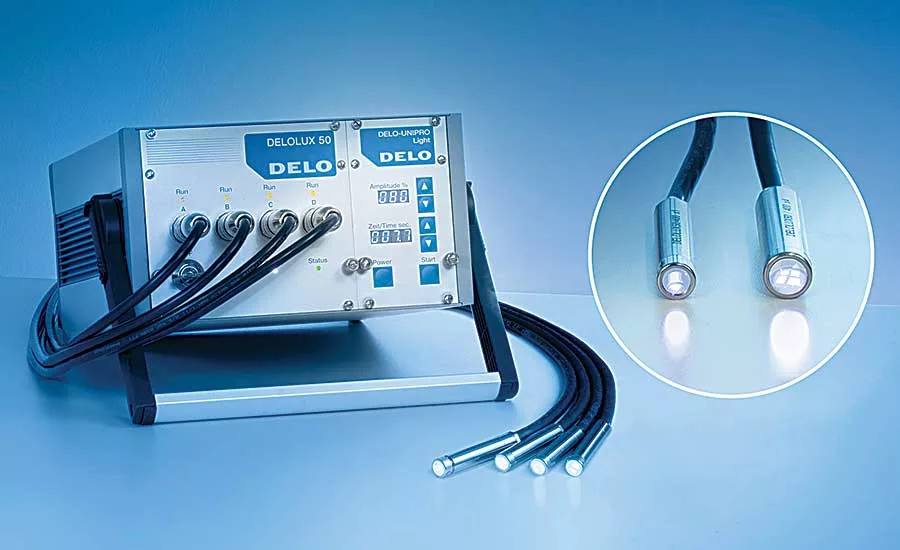

DELOLUX 50 spot lamps allow spot sizes of 1 to 10 millimeters in diameter and intensities of up to 12,000 milliwatts per square centimeter. Photo courtesy DELO Industrial Adhesives

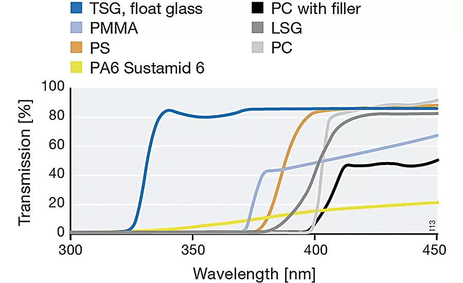

Different materials transmit light of varying wavelengths differently. Illustration courtesy DELO Industrial Adhesives

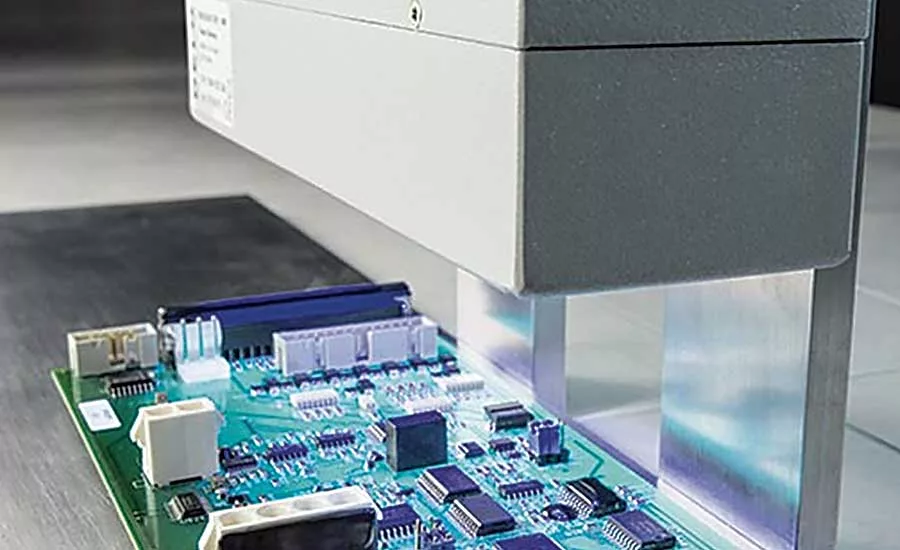

The compact UV area lamps with particularly slim edges provide for homogeneous curing. Photo courtesy DELO Industrial Adhesives

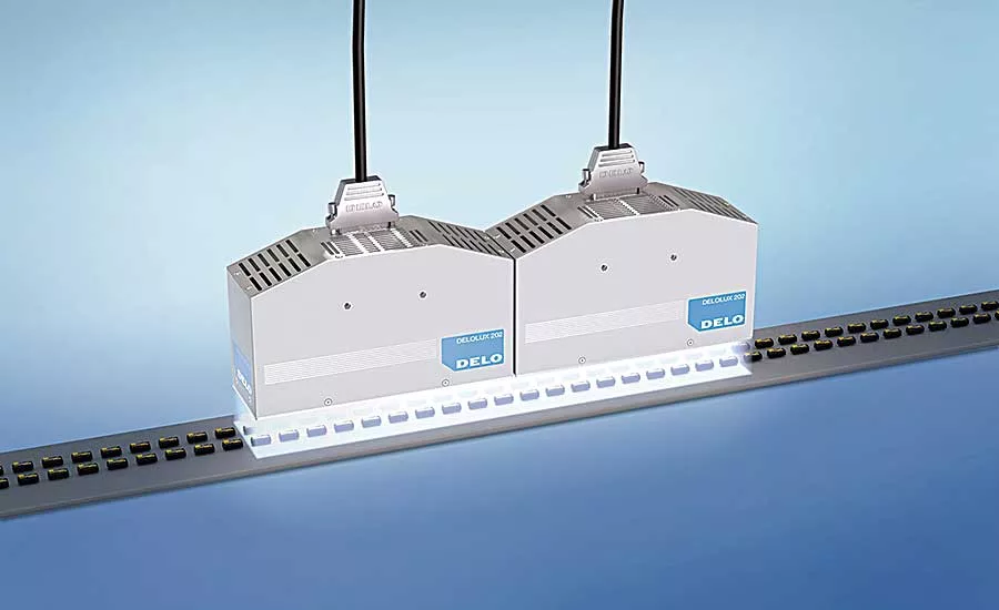

Area lamps enable simultaneous exposure of large surfaces or continuous exposure in long production lines. Photo courtesy DELO Industrial Adhesives

For a light-curing reaction to occur, it is important that the wavelength spectrum of the curing lamp overlaps the absorption spectrum of the photoinitiator.
Depending on the chemical compound, photoinitiators have a typical absorption spectrum that ends at 370 to 480 nanometers. To prevent uncontrolled or inadvertent curing, the absorption spectra are usually chosen so that daylight cannot cure the adhesive. If by chance the adhesive comes in contact with daylight, it is engineered to cure very slowly. To match the absorption spectra of the adhesives, LED curing lamps emit light with a wavelength of 365, 400 or 460 nanometers.

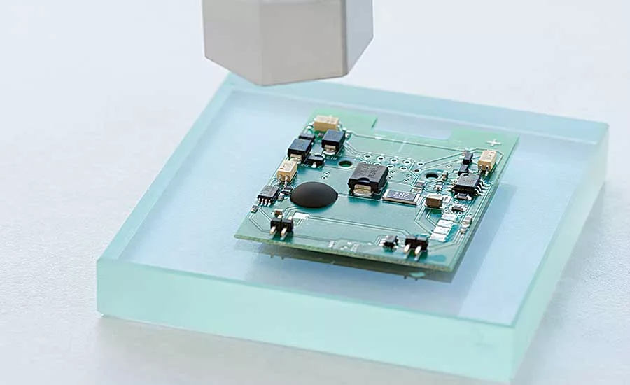

The materials to be bonded are another consideration. To ensure that light energy reaches the adhesive, at least one of the components to be bonded must be translucent within the adhesive’s absorption range.
An example of this would be displays of smartphones or tablets. These devices are usually provided with a clear cover for protection. These protective display covers can be made of glass or a plastic, such as polymethyl methacrylate (PMMA) or polycarbonate. While glass is translucent to light starting at a wavelength of 325 nanometers, PMMA and polycarbonate actually block the light completely in this wavelength range. With polycarbonate, for example, light transmission is only possible from a wavelength of 400 nanometers. Therefore, if a UV light source with a wavelength of 365 nanometers was used to cure adhesive to bond polycarbonate parts, no polymerization would take place, because the light would not reach the adhesive.
As a result, engineers need to know the component’s transmission spectrum to select the ideal LED lamp. This can be measured with a spectrometer.

Area lamps enable simultaneous exposure of large surfaces or continuous exposure in long production lines. When designing production lines, it is advisable to provide for area lamps that can be arrayed modularly in different ways without creating shadows, which can occur if the housing is larger than the exposed area.
The goal should always be to expose the entire surface to be bonded with the same intensity. When large areas are exposed, it’s crucial to ensure stress-free curing of the adhesive to prevent warpage. Only a homogeneous exposure can ensure that the adhesive cures evenly and completely in all areas and achieves the properties required for the application.
Lower-quality lamps often have an inhomogeneous exposure profile due to cheap optics and LEDs, so that light intensity at the center of the bulb is high, but drops off at the edges. The consequences are poor adhesive properties or even component failure.
Spot lamps are usually chosen when surfaces of only a few square millimeters must be cured. Most spot lamps use focusing optics that can be swapped out by the user. Thus, spot sizes of different diameters and intensities can be realized, depending on what is best suited for the specific application. Spot lamps are usually cooled passively, but some lamps are equipped with a maintenance-free, water-based cooling system.
