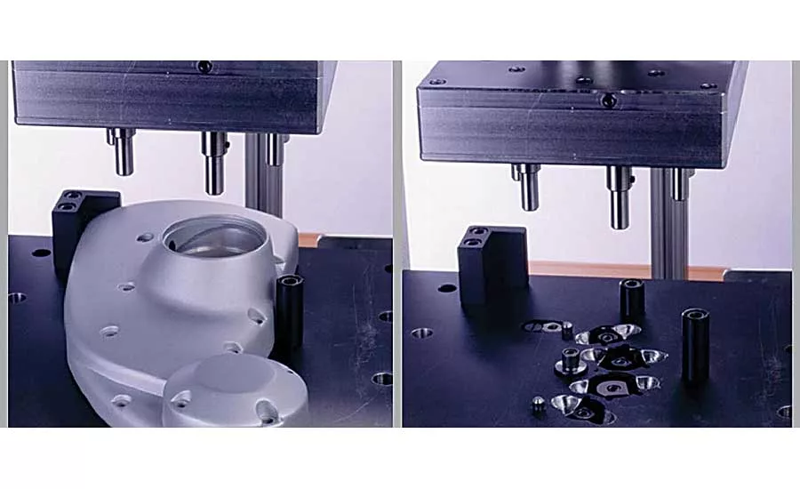

One transmission manufacturer uses a SCHMIDT hydropneumatic press to insert five bushings into a transmission side cover. All the bushings must be pressed flush, regardless of their dimensional tolerances. Photo courtesy SCHMIDT Technology Corp.

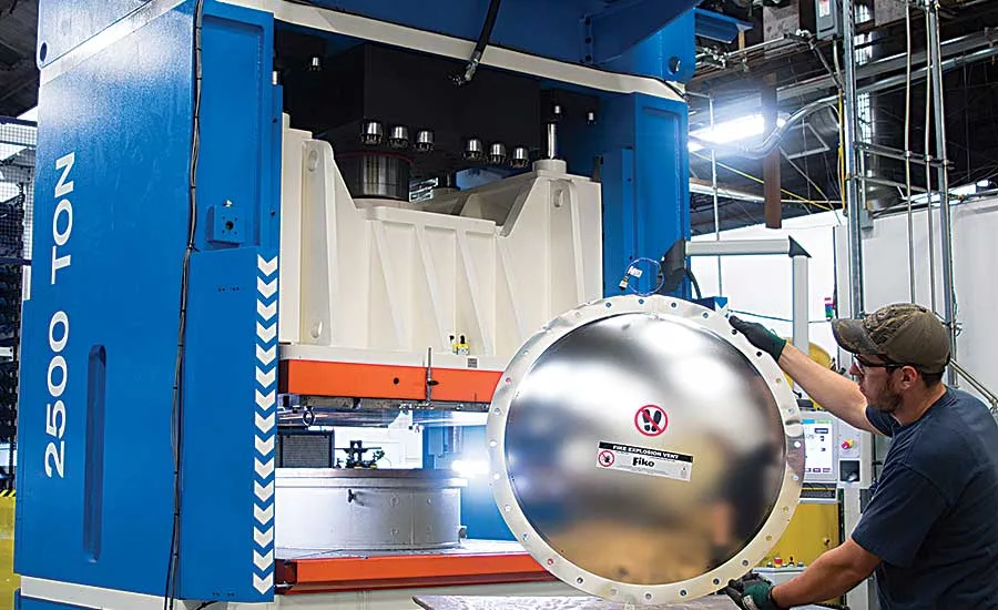

One regular user of a high-force Beckwood press is Fike Corp., a global supplier of fire protection, pressure relief, over-pressure protection and pressure activation devices. Fike currently runs five Beckwood machines, including a 2,500-ton gib-guided press that holds an American Society of Mechanical Engineers third-party test lab certification. Stainless steel is the most common material used for these products, but Fike also uses other high-performance alloys based on performance needs such as corrosion resistance, cycle life and temperature.
Because Fike’s products are used for life safety, they require high accuracy and precision. The company likes that pressure and force accuracy on the 2,500-ton press can be controlled within ±1 percent, and position can be controlled within ±0.002 inch.

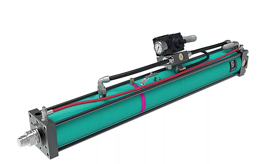

Manufacturers in many industries use presses equipped with hydropneumatic HyperCyl cylinders from Aries Engineering Inc. Available in six series, these self-contained cylinders generate up to 200 tons of output force using 100-psi shop air. The 200-ton cylinder features a 12-inch bore ID and 1-inch thick walls.
The cylinders run cleanly and quietly, and feature seals rated for 20 million cycles before recommended replacement. Cylinder speed is up to 12 inches per second fast approach, and 2 inches per second under high pressure. Force distance monitoring is performed by the IntelliCyl system featuring a linear transducer and load cell.

One automotive customer application involves using a HyperCyl cylinder in a 10-ten press to insert two bushings into an aluminum housing. After the ram installs bushing one, the ram retracts and the upper tooling receives bushing two, which is then inserted in the same manner. Each bushing is inserted separately to obtain individual force and distance data that can be used for traceability.
If either bushing fails insertion inspection, the housing is automatically ejected to a scrap bin. If both bushings pass automated inspection, however, the housing is moved into the laser etching station to be dated and serialized. It is then brought back to the bushing-installation station for manual removal. Total cycle time is 24 seconds.
