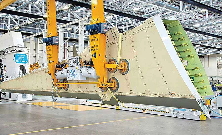

Adhesives are widely used throughout an aircraft. Jet engines contain structural adhesives, threadlockers, retaining compounds and thread sealants for hydraulic components. In the interior, epoxies, silicones and polyurethane foams are used to install floor lighting, assemble overhead bins and seat trays, and fill voids and seal the edges of honeycomb panels and carbon-fiber composite parts. In exterior applications, adhesives are used to bond stringers to wing skins and to seal doors, windows and fuselage components.

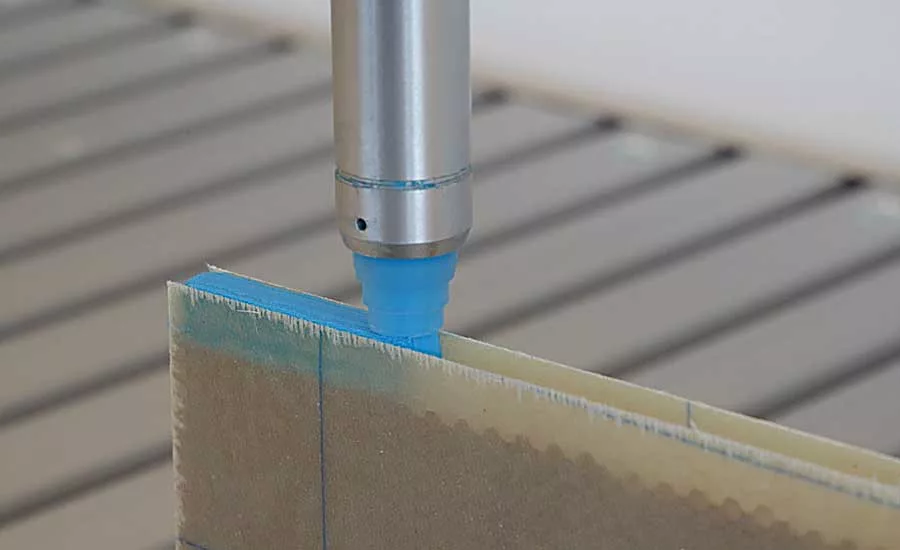

A common application for automated dispensing in aerospace is sealing the edges of honeycomb panels and components, such as brackets, made carbon-fiber composites.
For structural integrity, wherever a honeycomb panel is cut, the cut edges must be filled in with material. Similarly, the cut or milled edges of molded carbon-fiber composites must also be sealed, to keep the component from absorbing moisture.
“These are sheets of laminated carbon fiber,” says David Macphail, business development manager for JR Automation, a systems integrator. “Imagine a stack of loose paper: The edges are frayed. So, you dispense an epoxy to seal the ends of the carbon fibers.”
A filled, two-component epoxy is typically used for the job, though honeycomb panels will have larger voids to fill than composite parts.
“These epoxies are low-density materials,” explains Volcansek. “If water has a specific gravity of 1, these materials have a specific gravity of 0.6 to 0.9.”
To reduce weight and density, the epoxies are typically filled with glass or polymeric microspheres. “These materials behave almost like marshmallow. They are light and fluffy,” observes Kyle Brown, aerospace systems development manager for North America at ViscoTec-America Inc.
Preserving that airiness requires special dispensing equipment. For example, fluid passageways must be optimized to prevent crushing the spheres.

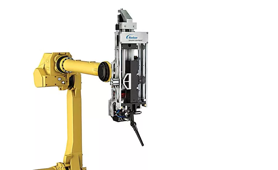

Nordson Sealant Equipment overcomes that problem with a rod-based positive displacement system. The fluid chambers for the resin and catalyst are equipped with steel rods. With each dispensing cycle, the rods extend into each chamber, displacing the exact amount of material needed.
“Those components don’t wear easily, so they last a long time and the mix ratio stays stable,” adds Volcansek. “For aerospace materials, we often use two servomotors to drive the rods—one for each side. That way, you can make speed adjustments, if necessary. For example, you could dispense part A more quickly than part B.”

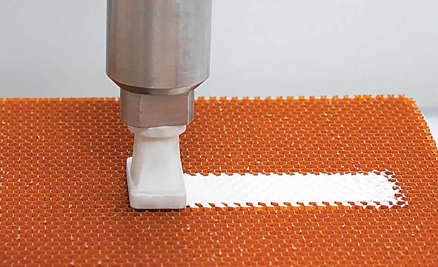

Since honeycomb panels are mostly air, threaded fasteners are not an option for attaching things like shelves, bins or brackets—unless parts of the honeycomb are filled with a lightweight epoxy first.
“It’s a little like potting electronics,” says Volcansek. “You don’t want to trap any air, and you want to adjust the speed of the dispense process to properly fill the cavities.”
Another common automated application in aerospace is dispensing sealant onto adjoining parts. “One application is called a face seal, where you have overlapping pieces of sheet metal and you want to seal the joint line,” says Macphail. “Another is called a filet seal, where you’re sealing the joint line between a vertical part and a horizontal part.
“Both can done with a robot and a servo-actuated mechanism that pumps the sealant out of a cartridge. We use laser-guided vision to ensure the bead stays on the seam.”
