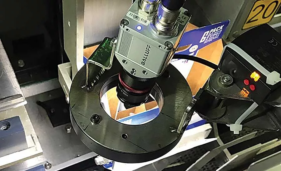

Camera-based vision systems are used in many industries. Here, a camera with a ring light performs inspection on a carton making machine. Photo courtesy Balluff Inc.

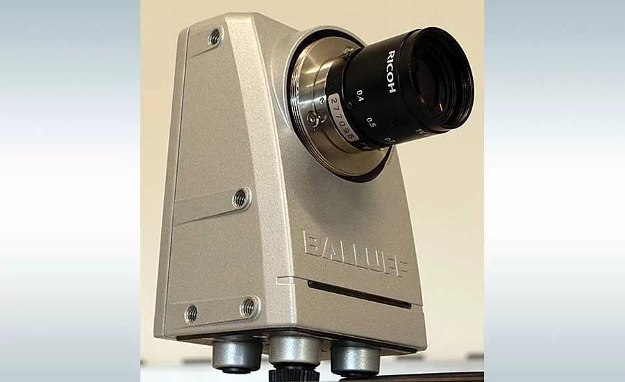

The BVS SC SmartCamera accurately detects machine codes, text or serial numbers, and assists robots in position finding. Photo courtesy Balluff Inc.

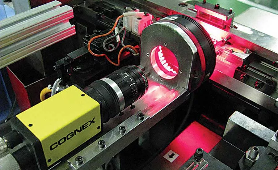

In this application, a smart camera makes sure that electronics connectors are within tolerance. Photo courtesy Cognex Corp.

Balluff’s BVS SC SmartCamera makes it possible to detect production defects in the manufacturing process early on and assures quality control of objects. It detects machine codes, text or serial numbers and assists robots in position finding. Easily set up with common Web browsers, the camera generates inspection programs and passes inspection results to the controller or file servers.
Manufacturers can incorporate the camera in a vision system using digital I/O, standard LAN, Profinet or Ethernet/IP. The quantity and format of acquired data can be adapted, and mass data kept out of the process network. Additional sensors can be integrated into the system via an IO-Link master interface.
