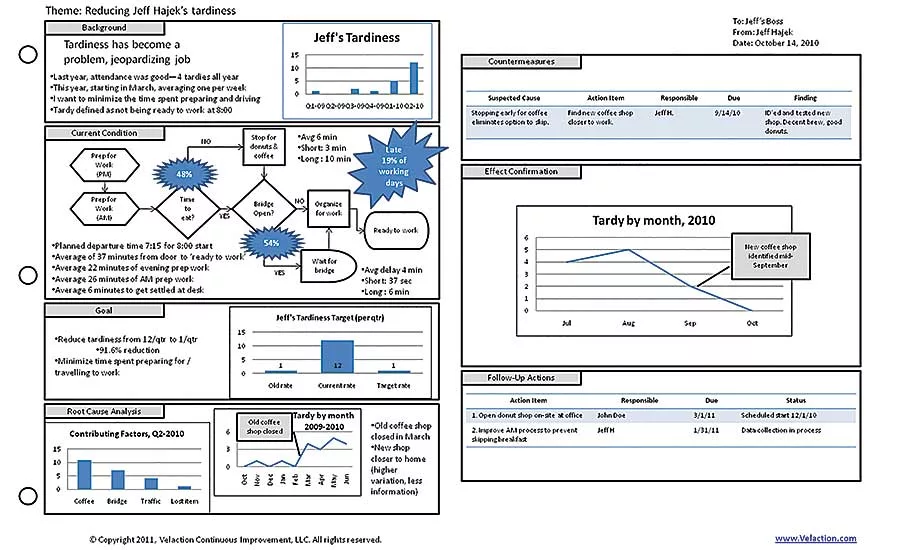

The A3 approach encourages engineers to create graphical representations of the problem and the corrective actions. Graphic courtesy Velaction Continuous Improvement LLC

The A3 approach is named after the paper size that is used for the root-cause analysis and corrective action. A3 does the same thing as 8D; it provides guidance for solving a problem and a method for communicating the actions taken and results to the team. The A3 approach encourages engineers to create graphical representations of the problem and the corrective actions.
Experience suggests either approach works well. Personally, I have a mild preference for the A3, because it is possible to diagram the root cause graphically in a predefined space on the form. Graphical representations of a situation can be more quickly and easily understood compared with an abundance of words.
