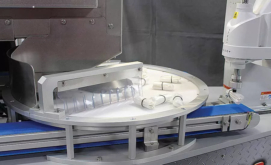

Flexible feeders are regularly used by manufacturers in the medical industry. Here, a robot lifts and moves a rolled bag, which is part of a medical specimen test kit. PHOTO COURTESY PERFORMANCE FEEDERS INC.

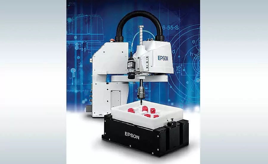

Epson Robots brought the IntelliFlex system to market in 2019 after using other internal feeding solutions in-house on assembly lines that build everything from printers to robots. PHOTO COURTESY EPSON ROBOTS

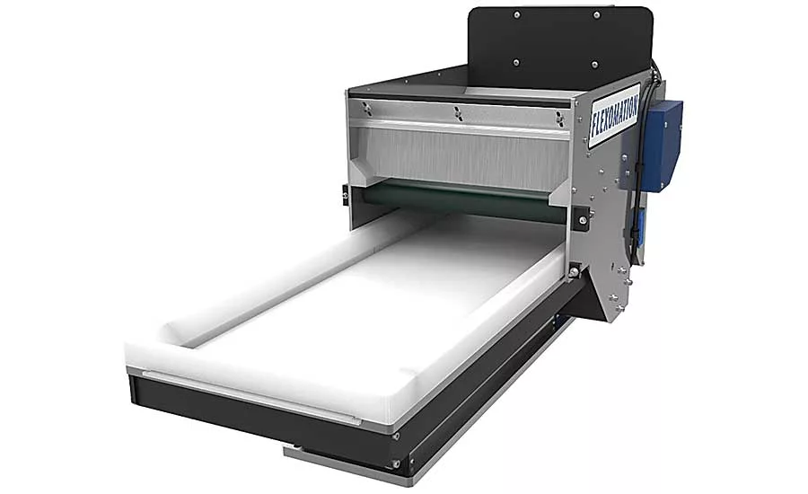

FXM flexible feeders allow backlighting to enhance camera vision. The model 240 (shown) is also available with a Conveyor PreFeeder for feeding bolts. PHOTO COURTESY FLEXOMATION LLC

Last year, Epson Robots brought the IntelliFlex system to market after using other internal feeding solutions in-house on assembly lines for everything from printers to robots. The system was sold first in North America and Mexico, and then throughout Europe. This summer it will be introduced to the Southeast Asia market.
“Some of our end-users are quite experienced with flexible feeding systems, but others are not,” notes Rick Brookshire, director of product development at Epson Robots. “One first-time user of flexible feeders, in fact, is a medium-sized medical device company that presented us with quite a challenging application in 2019.”
The company needed the IntelliFlex system to feed a large number of metal pieces, each of which measures 1 inch long by 0.125-inch wide and has a notch on the top side. After being placed in the feeder, some parts came out right side up on the feeder tray while others were upside down.
“When we saw that the SCARA robot was gripping parts improperly, we investigated why,” explains Brookshire. “It turned out that we had to mount the camera higher above the feeder so the camera would be out of the path of the robot motion. In doing so, the resolution of the camera  field of view to see parts on the feeder was too low to recognize if the parts were right side up or upside down.”
To overcome this problem, a second, higher-resolution camera was mounted on the top of the robot’s end-of-arm tooling. Now, after the overview camera takes an image of all visible parts, the robot arm makes a follow-up pass over the tray and the mobile camera takes an image of each part. This complementary camera setup does extend cycle time a bit, but it ensures that the robot always grabs the part in the most efficient manner before moving it to the next workstation.

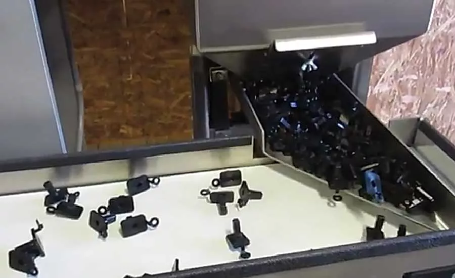

Lewis recalls an application where one medical tool manufacturer simultaneously fed four parts in the Flexomation FXM-100 feeder to quicken assembly of a small medical clamp. The four parts were a spring, a clip and two small injection-molded jaws.
Flexomation’s FXM series includes the 100, 180, 240 and 300 models, with the number indicating the millimeter width of the feed surface for the parts. All four models allow backlighting to enhance camera vision, and are available with a Conveyor PreFeeder (CPF). Other parts fed with these units are metal brackets, and cylindrical, flat and thin, and small, oddly shaped parts, such as suture needles, for medical device companies.

The Epson IntelliFlex system feeds 5- to 40-millimeter-wide parts for medical, consumer, automotive and electronics applications. It is easy to set up, and features integrated vision guidance with IntelliFlex software, RC+ development software and a point-and-click interface. Smart auto-tuning automatically adjusts the system for new parts, while multi-axis vibration technology optimizes parts control and singulation. Backlight options include red, green, blue, white and infrared. ESD, anti-static and anti-rolling trays are available.

The PFVF-03 Vari-Flex feeder features a 24-inch rotary table that presents parts for pickup and orientation by a robot. Unselected parts are recirculated to a bulk storage prefeeder. This feeder accommodates various part geometries and part families with its quick-change tooling. It can feed more than 30 ppm, and it can be deployed in a multi-table arrangement sharing a single robot.
A touchscreen display with PLC and remote Intranet access provides easy control and reduces I/O usage. Made from FDA-compliant materials, the feeder is available separately or as a completely integrated system with robot and vision system. A programmable four-color light tower visually displays the system’s operational modes.
