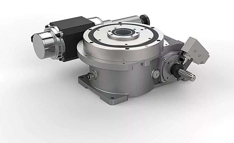

With a rotary table driven by a constant-lead cam and a servomotor, the indexing motion can be changed from 90 degrees to 120 degrees simply by changing the program. A table driven by a fixedstop cam would have to be replaced or rebuilt. Photo courtesy DESTACO

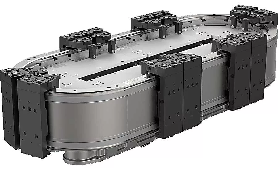

The CAMCO iQue Conveyor’s iTRAK programmable linear drive allows independent control of multiple magnetically propelled movers along straight or curvilinear paths. Movers can be moved along the conveyor in forward or reverse motion at varying speeds, and in individual, continuous, batch and asynchronous motion sequences. Photo courtesy DESTACO

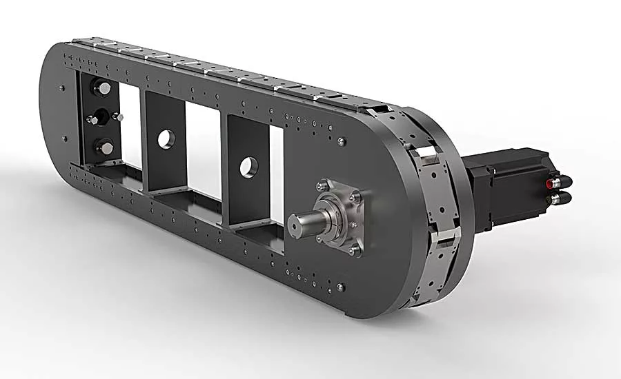

The fixed system, like this cam-driven precision link conveyor, is the best choice if the part must be rigidly held place during processing. Photo courtesy DESTACO

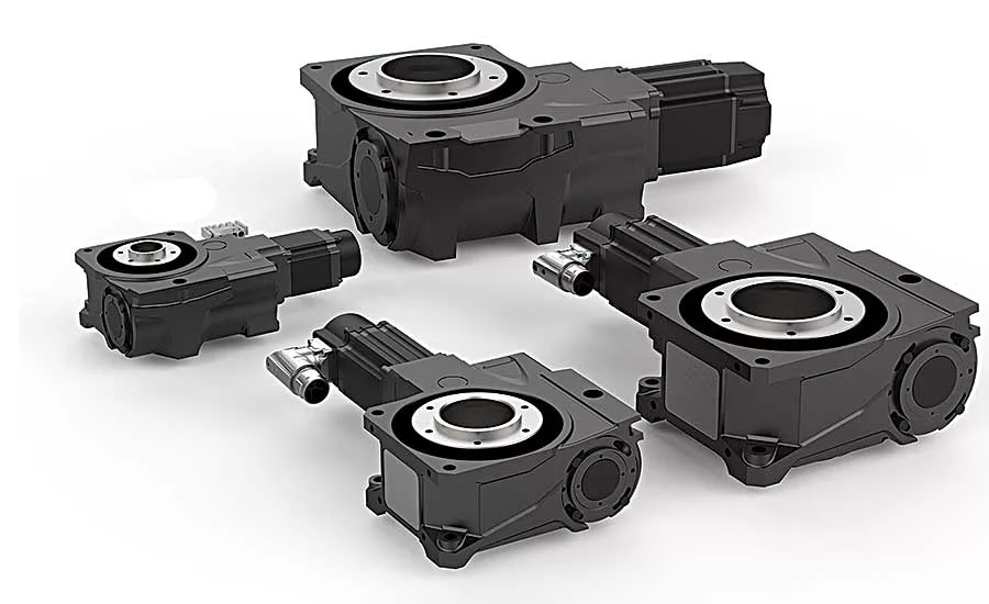

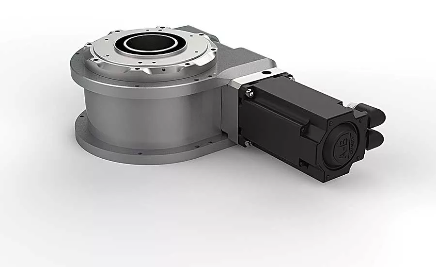

The GTB series of servo-driven rotary indexing tables is available in four center distances: 40, 63, 80 and 100 millimeters. Photo courtesy DESTACO
