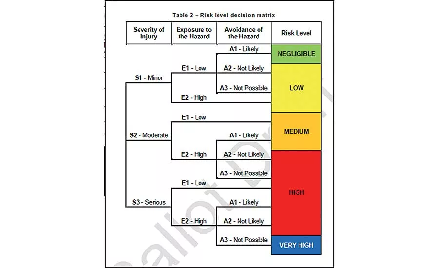

Step 2: Assessing Initial Risk
In order to understand the magnitude of risk for each hazard on the machine, the risk must be quantified. There are three qualities to quantify: Severity of Injury, Frequency of Exposure, and Probability of Avoidance. The 3-2-3 convention (Figure 1) may be used to calculate a risk value that represents the level of risk to personnel before safe guards are considered. This method is recognized in RIA TR R15.306 Table 2 as an accepted way to quantify risk.

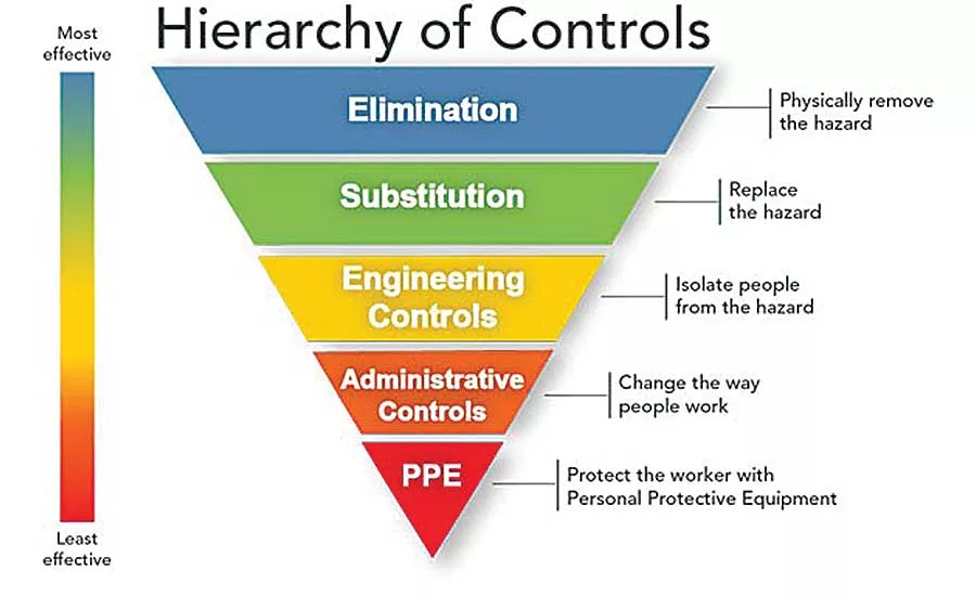

Step 3: Risk Reduction
After all machine hazards have been appropriately identified and quantified, risk reduction measures should be taken. Not all risk reduction measures are made equal, however. The hierarchy of hazard mitigation, also called the hierarchy of controls, organizes mitigation principles by effectiveness. This cornerstone of risk reduction is seen in some capacity in both ISO 12100 and ANSI B11.0 standards.
Consider a pinch point that exists between a moving palate and weldment in the initial design. If the designer systematically moves through his design and catches the pinch point before the machine is released, he may choose to move the weldment backseveral inches, eliminating the hazard all together. Consider a second example: If laser marking is an operation of the machine, the operator may be given a hood that protects him from harm, but what is in place to ensure he is wearing it? What about bystanders? Instead, it is safer for the PLC to not allow the laser to begin marking until the safety doors have been shut (interlock switches have been met).
