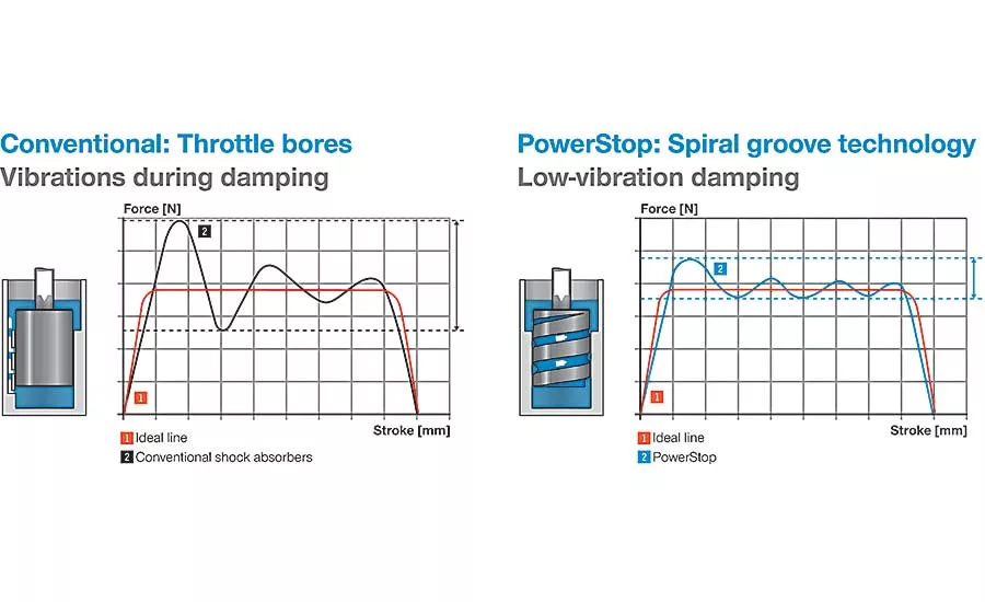

Figure 1 – Conventional Throttle bores vs. Spiral groove method

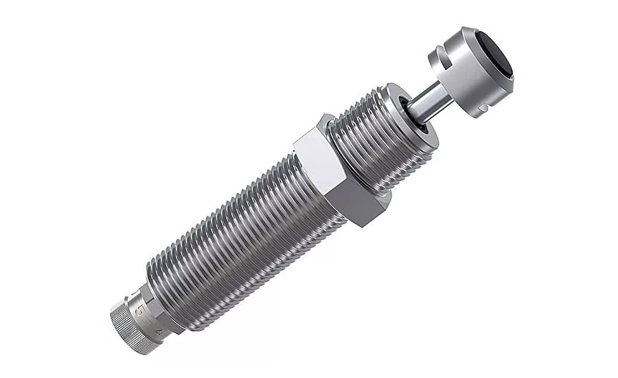

Adjustable Shock Absorber PowerStop 2.0

Most industrial shock absorbers are hydraulic cylinders with a piston assembly. When a load is put on the cylinder’s piston rod, the piston pressurizes the fluid and force it to travel past the piston via some sort of restricted path. These pathways act as throttles, slowing the fluid’s movement, and in turn decelerate the load. The fluid also heats up due to its viscosity, converting the load’s kinetic energy to heat and transferring that out of the shock through its body.
The most common shock absorber uses a series of restricting orifices or throttle bores to provide a pathway for the fluid. Depending on piston position and stroke of the piston, different amounts of throttle bores will be active. A problem with this is that the damping curve can be inconsistent through the stroke range. Additionally, the throttle bore method can introduce vibrations and excess heat as each throttle bore become active. Excess heat can cause the fluid to lose its viscosity and reduce its damping effectiveness.
A more refined method of moving the fluid past the piston is the use of a continuous, consistent pathway such as the decreasing diameter spiral groove machined into the piston on Zimmer Group’s new PowerStop 2.0 shock absorbers. The spiral groove ensures consistent damping rate throughout the stroke of the shock, whether just a few millimeters into the movement, or near the end. This also reduces vibrations, and keeps the fluid cooler, allowing it to absorb more energy over time and extend its lifespan.

If the shock absorber will be subjected to a wide range of impact speeds, an adjustable shock absorber may be needed.
