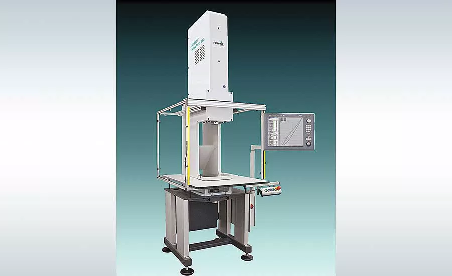

ServoPress Systems for the Most Demanding Applications
For the most complex pressing requirements, our ServoPress Systems are the perfect choice. Integrated into our ServoPress Systems are: an electro-mechanical motor, a precision ball or planetary roller screw spindle, a load cell and PDA for force feedback, and a resolver for tracking the ram stroke position. Our ServoPress Systems provide not only true closed-loop position control but also true closed-loop force control. They are available as either a modular unit or as a manual workcell.

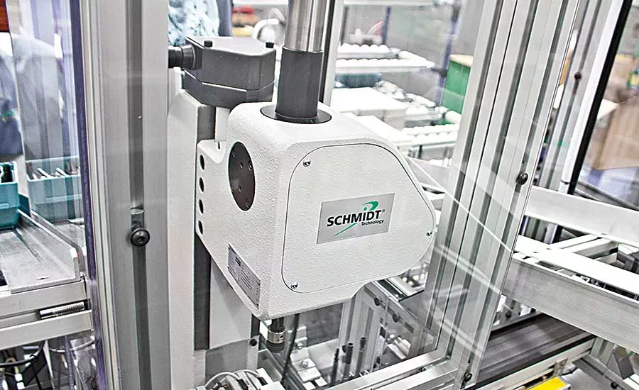

ElectricPresses for Cost-Effective Servo Control
ElectricPresses with forces up to 2,250 lbs., with or without process monitoring, were introduced to bridge the technology gap between a standard air press and a servo press system. Air-operated presses frequently require mechanical devices to compensate for incoming air pressure variations, and they are often prohibited inside clean rooms. An energy-efficient ElectricPress is an excellent alternative to an air press. Because of their innovative rack & pinion drive system, ElectricPresses are more cost effective than ball-screw-driven servo presses, yet they provide the same level of programmable control.
ElectricPress Automation Models, designed specifically for integration into automated production lines, allow builders or integrators to supply their own control and safety systems. Our more advanced ElectricPresses, equipped with the PressControl 600 and an integrated load cell, can manage all ram motion via true closed loop position and force control while applying their process monitoring capabilities. We also provide our ElectricPress Systems for more simple workcells with safety packages.
