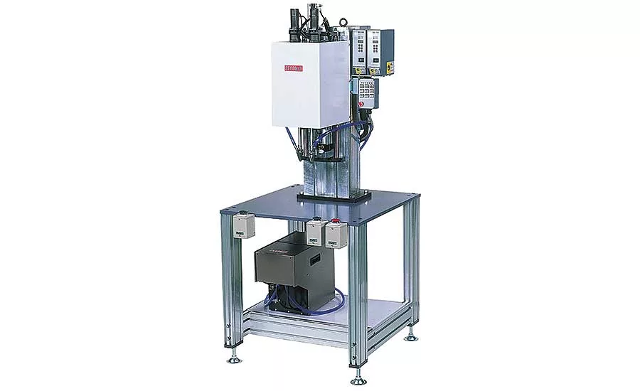

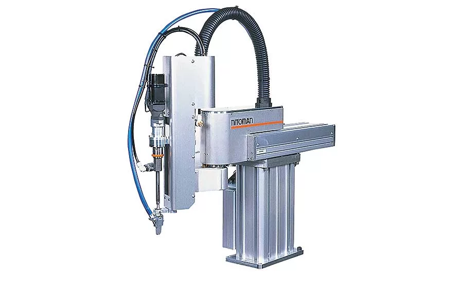

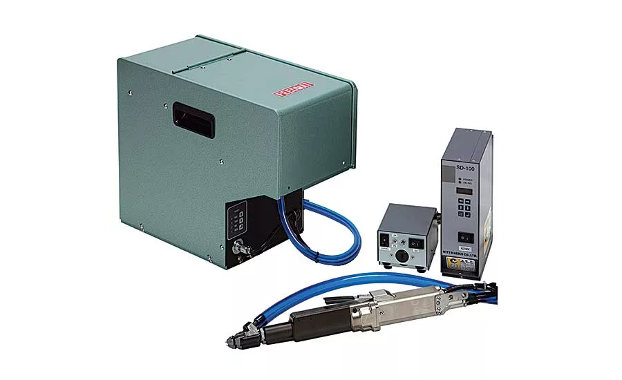

The first question to ask yourself is “Why do I want to automate this process?” The answer will steer you towards the equipment you will need. If you are looking for ergonomic benefits, you may just need a self-fed handheld driver. If you are looking to remove an operator from the process, a single spindle or robot might be your answer. If speed is the concern, a multi-spindle driver would deliver the highest rates. If you are looking for flexibility for many different products or models, a robot is your best bet. All of these can be coupled with a motor, from a pneumatic, up to an AC Servo motor with a transducer and waveform analysis, to match the level of quality needed.
Next comes the fastener. There are two ways to handle the fastener in automated fastening. First is blow feeding, second is pick and drive. Blow feeding the screw is always desired, if possible. Blow feeding is fast and the feed time can be buried by various methods, such as a high-speed chuck that allows you to feed while you are driving. For pick and drive, seconds are added to each cycle in order to move to the feeder, pick the screw, return and drive.

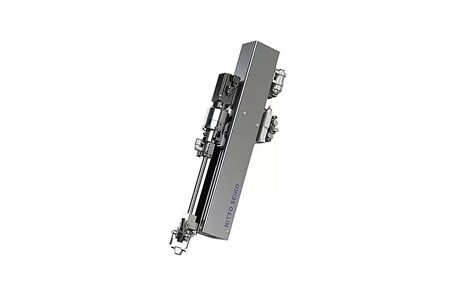

The geometry of the part is going to determine the type of spindle, chuck, stroke and options needed. If all the screws are in one plane, a pneuatic axis should be sufficient. If they are in multiple planes, you will need a servo axis for programmable heights. If there are no obstructions near the screw, then a chuck-style driver may be best. Chuck style drivers need clearance around the hole for the chucks to open up. If there are obstructions, a vacuum driver is best. With a vacuum driver, the chuck is stationary and a vacuum tube sucks the screw to the bit, then advances through the chucks to the part. This type only needs a clearance 1mm greater then the head diameter of the screw, allowing access to tight spaces and deep recesses.
Stroke is next. You want to be as close as possible to the part to decrease cycle time, but you also need to move around the part safely. Calculate the distance between the lowest screw and highest feature. Thie driver will be as close as possibly, with no crash conditions.
