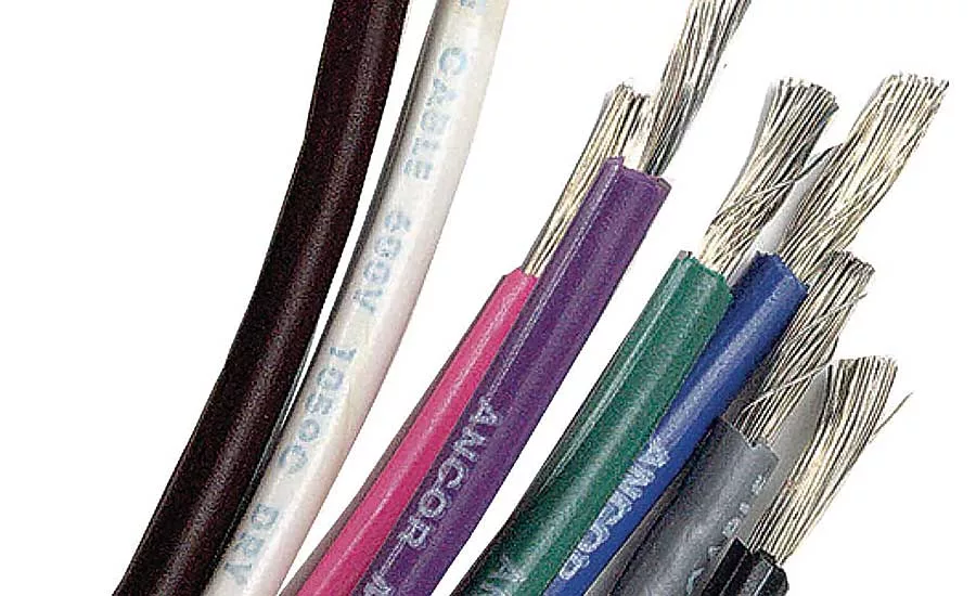

Tinned wire ends are silver in color, and smooth and uniform in appearance

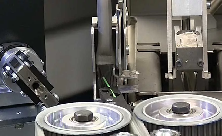

The Schleuniger STS 1100 fluxing-tinning module can be used with the STW 1100 strand-twisting machine (left). The green wire is shown in the flux station.

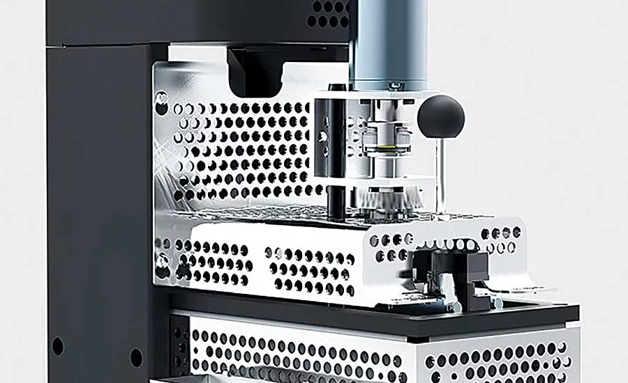

Introduced in 2017, the X1585 fluxing-tinning module offers versatile lead-free tinning of strand ends.

Tinning wire is an essential part of soldering preparation. When done properly, it improves the operating temperature range, water resistance and mechanical strength of bare copper wire. It also prevents conductor strands from fraying when connecting a stripped wire to a termination site.
Manual tinning is a simple three-step process. After gently twisting together all the conductor strands, the worker apples a thin layer of flux to the strands and then a thin layer of solder compound.
This compound contains tin-lead or is lead-free (tin-silver-copper) and may be applied by dipping the wire end in a heated solder pot (700 to 800 F) or using spooled solder wire in conjunction with a hot solder iron. After tinning, the treated wire end is silver in color, and smooth and uniform in appearance. It quickly dries and is then soldered in place.

In 2017, Komax introduced the X1585 fluxing-tinning module, which offers versatile lead-free tinning of strand ends. The module comes with a variety of tinning nozzles to cover a broad spectrum of applications. Each nozzle can be disassembled during operation.
The fluxing station is compact and integrated as standard, while the solder container is easily accessible on any fully automatic wire processing machine. According to Moeri, the X1585 functions best when combined with the company’s X1582 strand-twisting module. He says that twisted strand ends increase tinning accuracy.
Schleuniger introduced its first fluxing-tinning module, the STS 1000, in 2006. An upgraded version, the STS 1100, was brought to market in 2012 primarily to help end-users accommodate the ROHS standard that requires the use of lead-free solder for tinning applications. The STS 1100, like its predecessor, allows the operator to program all fluxing and tinning parameters.
According to Boyd, the STS 1100 quickly performs fluxing and tinning of stripped wire ends (stranded conductor or coax) with a cross section up to 14 AWG and a tinning length up to 0.2 inch. Optional equipment enables the module to process up to 12 AWG wire and a tinning length up to 0.39 inch. In addition, this module can be used with the company’s STW 1100 strand-twisting machine.
“The upgraded version lets operators exactly program how fast and how far the stripped wire end goes into and comes out of the flux spout and solder waterfall,” notes Boyd. “The spout and waterfall are mounted side by side, only two inches apart.”
Short cycle time is a key benefit of the STS 1100. Boyd says that 14 or 12 AWG wire can be processed at a speed of 1,200 pieces per hour. Smaller wire can be processed at a speed up to 2,000 pieces per hour. However, the actual rate will depend on the application.
