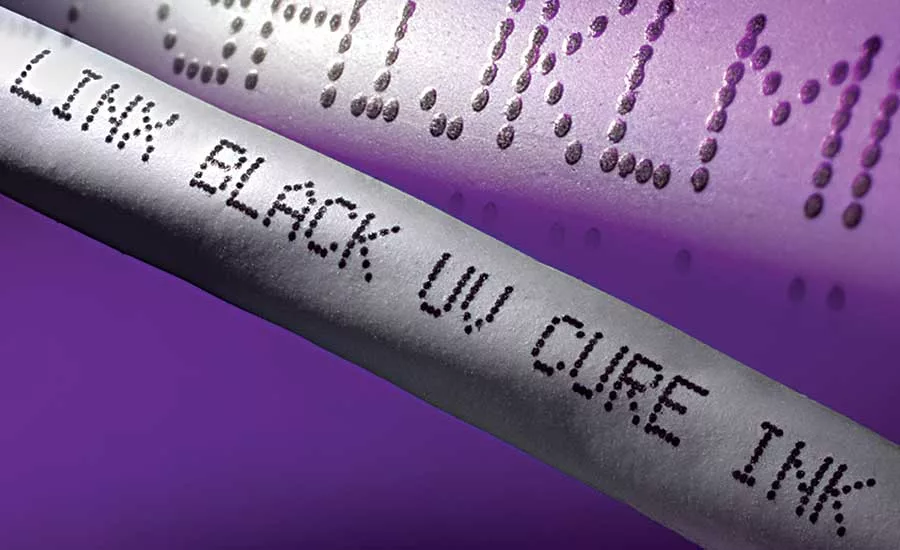

UV-cure inks provide excellent adhesion, light-fastness, and resistance to a range of chemicals. Photo courtesy Linx Printing Technologies Ltd.

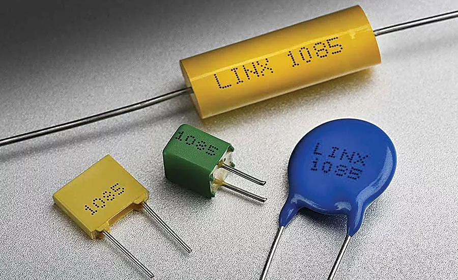

Black ink 1085 is chromium-free and does not contain halogens. It’s also alcohol resistant, so coding can be performed before or after components are given an alcohol wash. Photo courtesy Linx Printing Technologies Ltd.

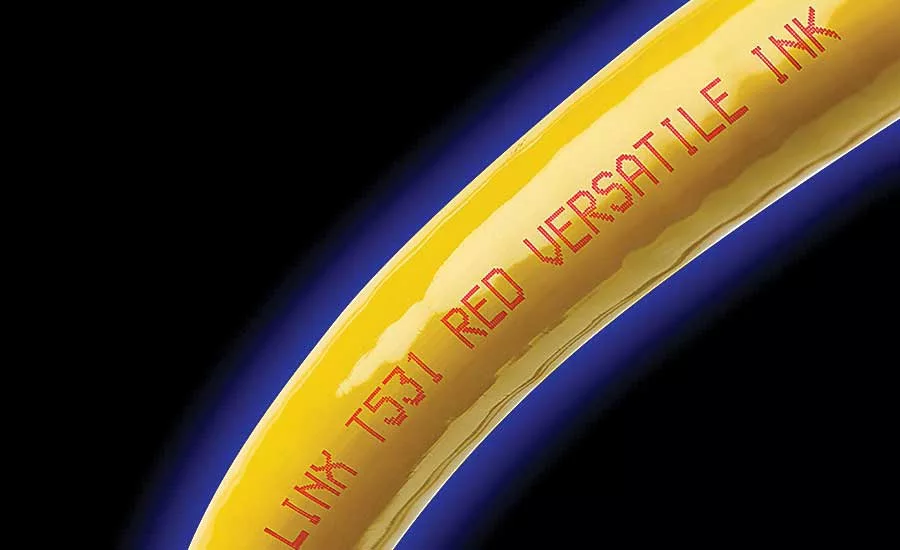

A wide range of inks is available to use with ink-jet printers. Pigmented inks of different colors offer superlative contrast and durability to ensure codes stand out on any color substrate. Additionally, UV-cure inks provide excellent adhesion, light-fastness, and resistance to a range of chemicals—perfect for preventing code transference during production and fading during end-use.

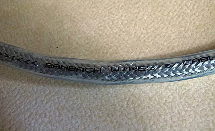

Australian manufacturer Bambach produces wire and cable for a variety of industries, including automotive, heavy equipment, marine, defense, railroad, communication, solar power, and sound and lighting. Established in 1936, the ISO 9001:2008 certified company is headquartered in Brookvale (a suburb of Sydney) and maintains satellite operations in Coopers Plains, Tullamarine, Lambton, Welshpool and Edwardstown.
Because the company makes so many different cables for so many different customers, marking equipment is an essential part of its operation. Cables are printed at varying intervals, from simple number codes a few centimeters apart to long alphanumeric messages at much greater spacing.
Not long ago, the company found that printer downtime and reliability issues were impeding output and product quality. Printer breakdowns sometimes affected the quality of the marks, and rework was not always possible, leading to costly waste.
Bambach needed new printing equipment that promised to reduce downtime, cut waste due to coding errors, and eliminate rework. The new printers would have to:
  • keep up with fast production lines.

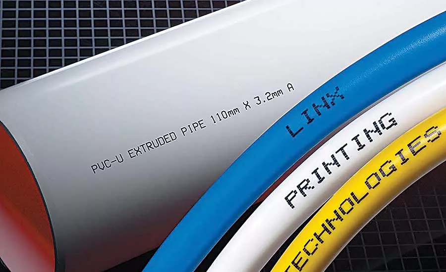

  • print clearly, using black or white ink, onto cables of various colors.
  • accommodate cable diameters from 1 to 30 millimeters.
  • handle a variety of substrates, including PVC, polyurethane and cross-linked polyethylene.
After comparing equipment from different suppliers, Bambach chose the Linx 7900 continuous ink-jet printer for its ease of use, excellent print quality, fast print speed, and ability to print on a wide range of cable sizes.
The Linx 7900 printer sits next to the extrusion line, printing onto cables as they are extruded. Printed information includes product identification marks, company branding, customer information (including logos, if requested), information relating to standards compliance, and serial numbers for traceability.
Michael Ng, operations manager at Bambach, says the new coders have eliminated rework and product wastage, resulting in large savings. The coders’ simple setup has also allowed Bambach to change over lines very quickly, increasing uptime. The coders work 8- to 10-hour shifts, five days a week, at speeds of up to 200 meters per minute.
