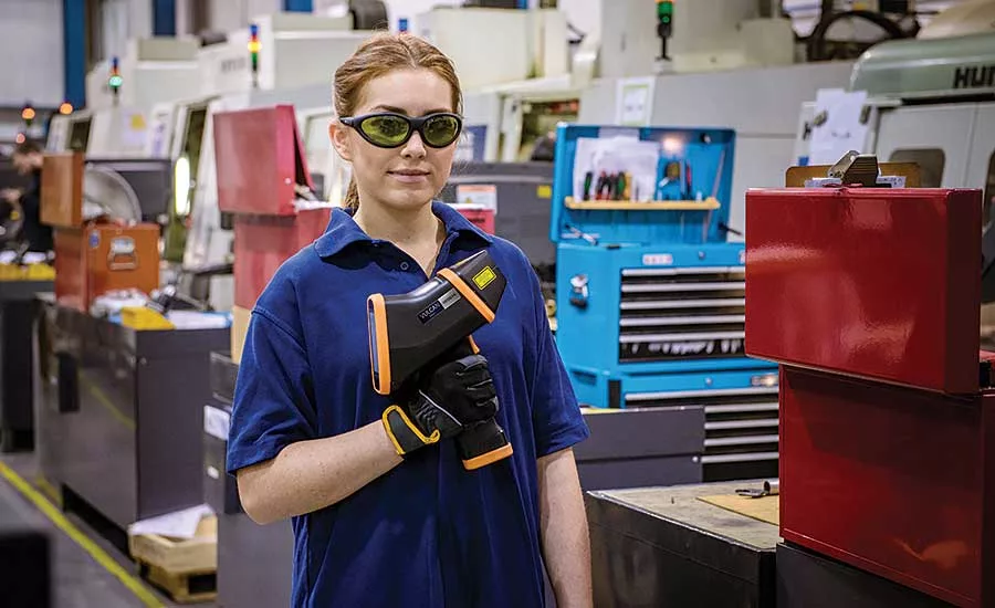

Each company will have its own protocol for testing incoming materials and parts. If, for example, an automotive supplier receives a shipment of 10 coils of aluminum sheet, it will typically check each coil. Photo Courtesy HITACHI HIGH-TECH ANALYTICAL SCIENCE

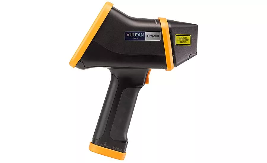

LIBS uses a laser diode to emit a small, powerful laser onto the surface of a sample and dissipate a small amount to form an energized plasma. As the plasma cools, each element in the sample emits a characteristic wavelength, which can be meas-ured using a spectrometer. Photo Courtesy HITACHI HIGH-TECH ANALYTICAL SCIENCE

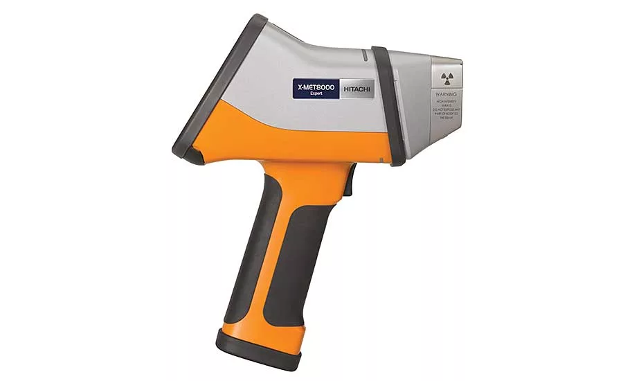

XRF uses X-rays to excite the molecules at the surface of the sample. Atoms in the sample react and generate secondary X-rays, which are collected and processed by a detector. Photo Courtesy HITACHI HIGH-TECH ANALYTICAL SCIENCE

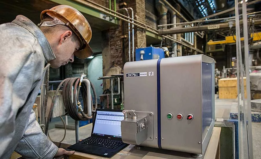

OES devices offer the highest levels of accuracy. They can detect very low levels of all the important alloying elements. Photo Courtesy HITACHI HIGH-TECH ANALYTICAL SCIENCE

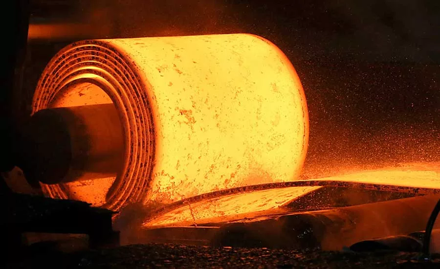

Even slight variations in the amounts of alloying elements can adversely affect the properties of high-strength, lightweight materials. Photo courtesy JSW Steel

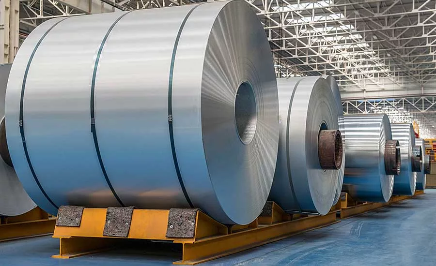

By 2022, the average car is expected to contain around 100 kilograms of aluminum as a replacement for steel. Photo courtesy Yieh Corp.

Aluminum weighs about a third of steel. For example, BMW recently used the metal to more than halve the weight of the tailgate on its 5 Series sedans. By 2022, the average car is expected to contain around 100 kilograms of aluminum as a replacement for steel and other, heavier materials. But, by itself, aluminum can be relatively weak.

OES uses electricity to excite the molecules in a sample and measure the relative proportions of each element. It does this with sparks (a series of multi-discharge events where the voltage of the electrode is switched on and off) or an arc (a single on-off event similar to a lightning strike).
OES devices offer the highest levels of accuracy. They can detect very low levels of all the important alloying elements. While the technique can only be used to test metals, it can measure nonmetallic elements within them. Indeed, it excels at measuring the levels of carbon, boron, phosphorous and nitrogen in steel. For example, the Hitachi High-Tech OE750 has a wavelength range of 119 to 766 nanometers, which covers all elements from hydrogen to uranium for complete metals analysis.
However, OES will leave a burn mark on the sample. It also requires argon gas canisters, unless used with an arc probe.
XRF is an established and well-trusted analytical technology, having been used in benchtop, portable and, more recently, handheld materials analysis for more than 45 years. The technique uses X-rays, which are generated by the source and directed at the sample, to excite the molecules at the surface of the sample. Atoms in the sample react and generate secondary X-rays, which are collected and processed by a detector.
Unlike OES and LIBS, XRF is a nondestructive form of material analysis. It can measure solids, liquids and powders, including coating thickness, which can be critical in several aspects of the automotive sector, as well as in industries like aerospace. XRF analyzers are ideal for accurately determining chemical composition, including identifying trace and tramp elements. Like LIBS, the technique is ideally suited to quality testing of lightweight steels.
However, XRF technology cannot measure all elements, including lithium and boron, which are both used to form aluminum alloys.
The newest and fastest of the three methods, LIBS uses a laser diode to emit a small, powerful laser onto the surface of a sample and dissipate a small amount to form an energized plasma. As the plasma cools, each element in the sample emits energy at a characteristic wavelength which can be measured using a spectrometer. A measurement can be carried as fast as a single second.
Samples can be conductive or nonconductive materials, but the LIBS technique needs a solid surface that is clear of dirt and contaminants. The technology is particularly good for measuring aluminum alloys.
While it is a destructive testing method, LIBS is less destructive than OES. The laser burn is usually considered to be surface roughness rather than a defect in a component.

Each company will have its own protocol for testing incoming materials and parts. If, for example, an automotive supplier receives a shipment of 10 coils of aluminum sheet, it will typically check each coil to ensure the alloy has been produced to specification. Such a routine for purchased material inspection shouldn’t require too much effort. On the other hand, an automotive OEM receiving a shipment of 10,000 stamped metal parts might test only a sample.
