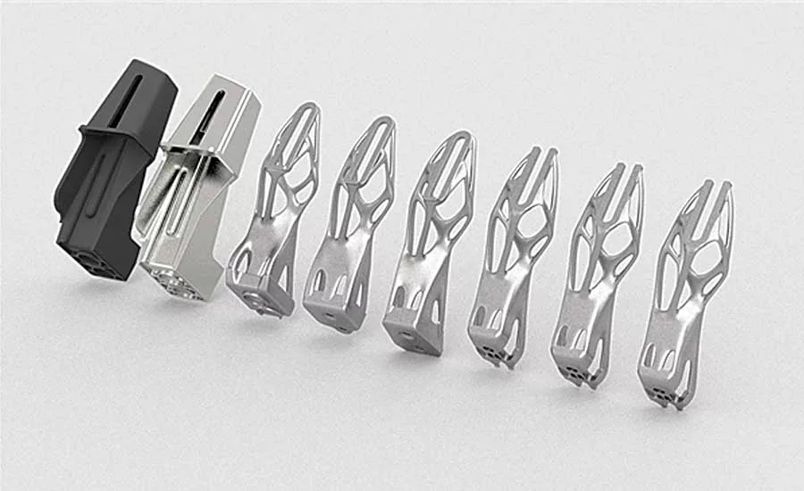

The winner in the Full Vehicle category was General Motors’ 2019 Chevrolet Silverado, which weighs 450 pounds less than its predecessor. BMW Group claimed the Module category with the first 3D-printed metal component used in a production series vehicle. It achieved a 44 percent component weight savings on the 2018 BMW i8 Roadster.

BMW engineers used selective laser melting technology to produce a convertible roof bracket.
“This innovative component marks the first time a metal 3D-printed part has been used in a series production vehicle,” claims Bailo. “Produced without needing any support structures, it was also the first time a topology-optimized design has been translated nearly one-to-one into a series production vehicle to capture a 44 percent weight savings and tenfold stiffness increase.”
“It’s clear that additive manufacturing has huge lightweight potential for vehicle designers when combined with the power of optimization technologies,” adds Maximilian Meixlsperger, head of metal additive manufacturing at BMW. “Getting a 3D-printed part onto a mass-produced vehicle would have been unheard of until very recently. But, with this success, we have an opportunity to make the process part of our standard design and manufacturing approach.”
